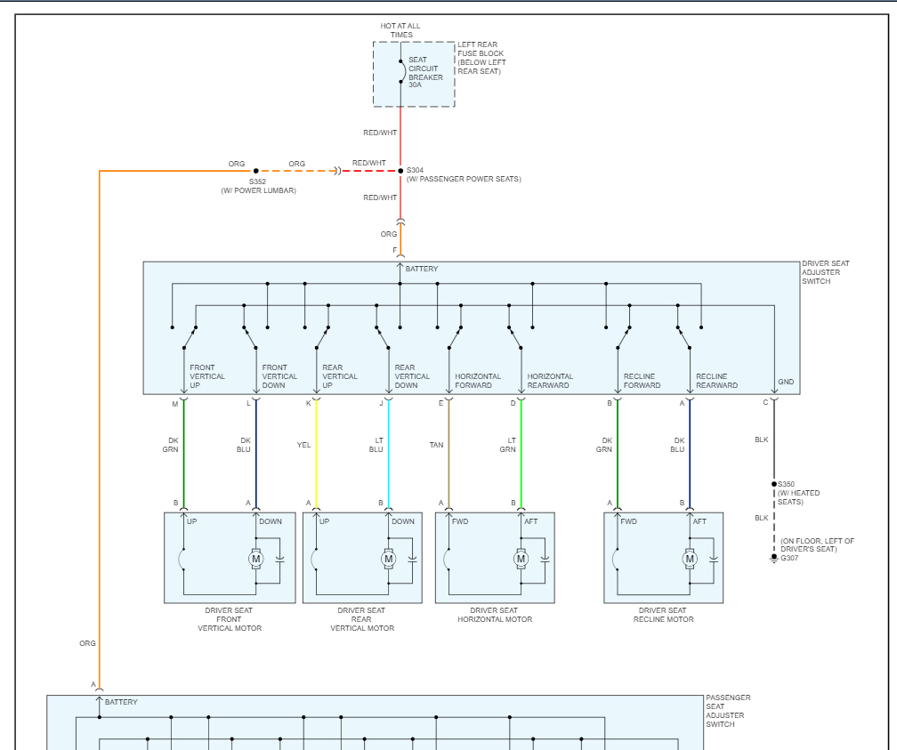

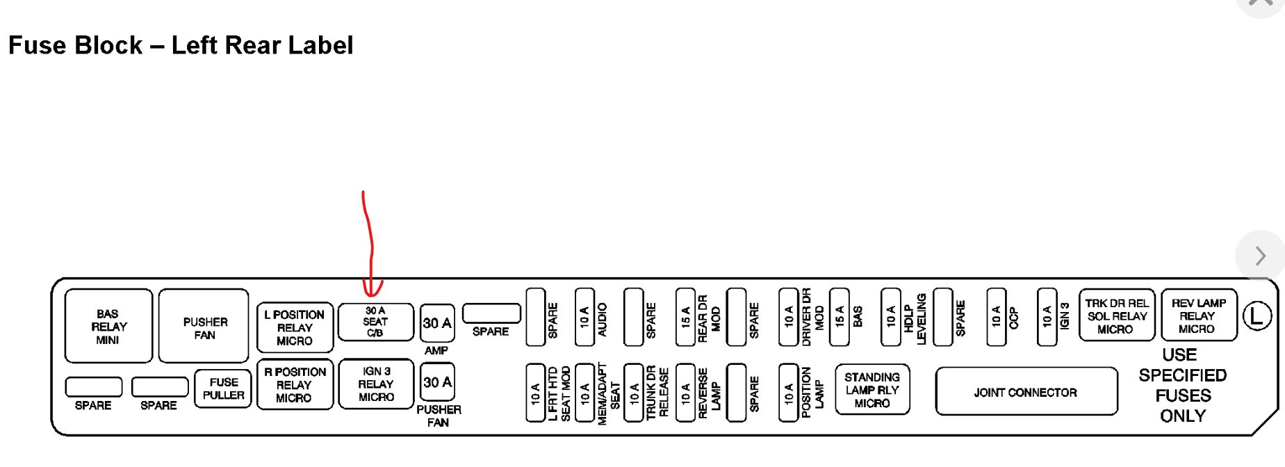

So, all of my fuses are good, but my powered seats won't work. Is there a way i could fix it?
Sep 25, 2023 at 3:09 AM
  • 55,433 POSTS

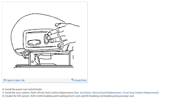

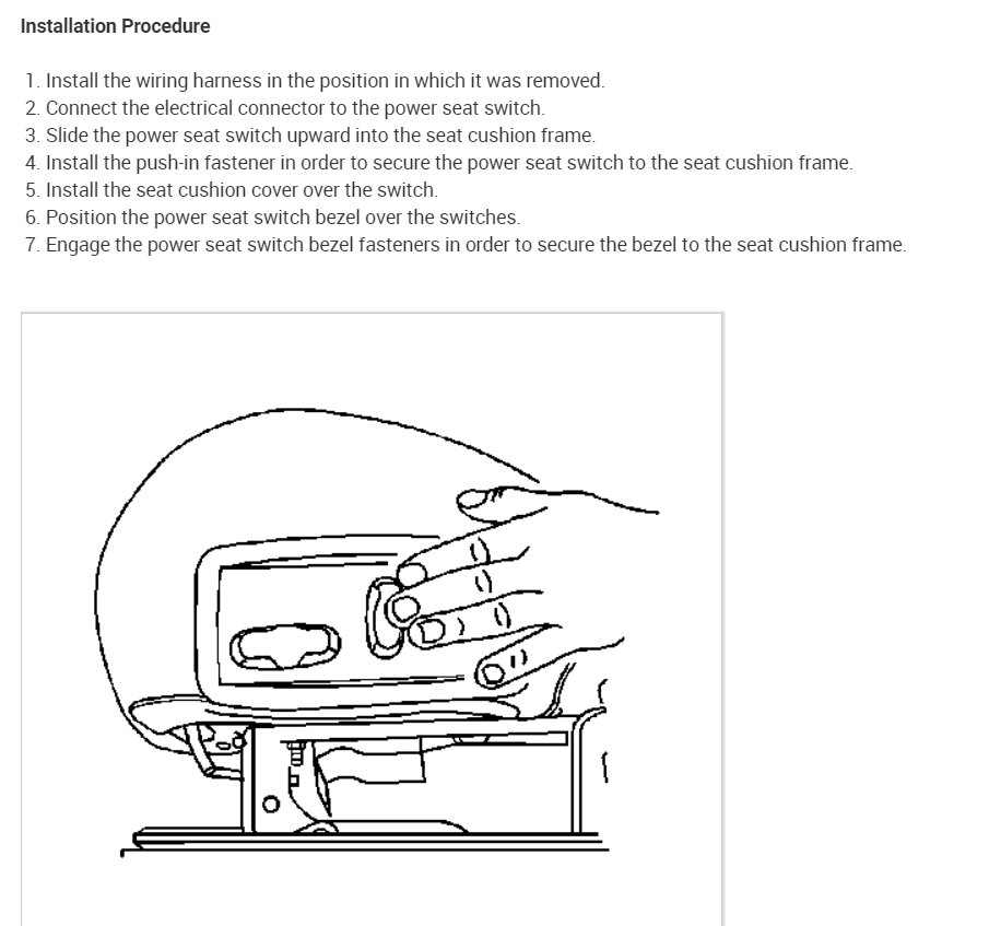

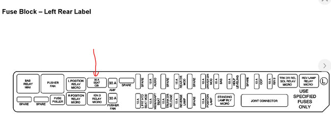

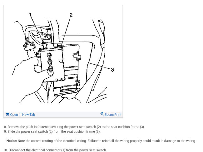

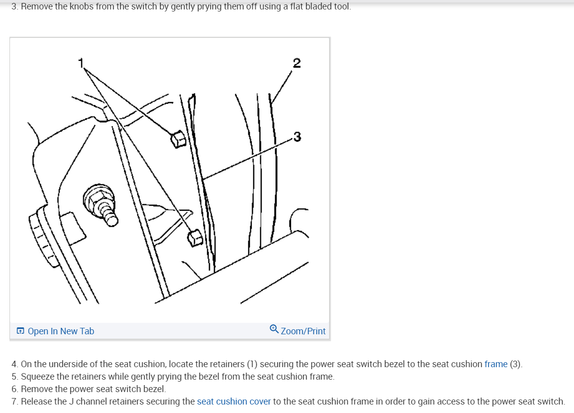

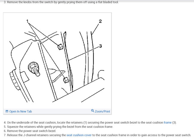

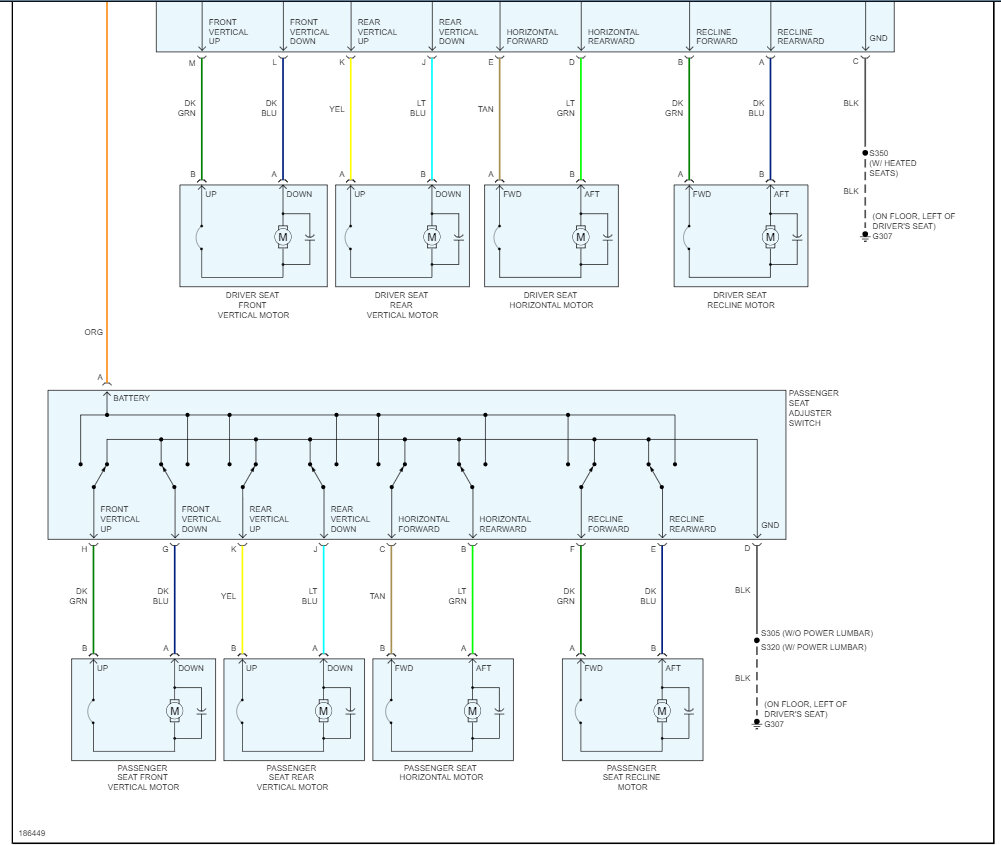

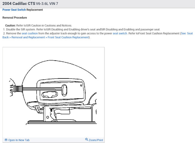

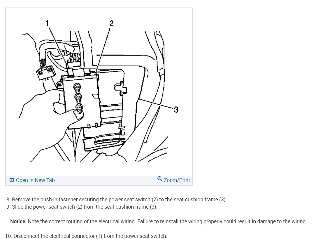

Yep, in the fuse panel under the rear seat (left side) let's check the circuit breaker for power and if that is okay the main control switch has probably gone bad. Here is a guide to help you check for power and I have included the wiring diagrams so you can see how the system works:
Check out the images (below). Please let us know how it goes.
