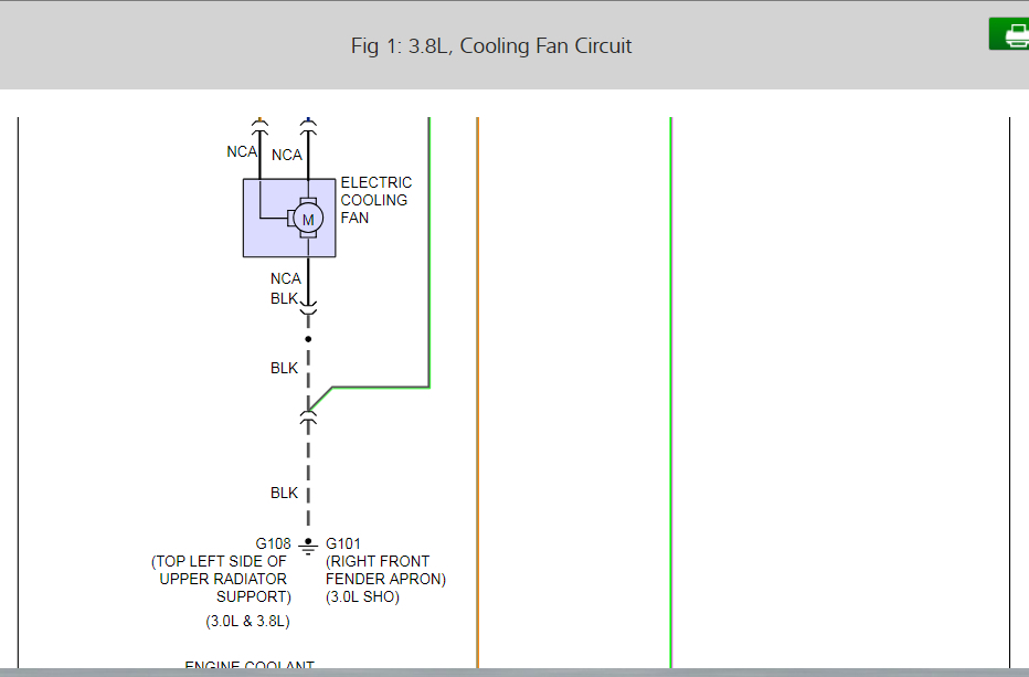

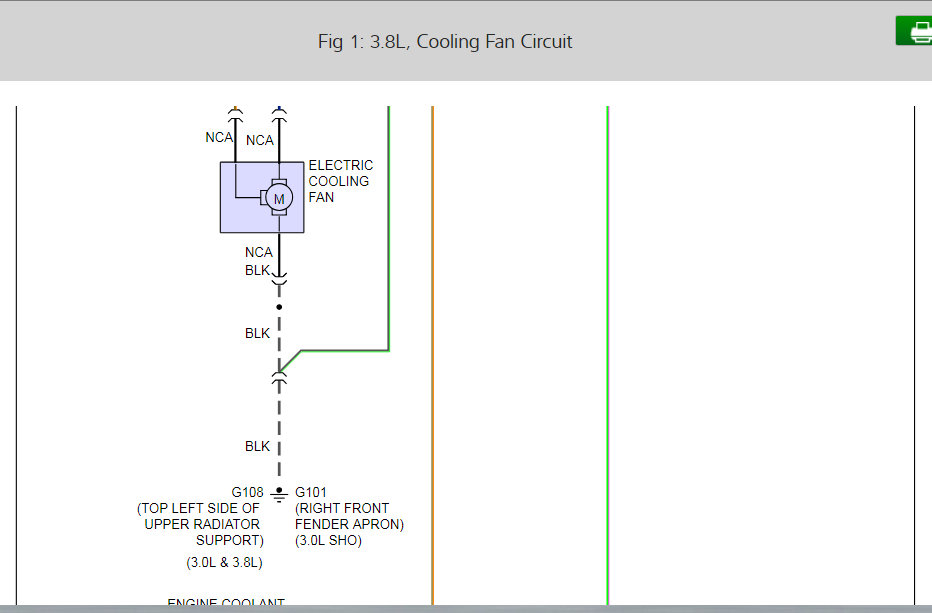

No power to electric fan. Engine cooling fan. Also have replaced radiator, fan motor, ECU, PCM, both cooling sensors and thermostat. Still no power to the electric fan motor.
Wednesday, April 3rd, 2019 AT 9:19 PM
SCGRANTURISMO
  • 4,897 POSTS
Hello again,

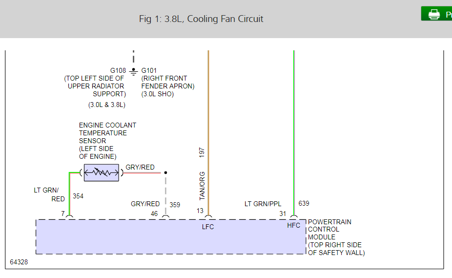

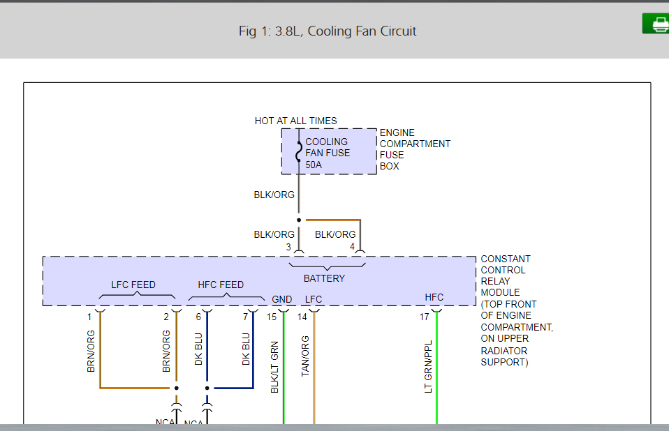

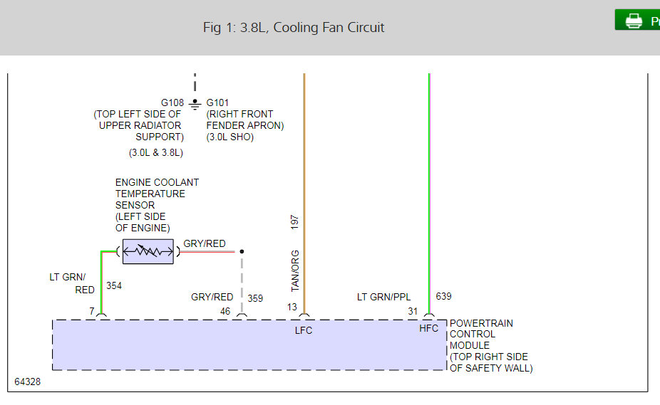

Check Ground 108 on the upper left side of the radiator support. Make sure it is clean, corrosion free, tight, and is making good metal to metal contact. I have included the wiring diagram for your vehicle's engine cooling fan circuit in the diagrams down below. Check out the ground and get back to us with what you find out please.
