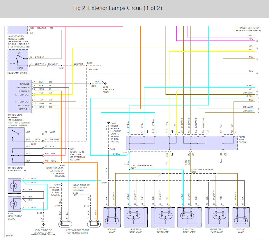

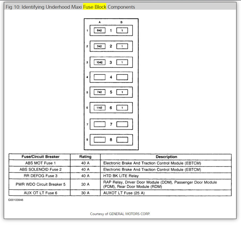

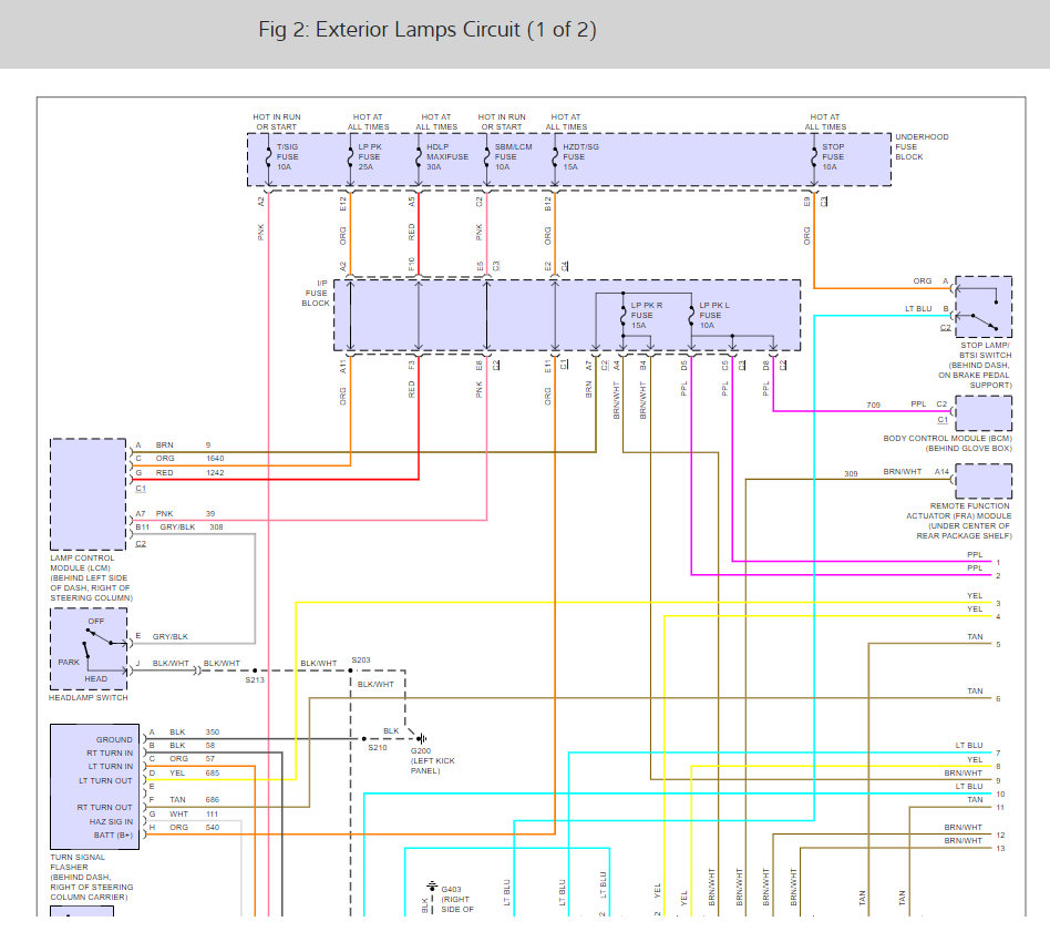

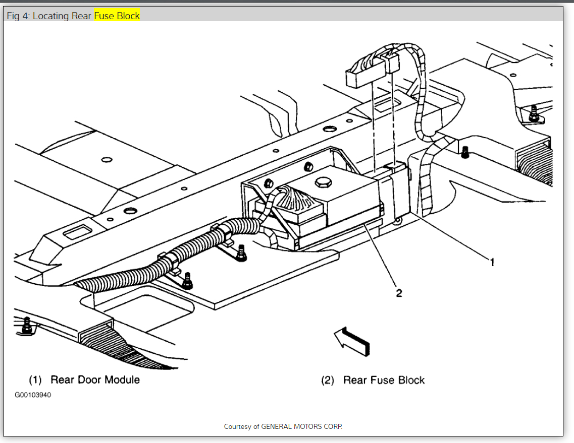

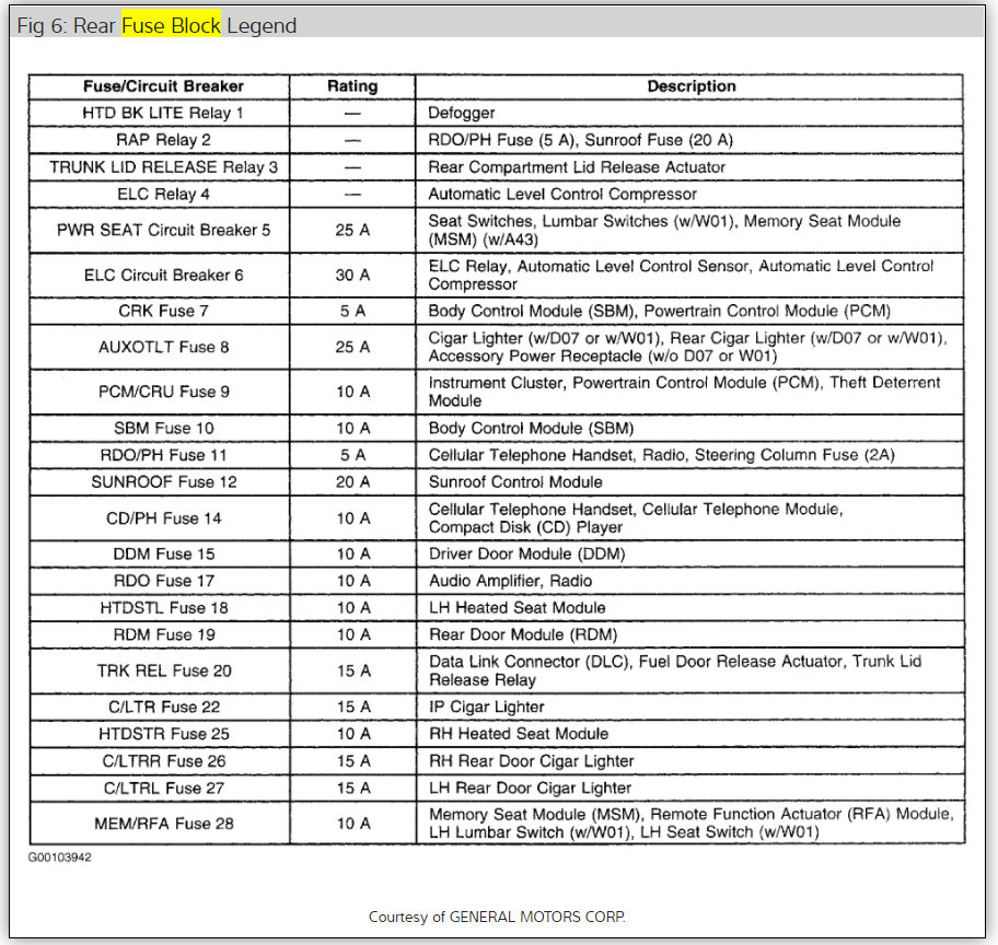

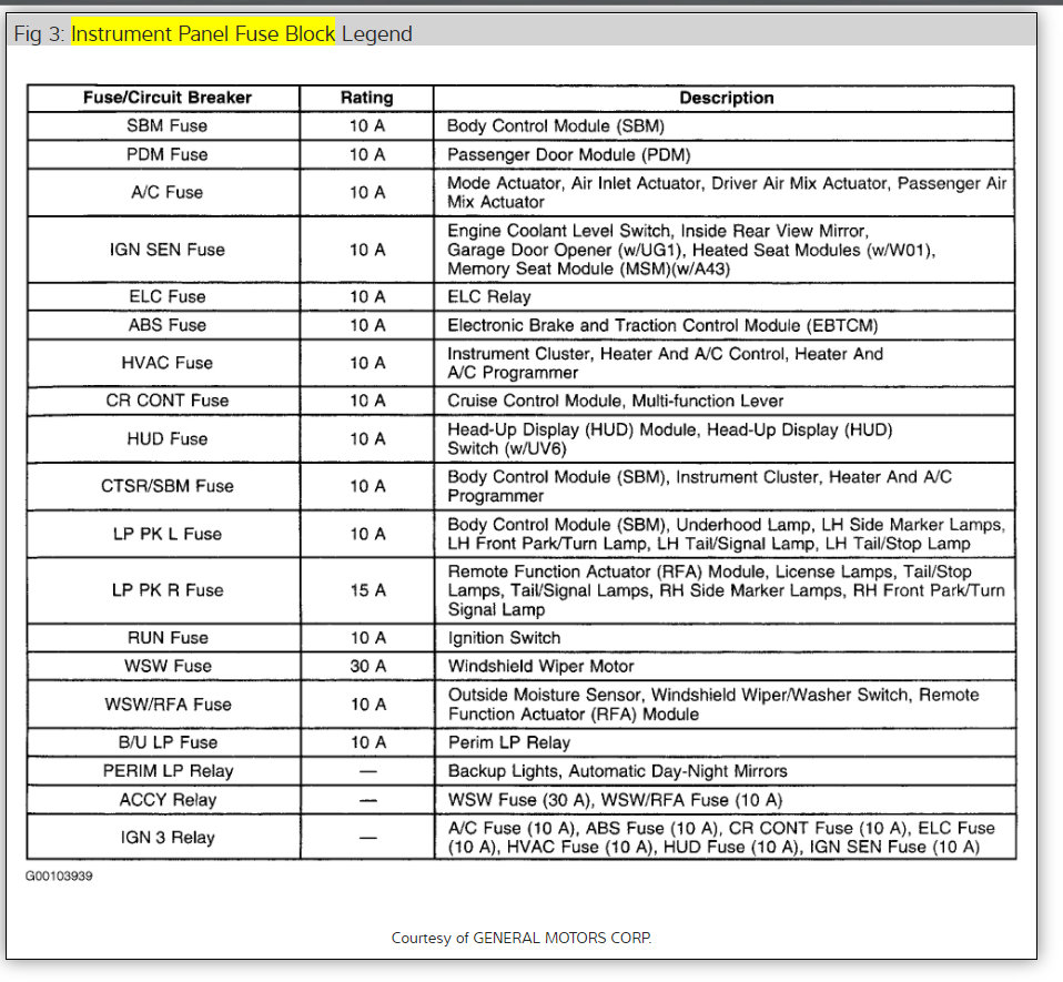

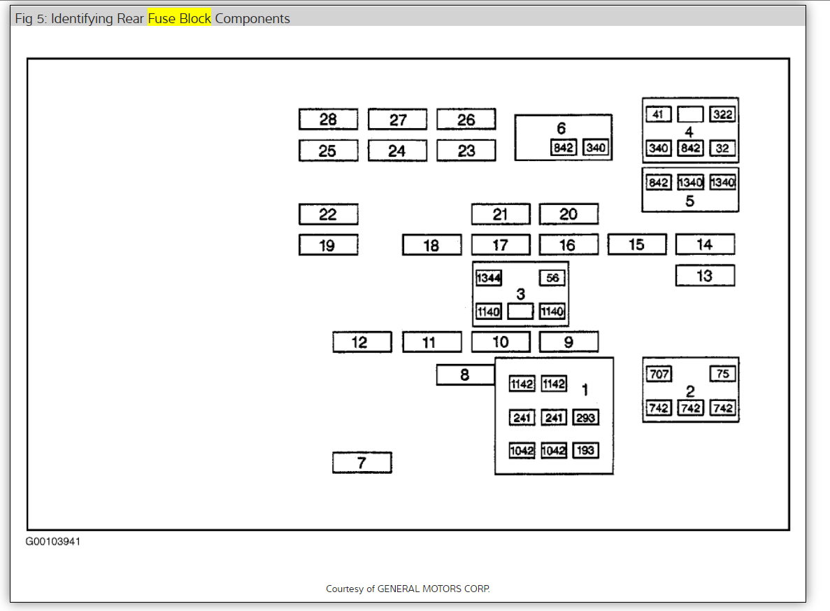

Dash lights out, tail lights out, fuses are okay .
Dec 19, 2017 at 9:47 AM
  • 55,732 POSTS

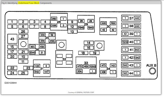

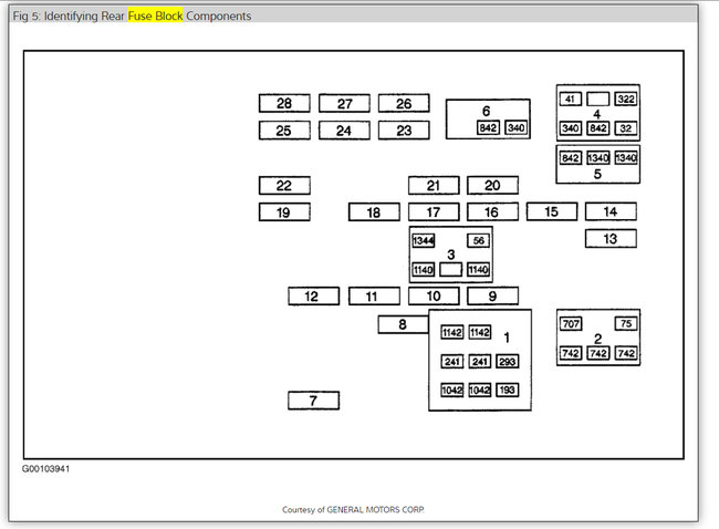

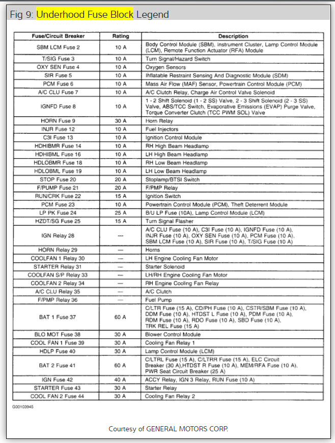

There are several fuses that run the system so just one fuse being good will not help. Here is a guide and a wiring diagram to see where you are losing power. I don't think it is the headlight switch.
and
Please run this test and get back to us.
