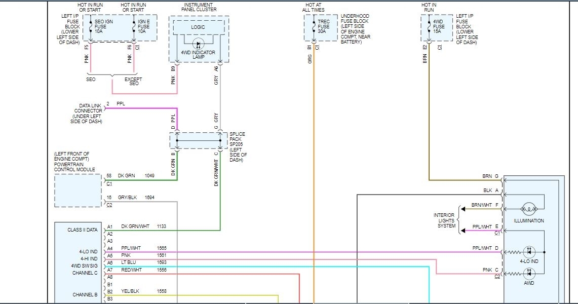

Four wheel drive for one. I found my SUV was in 4 wheel low when I started it up. and bought a new switch assembly and also replaced a 50 amp blown fuse. Which seemed to work. But when I go from 4 wheel low to either 4 high or 2 wheel I get a slight clunk. It only happens when it's in neutral. Doesn't do it in any other gear. Is this just common sound when shifting to 4 wheel low or do I have a problem? Also I either have a dead short or a loose ground wire. When I checked my new battery with my multi-meter while the engine was running the positive post sparked slightly and melted the positive wire on my multi-meter. I don't know whether the multi-meter was broken or I have a dead short somewhere.

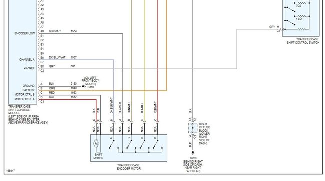

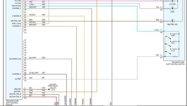

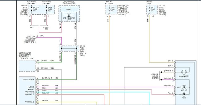

Yes, the noise is normal when the motor on the transfer case moves.

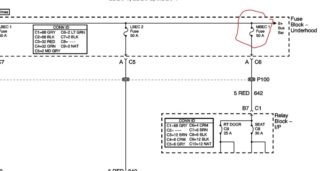

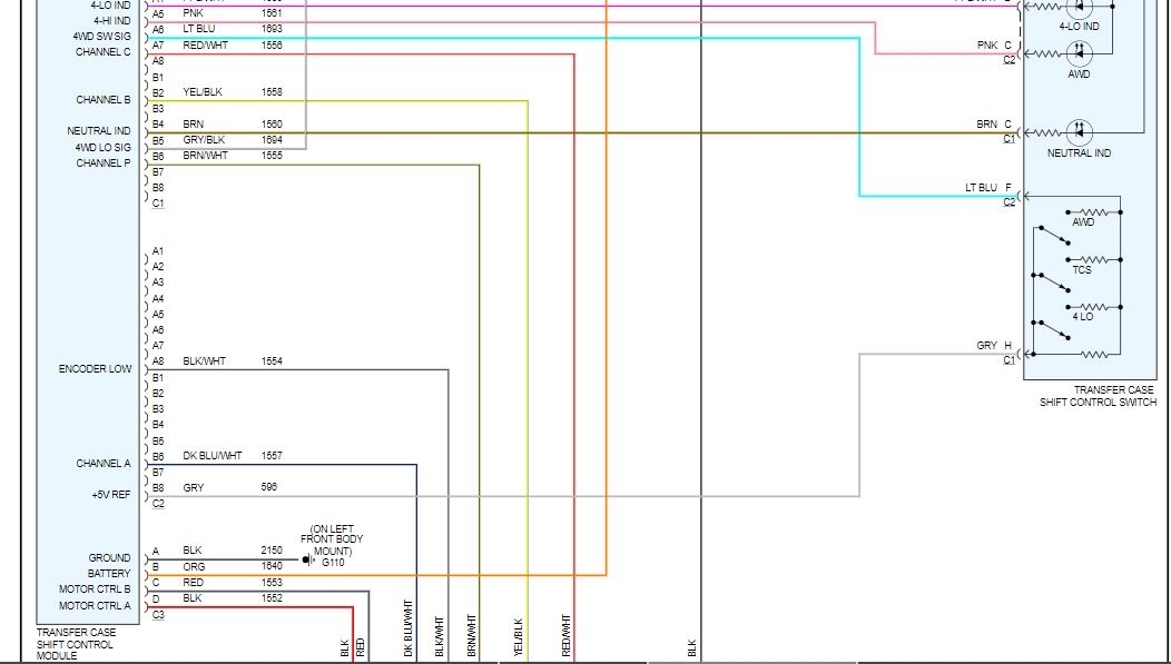

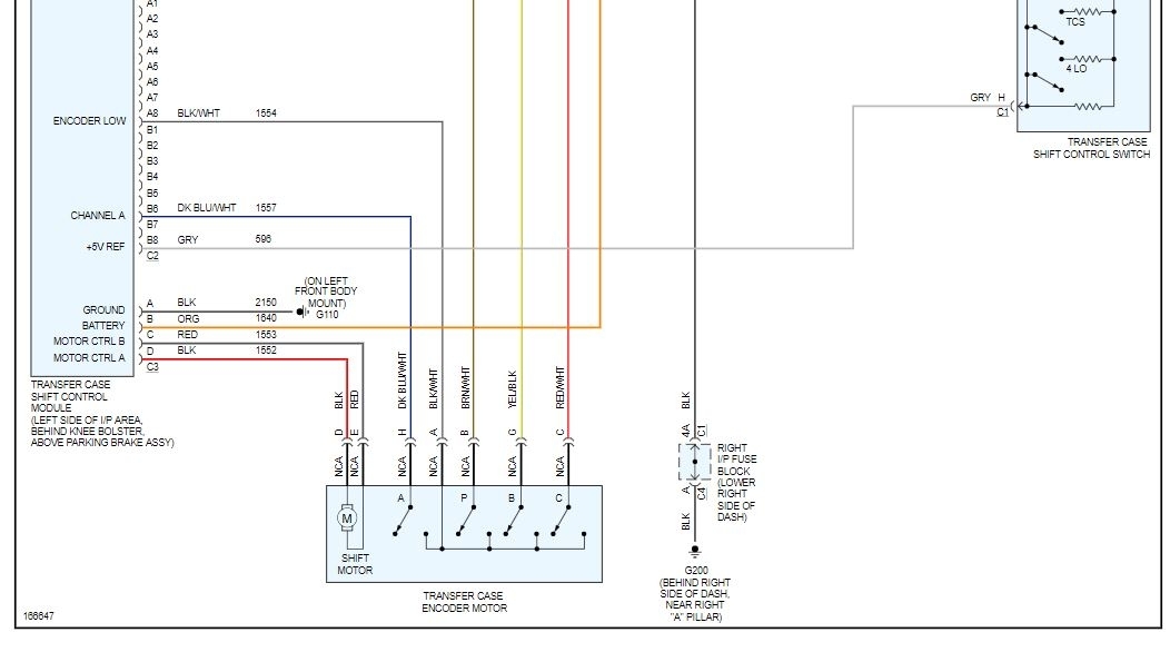

I attached a wire diagram. There is no 50 amp fuse. Can you tell me the fuse number that had 50 amps that failed?

There is 2 50 amp fuses under the hood fuse box towards the middle. There's 1 50 then a 40 a 50 and a 30. And no I don't believe it sparked when I installed the battery. But it did melt the positive wire to my multi-meter.

It is mbec 1 50 amp.
May 20, 2020 at 10:05 AM
Okay, I am concerned about the meter end.
What were you doing when the red lead from the meter melted?
That fuse is the feed for the relay block.
I attached a diagram for you.

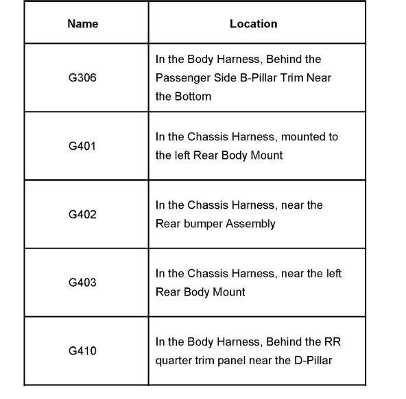

I've been having a few electrical problems and I suspect it has to do with my ground wires. My left front driver side door assembly is broken and also when I tried to get the seat switch removed, low and behold it started working again. I need to find out where all the main grounds are so I can clean them up and reattach them. By the way. My 03 5.3 vortec engine is fuel injected. Does that make it an lmg? Or what would it be in that year?
May 20, 2020 at 6:28 PM
I attached a list and locations of the grounds for you to check.
they do not show a diagram but if you need a specific location, reach out to me and I will see if I can get a picture for you.
