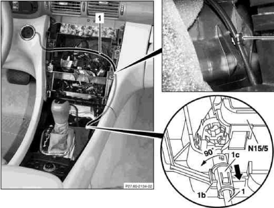

Unfortunately the key must be on to do a CAN scan. Have you checked all fuses? Also, there is an ignition lock cable that needs to be checked, if the cable is jammed the key worn turn. Check out the images (below). Please let us know what happens.

Hi.. Is this cable on manual or automatic vehicles? Where is it located?

I have checked all fuses. This is a manual transmission don't think it has this ignition lock cable.

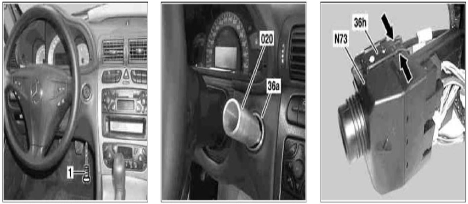

My bad, yep I have never seen a manual c230 car. To be clear when you say ignition "eis" this is what you replaced correct?

Yes the 3rd picture is the switch I've had programmed and also bought another one just for safety sake.. I also had the keys programmed and checked.. Then for an added step I bought an esl bypass emulator.. Locksmith says all checks out.. Car has no fault codes.. Just can't seem to turn key in ignition.. I'm at wits end.. Was thinking to pull the steering column don't know if that would work.. All fuses checks out aswell also checked relays aswell.. Still to no avail.. Any ideas would be much appreciated..

Does the key turn in the module before installation?
