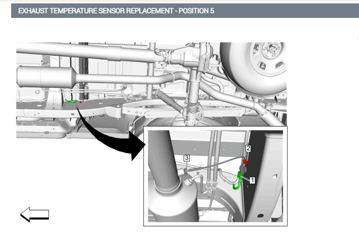

I have a bad EGT Sensor 5 on the truck but I'm not sure of the exact location of this particular sensor. Any help would be appreciated.
Apr 11, 2023 at 7:56 AM
Experienced Mechanic
110,244 POSTS
We don't see many of these with a diesel, but I've driven and like them.

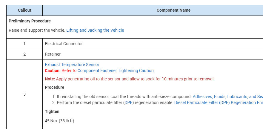

As far as the exhaust gas temperature sensor 5, it is under the vehicle. If you look below (pic 2) it is number 3 in the pic.

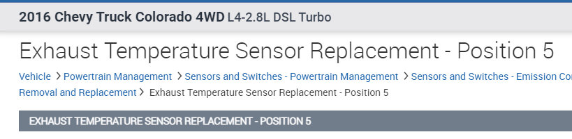

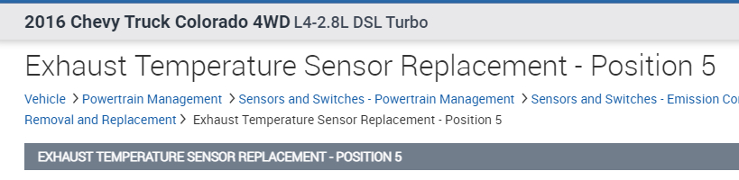

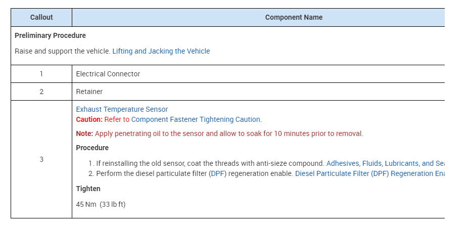

The three pics below are the directions for the removal and replacement of the sensor.
I hope this helps. Let me know how things work out for you.
