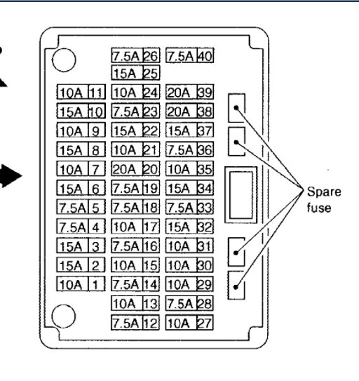

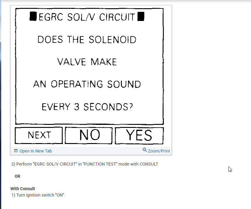

Is there a fuse to the solenoid and where it is and what number is it?
Sep 8, 2016 at 8:34 AM

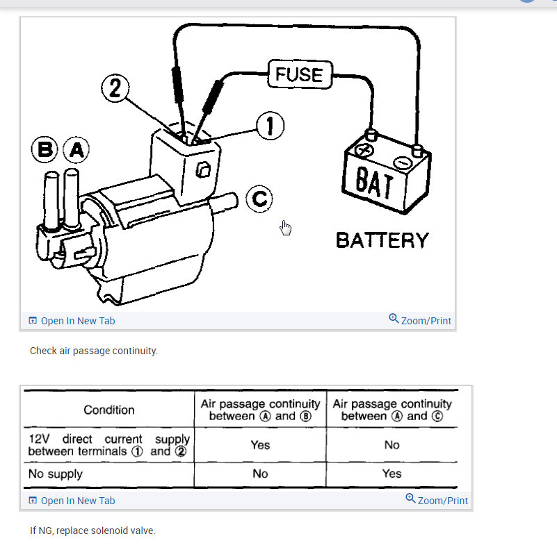

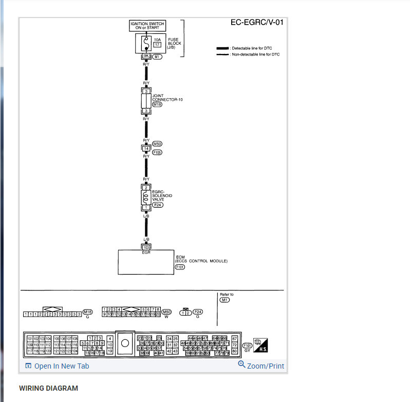

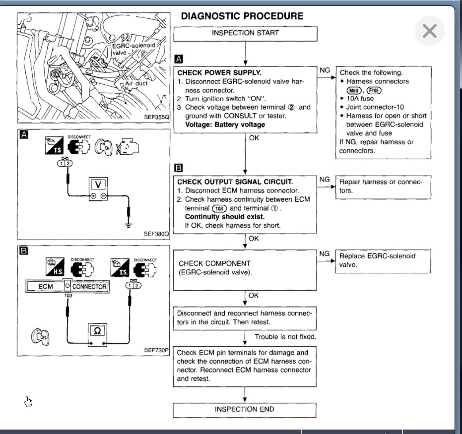

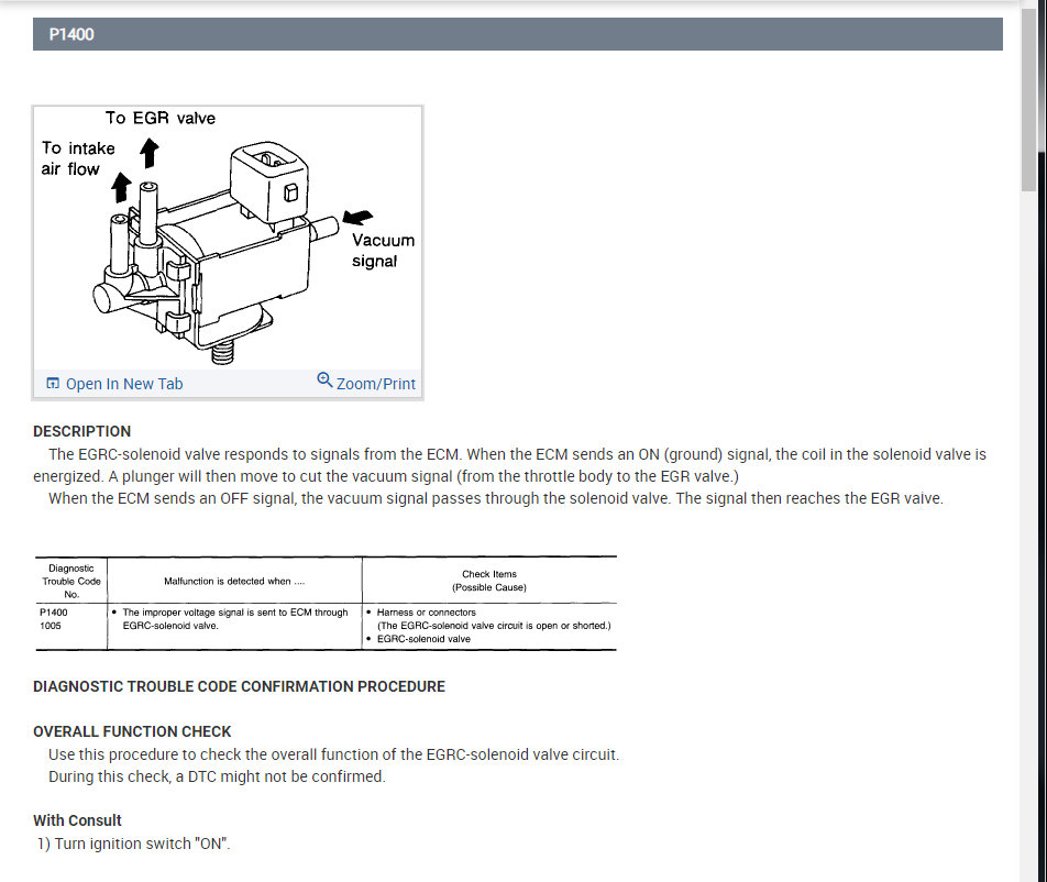

This does have a fuse. It is fuse 17 in the junction block. I attached the info for this fuse.

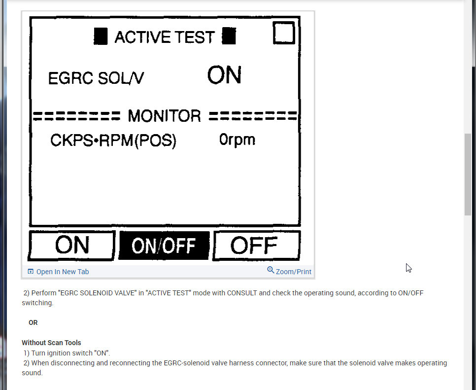

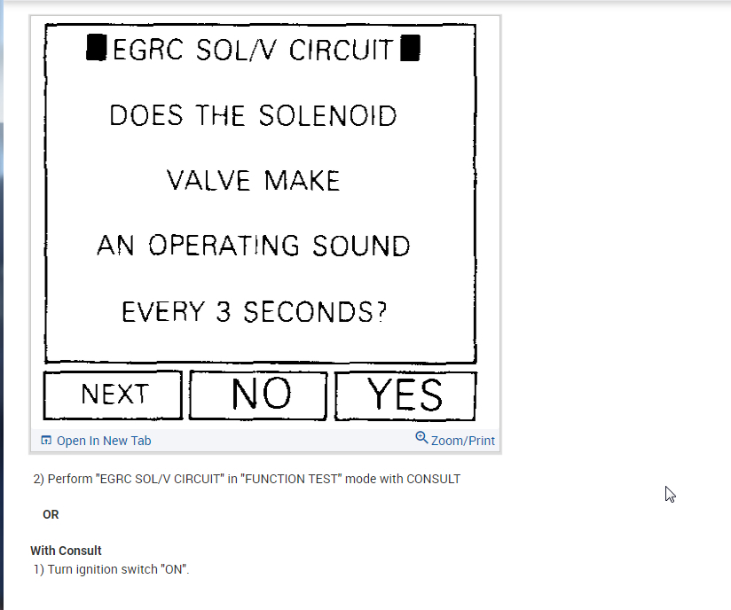

However, I also attached the testing that we need to run through to find out what the issue is. This requires the use of a voltage meter and here is a guide that will help with that.
Run through this and let me know what questions you have. Thanks
