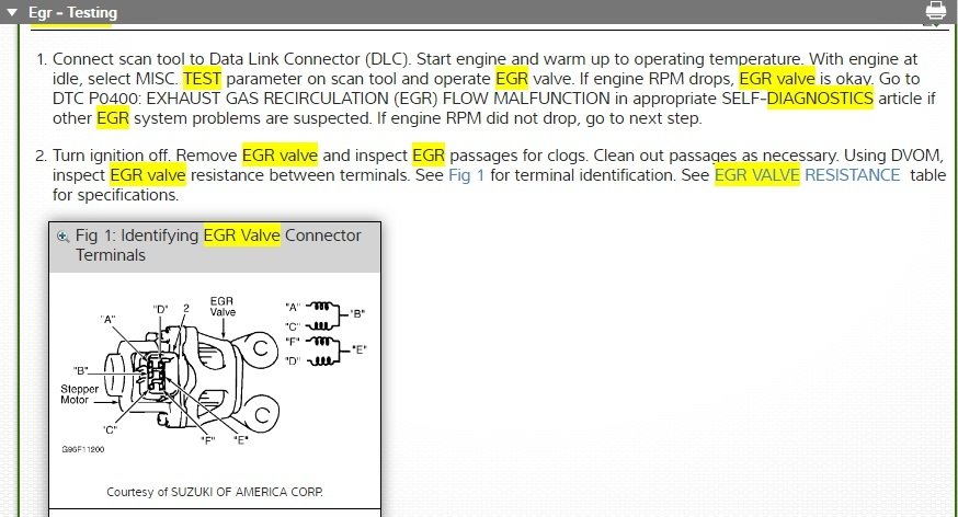

After replacing the IAC and driving the for about two weeks, it began to idle very rough, (down to 200 rpm) but not stalling.
I rechecked the IAC and timing.They tested good. no codes present. I am leaning towards the EGR valve. How can I test it with a multi-meter?
Sep 3, 2017 at 4:20 PM
CJ MEDEVAC
  • 11,004 POSTS

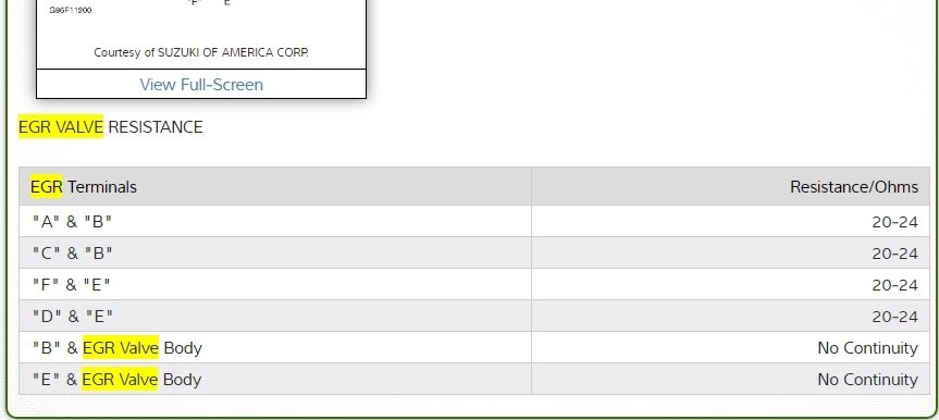

Is this what you need?
I had to make two screenshots in "Prodemand" to get it all.
Click on the two diagrams below.

yes CJ that is exactly what i needed. Thank you very much.
