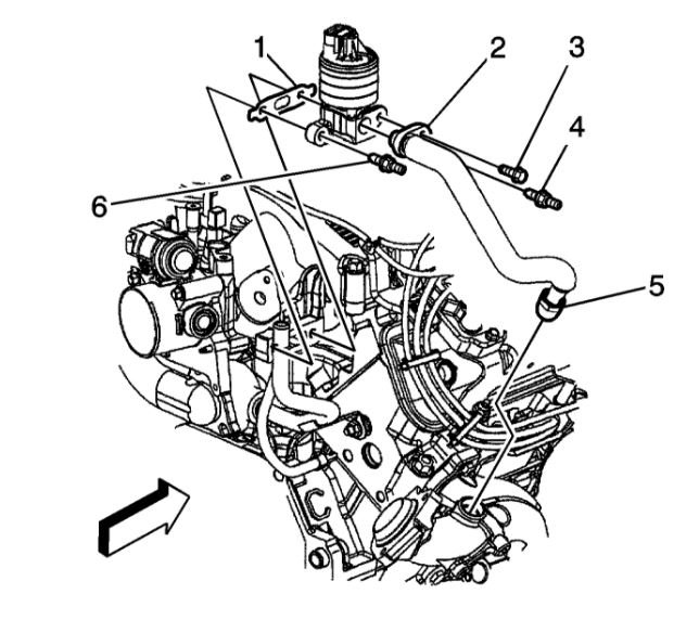

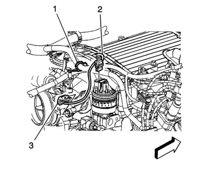

How do I get to the EGR valve and replace it? It's in the back of the engine really buried down there.

I posted the procedure for you below.
Yes, it is tight to get. You need small fingers and a lot of patience.
I attached a YouTube video for you to view. It is for a 3.4 but they are the same.

1. Remove the intake manifold cover.
2. Remove the air cleaner outlet duct.
3. Disconnect the engine harness electrical connector (2) from the exhaust gas recirculation (EGR) valve.

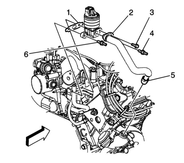

8. Remove the EGR pipe bolt (3) and carefully pull the pipe (2) assembly back.
9. Remove the EGR valve studs (4, 6).
10. Remove EGR valve.
11. Remove the EGR valve gasket (1).
12. Clean and inspect the EGR valve gasket mating surfaces.

1. Install a new EGR valve gasket (1).
2. Install the EGR valve.
Notice: Refer to Fastener Notice.
3. Install the EGR valve studs (4, 6).
Tighten the studs to 30 N.m (22 lb ft).
4. Install the EGR pipe (2) to the EGR valve.
5. Install the EGR pipe bolt (3).
Tighten the bolt to 25 N.m (18 lb ft).
6. Connect the engine harness electrical connector (2) to the EGR valve.
