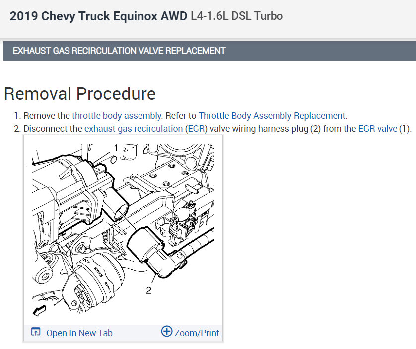

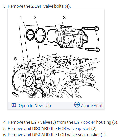

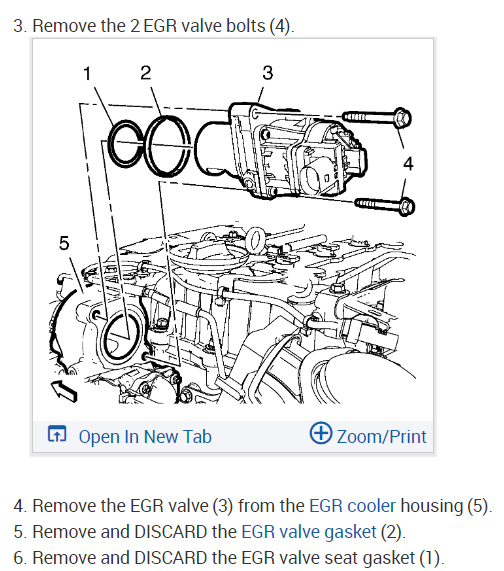

I need to replace the EGR sensors but don't know where the EGR valve they are connected to is located.
Oct 13, 2024 at 7:33 AM
  • 55,423 POSTS
Yep, here is the location of the EGR valve which is located on the side of the engine. Check out the images (below). Let us know if you need anything else.

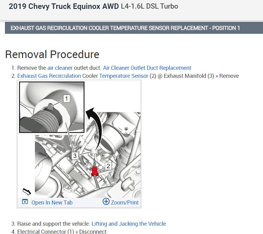

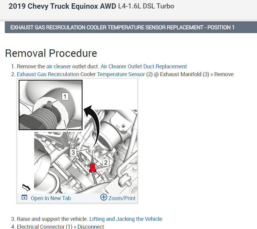

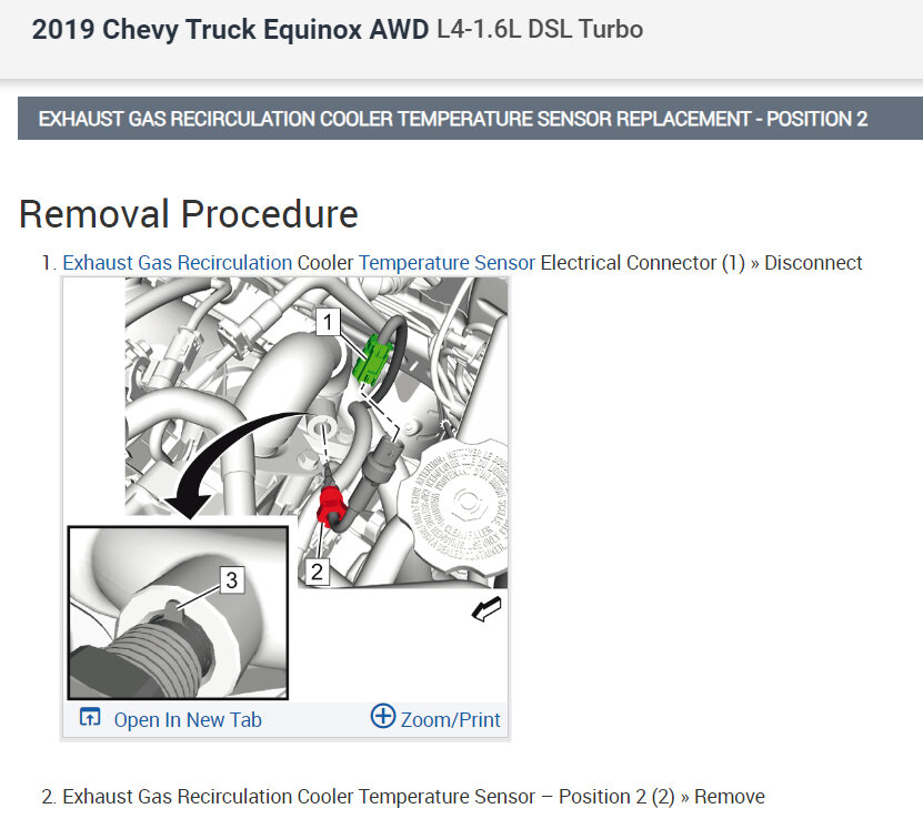

Can you provide an image on how to remove the EGR Temperature Sensor 1 and the EGR Sensor 2
Oct 17, 2024 at 5:35 AM
  • 55,423 POSTS
Sure, here is how to remove both temperature sensor 1 and 2. Check out the images (below). Let us know if you need anything else.

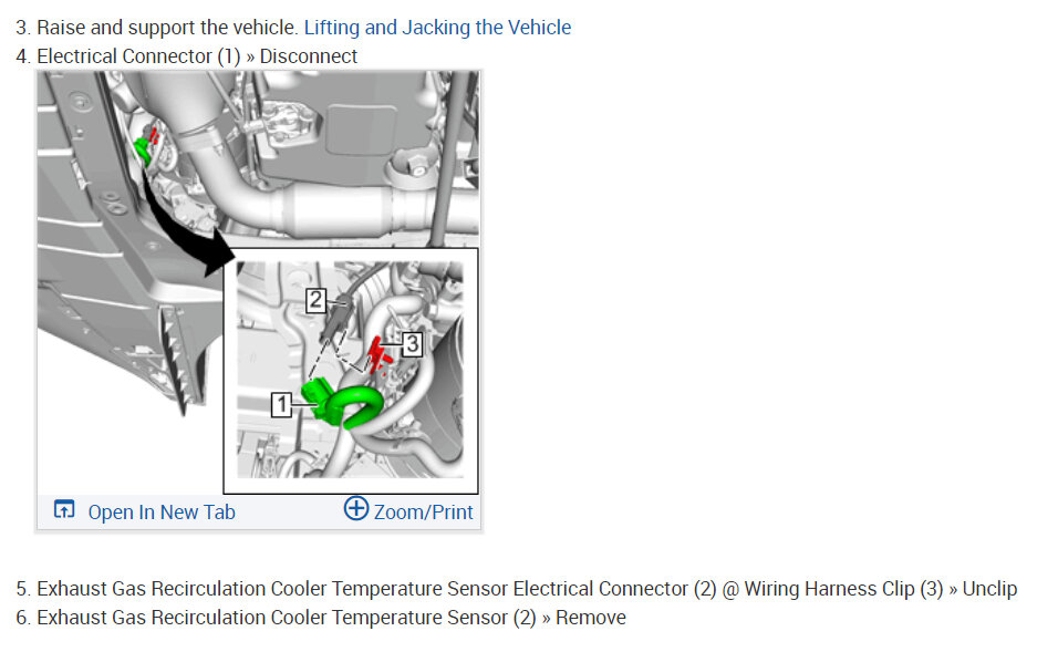

I am confused. I wasn't able to do the temperature sensors as I couldn't locate them. Can you send me pics from beginning to end on how to remove and replace the EGR temp sensors 1 and 2 on a 2019 Diesel Chevrolet Equinox.
Nov 12, 2024 at 3:21 AM
  • 55,423 POSTS
This is all they give us, it looks like one of the sensors is accessed from under the car. Did you click the images above?
