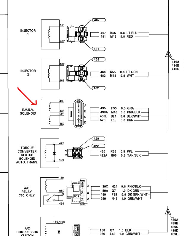

How to troubleshoot the EGR valve control solenoid?
1987 GMC JIMMY
90,000 MILES • 2.8L • 6 CYL • 4WD • AUTOMATIC
ACTIVEAL
How to troubleshoot.
Jan 10, 2025 at 7:21 PM
  • 55,433 POSTS
That is a linear valve so it might be difficult to test but you can try a continuity test between the two coil windings.
Here is a guide and the EGR control valve wiring diagrams:
