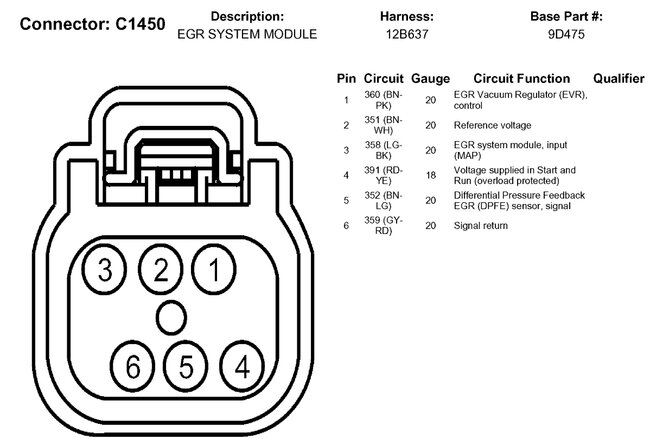

Can I get a diagram of the function of each wire on the EGR valve connector?
188,000 MILES • 4.0L • V6 • 2WD • AUTOMATIC
IAMJACK
Does anyone have a diagram of the function of each wire on the EGR valve connector? A picture like the one added below would be great. Easy to read and understand.
Feb 19, 2025 at 3:28 AM
  • 55,814 POSTS
I don't see the image can you upload it again? In the meantime, here is the connector view and pinouts for the EGR system. Check out the images (below). Let us know if you need anything else.
