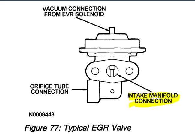

EGR valve and DPFE location
2005 FORD RANGER
125,000 MILES • 3.5L • V6 • 2WD • AUTOMATIC
SETH KEENEY
I cannot find the EGR valve location on my truck listed above XLT 3.0L. I am not sure if it has a EGR, If it doesn't have a EGR, then where could the DPFE sensor be located at?
Thank you!
Dec 19, 2020 at 11:03 AM
  • 110,194 POSTS
The EGR valve is on the intake manifold. See the attached pic.
Let me know if you can located it. Also, if you are replacing it, it simply unbolts from the intake. There will be a steel EGR tube attached that will need disconnected.
