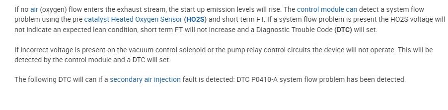

The O2 sensor has to read lean to tell the ECM that the pump is working.
It could be the O2 sensor or it could be a clogged passage in the head from the pump plumbing.

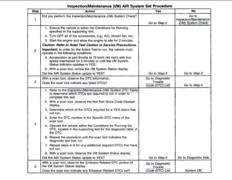

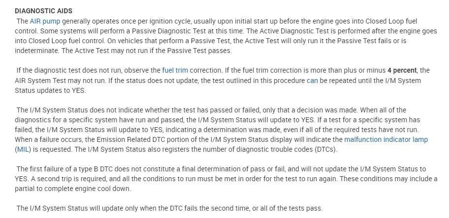

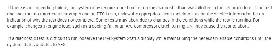

Information for you on setting the monitor.
Feb 19, 2020 at 1:18 AM

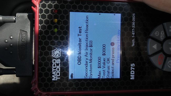

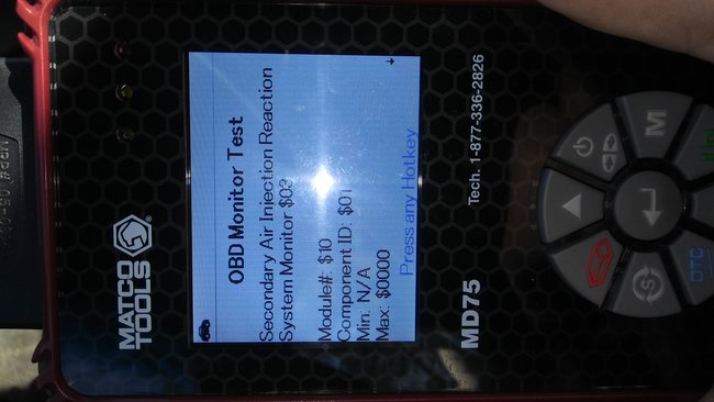

The scan tool im using has a secondary air injection reaction system monitor $03
Component ID $01
Min N/A
MAX $0000
Test Value $0000
Status OK
Not sure what it means. Looks like it didn't get a reading.
If the test isn't completing i don't know why. Thanks for the info.

It says status okay.
Is it still showing incomplete?

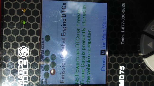

Can you post a snapshot of that on your reader?

Air is red and all others are green. It's hard to see in the photo but the bottom left is air and is the only one red.
Feb 19, 2020 at 4:28 AM
It says OK for the status which means it is set.
Feb 19, 2020 at 4:59 AM
CRAIG_1
  • 7 POSTS
Okay! But why is it red?
Feb 19, 2020 at 5:00 AM
The picture is not clear enough to see that.
