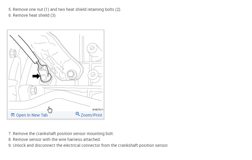

It has a hesitation when I start driving and then there has been a few times it would just shut off going down the road doing 60 mph or higher. Where is the EGR valve located on this engine and would it cause the problem?

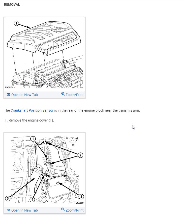

As for the stalling at highway speeds, do you have any codes? You may not have any yet but the common failure on these World Engines is the crank sensor fails and when the PCM is not getting any signal from the crank, it cuts the engine off. You will need to replace the crank sensor.
However, when you replace it you must perform a procedure called an adaptive numerator relearn. Basically, this is teaching the PCM that there is a new sensor. On these PCMs, the only way to do that is with a scan tool that can perform this procedure. It includes a drive procedure specific to this process and the scan tool must be hooked up while doing it. If you do not do this, then you will get multiple cylinder misfire codes and it will cause you many headaches trying to diagnose these misfires because no matter what you do they will not go away until this is performed.

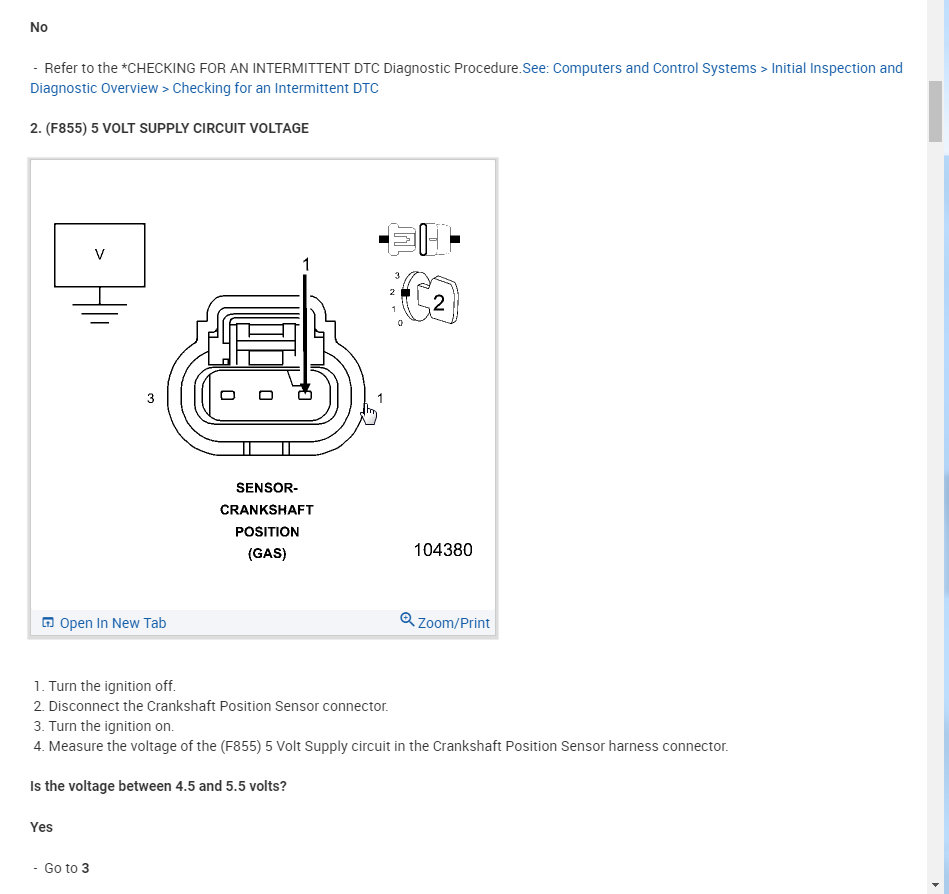

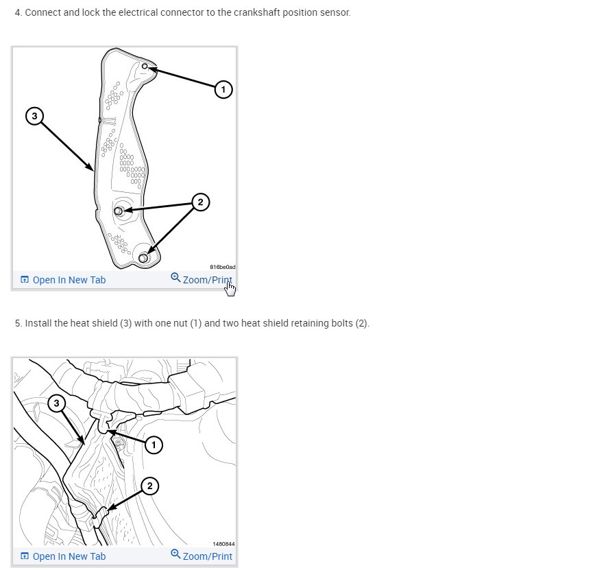

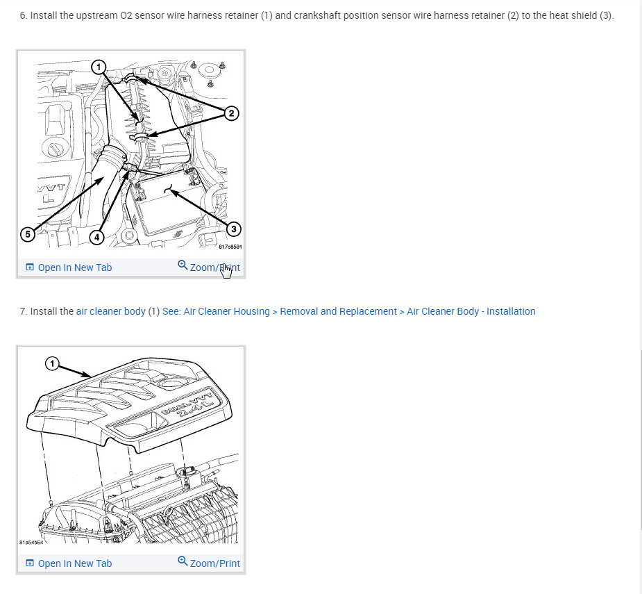

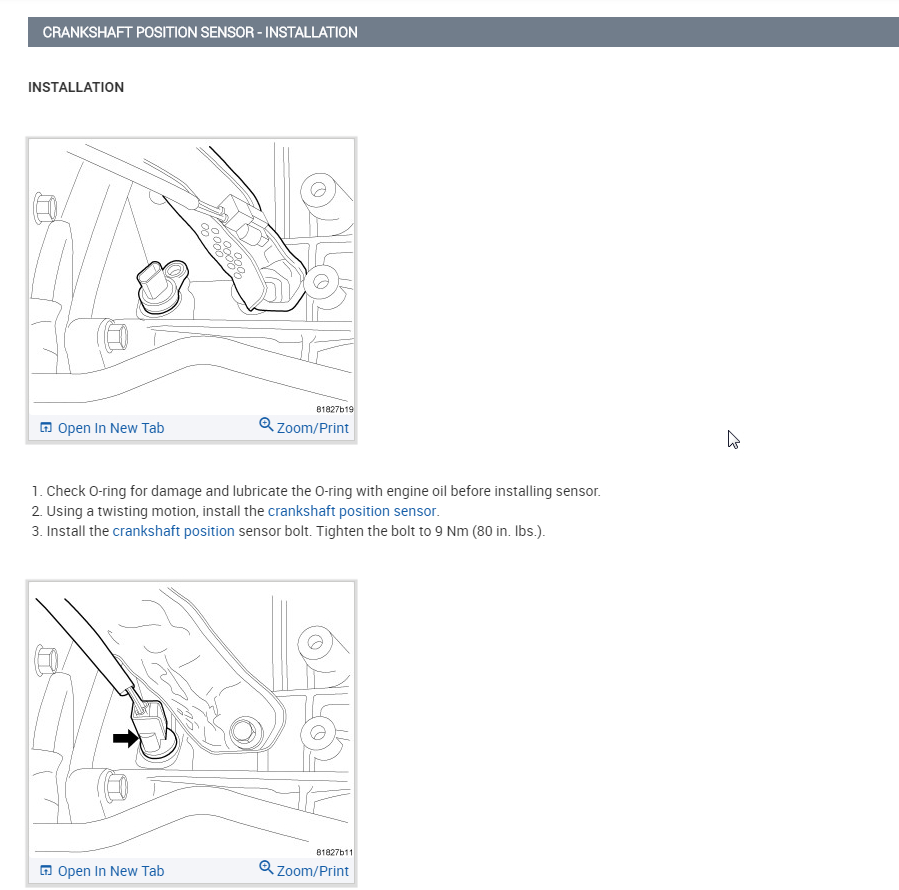

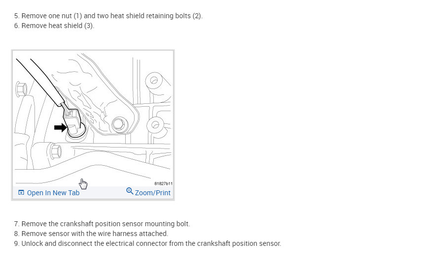

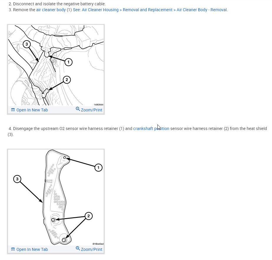

I had already had a new crankshaft position sensor in but I don’t be the mechanic unhooked the battery when he put the new one in. Do you think he might have shorted something out or could he blew the new sensor or do you think I could have gotten a bad sensor. What do I do next to fix my problem?
Aug 27, 2019 at 5:40 AM
It is unlikely that not unhooking the battery caused it to short out and getting a bad sensor is also unlikely.
The next most likely cause of the engine stalling is the PCM, its power source, or ground. If one of these are faulty then the engine could just shut off.
When it does this, does the engine sputter, any check engine light flashing or staying on when it does it?

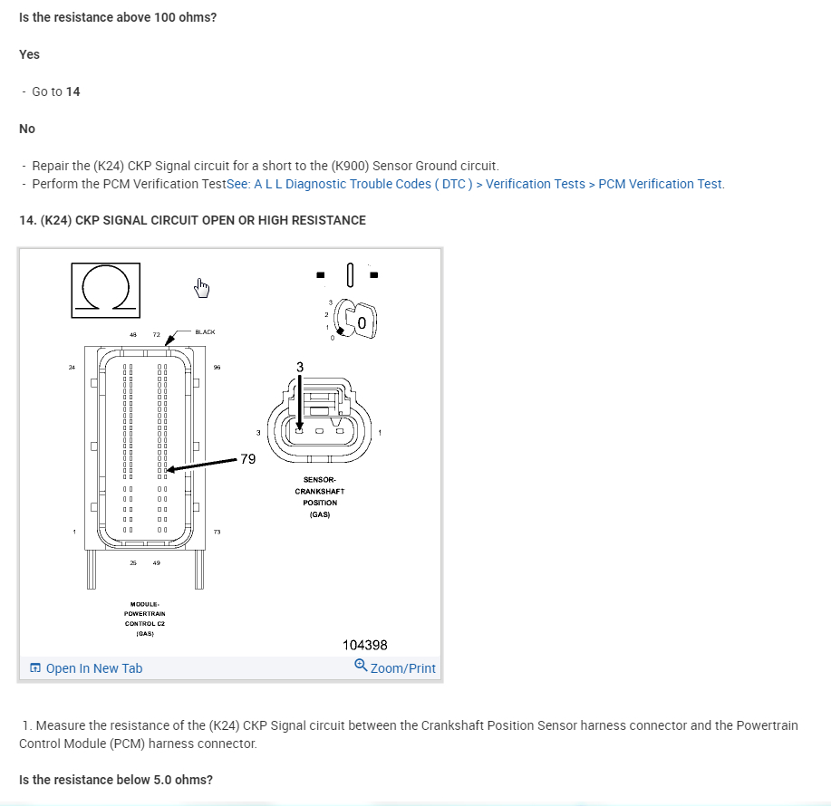

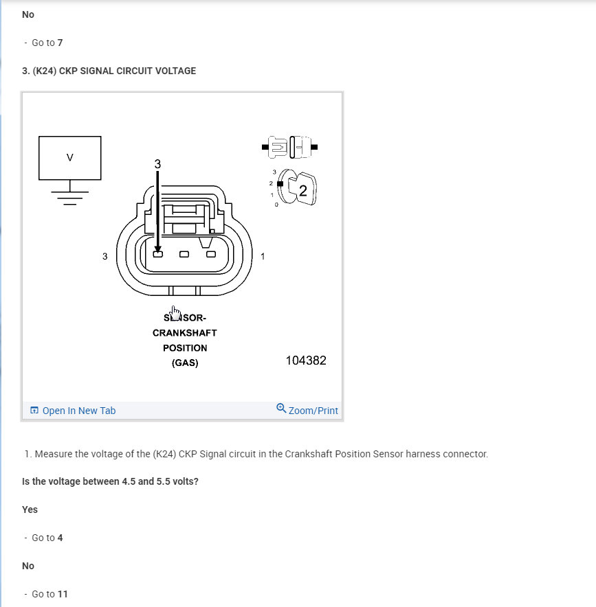

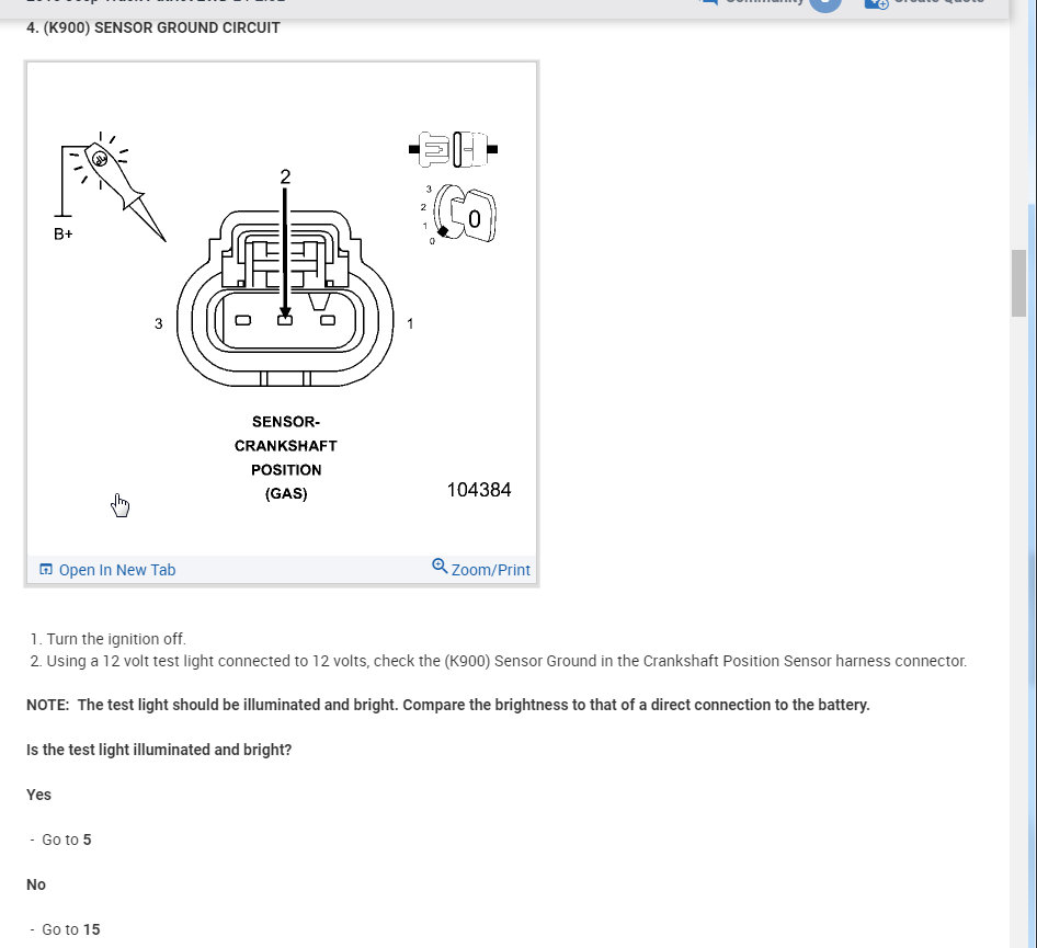

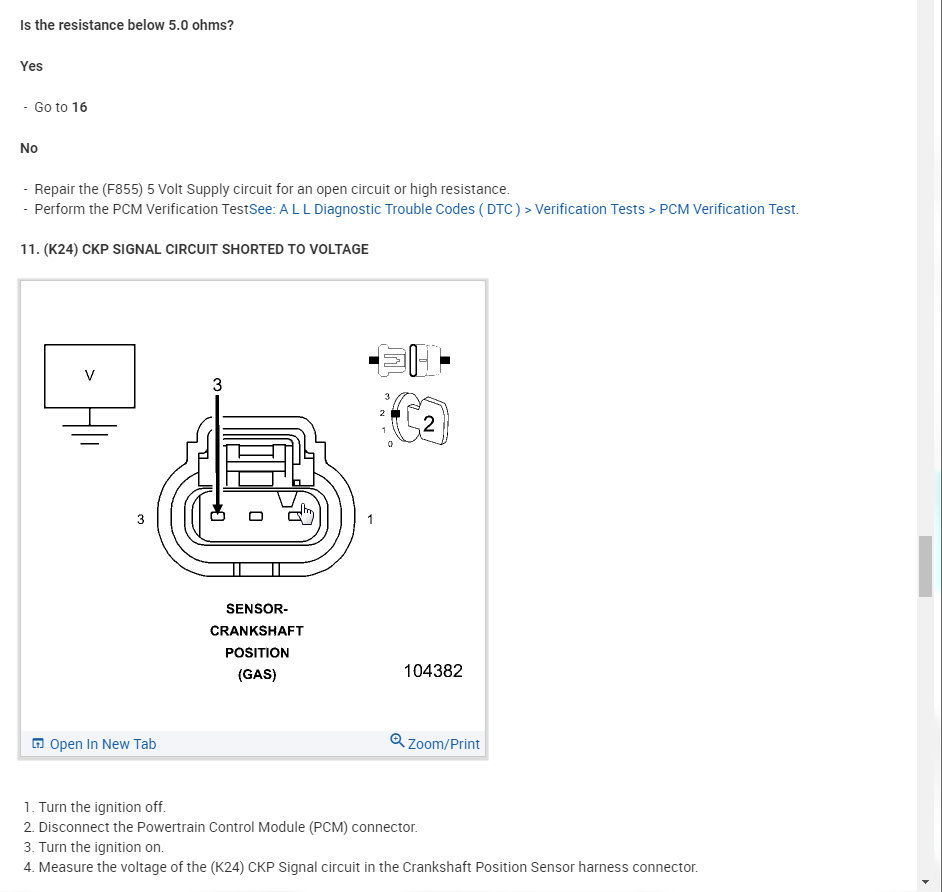

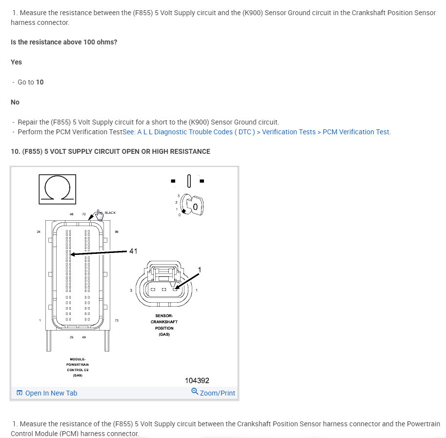

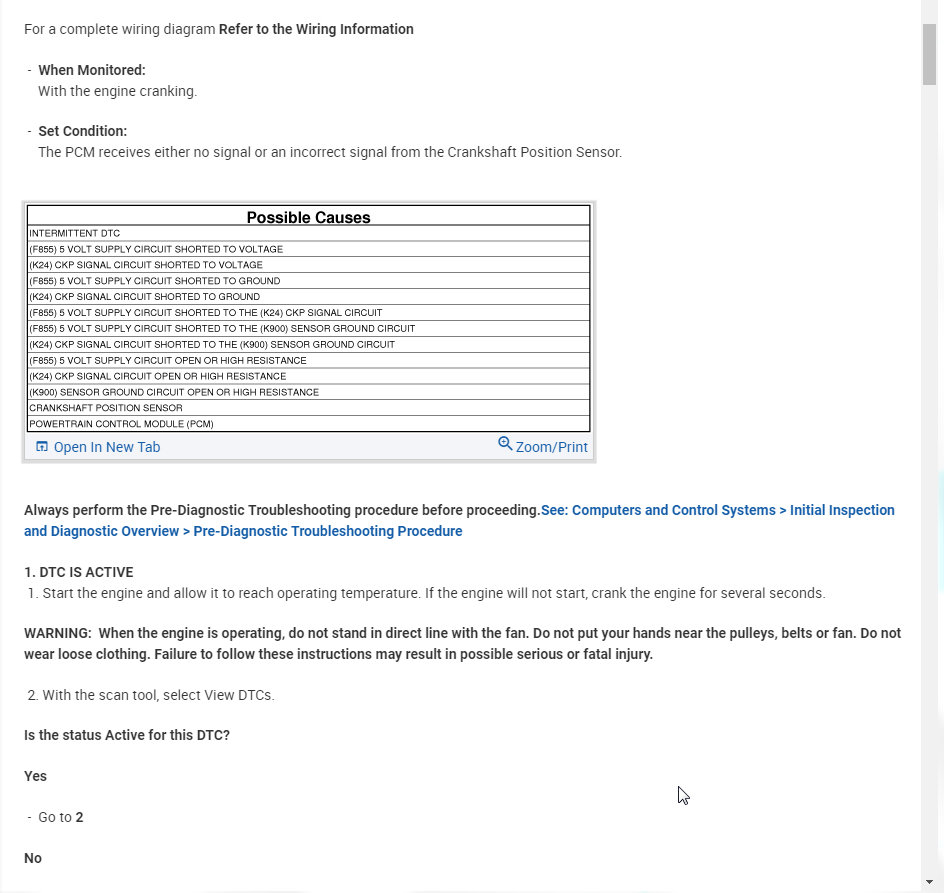

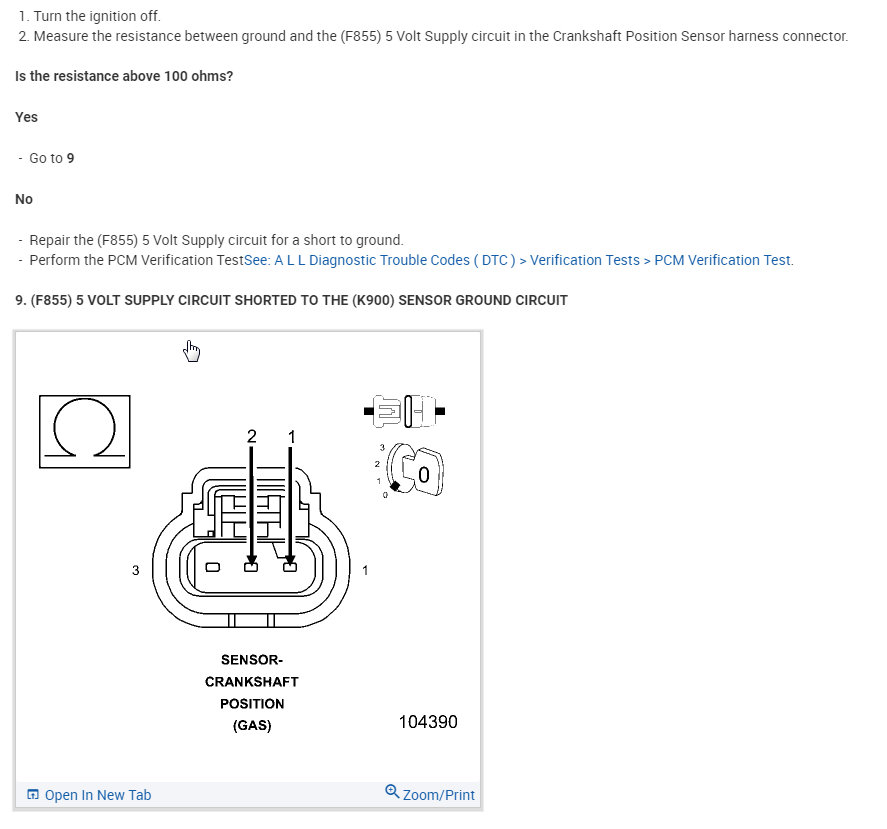

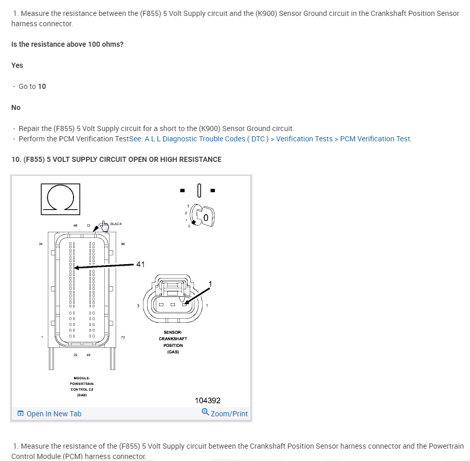

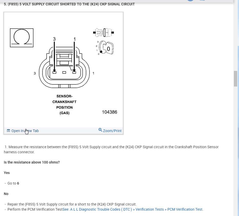

There were a few p0300, p0315, p0335.
Aug 27, 2019 at 12:45 PM

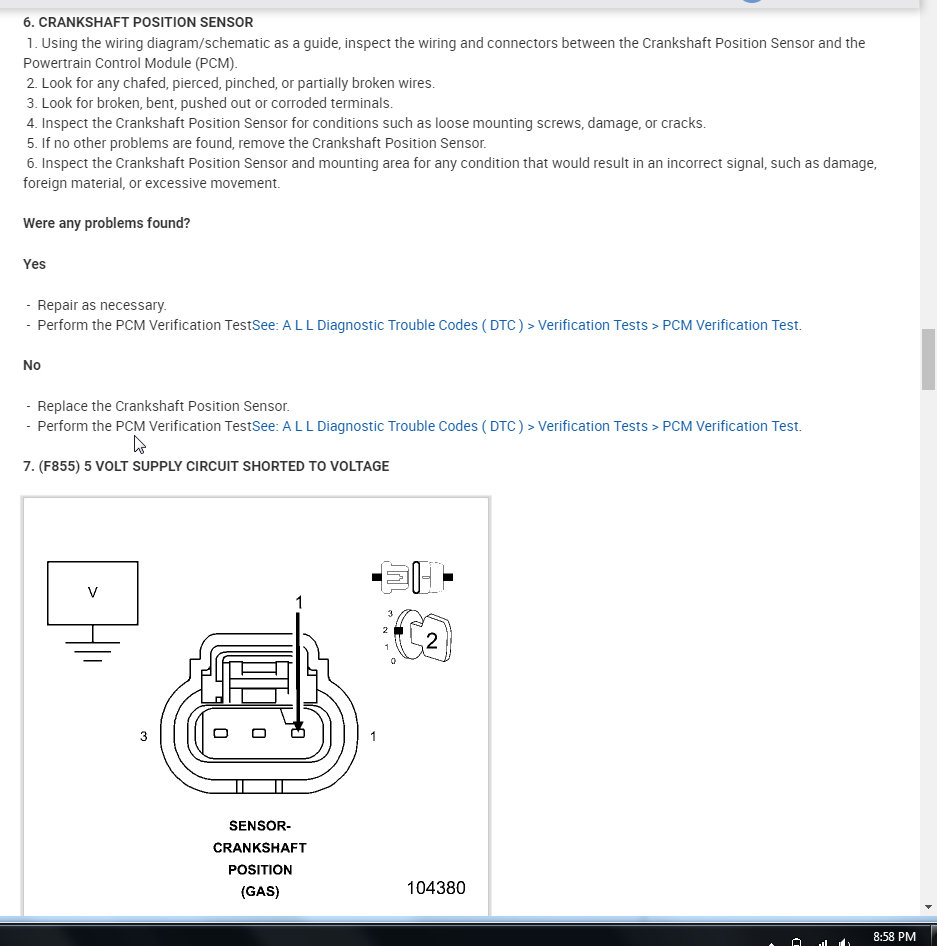

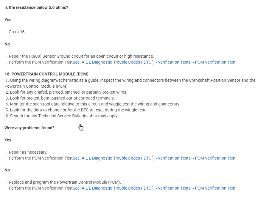

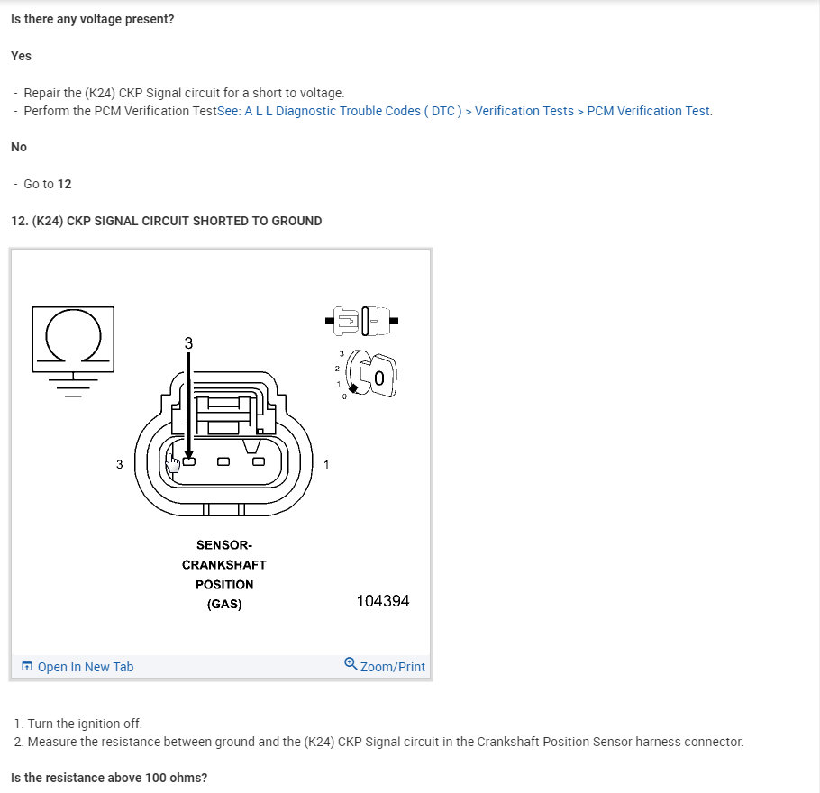

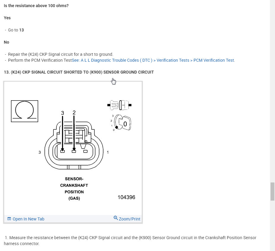

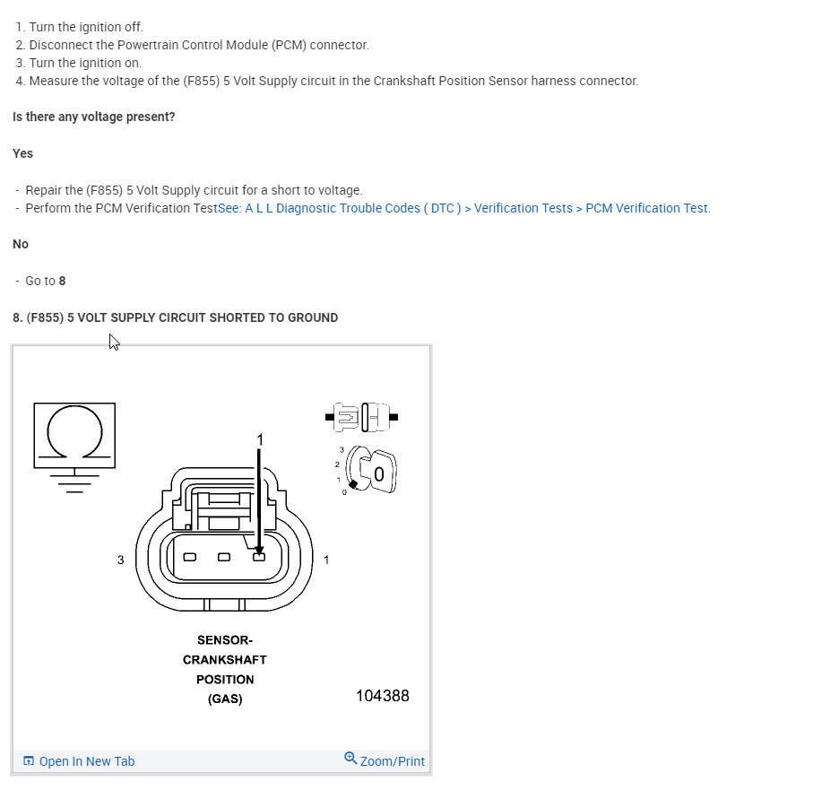

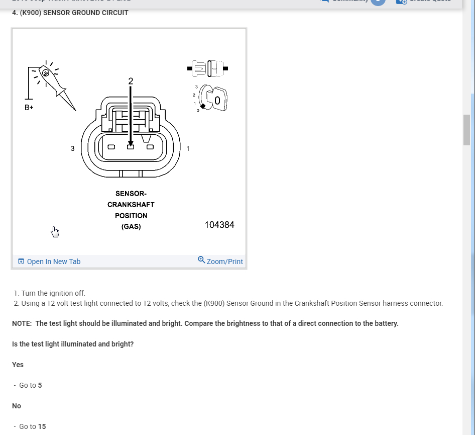

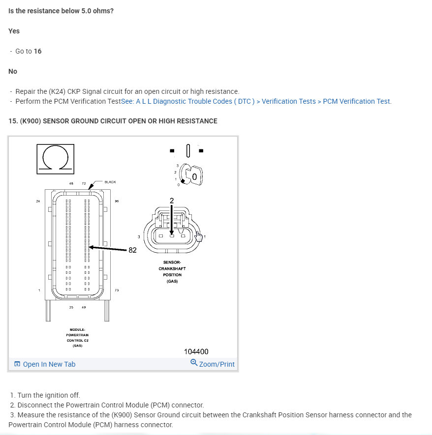

Okay. P0300 is a multi cylinder misfire. The P0315 is for No learned Crank sensor and P0335 is for the crank sensor circuit code.
If you refer to my post from the 26th where I talk about what needs to happen after you replace the crank sensor, this is what I was referring too. If you do not perform the learn procedure with the scan tool after a crank sensor replacement, these are the codes you will have.
The only one I am concerned with is the P0335. That is a circuit code which indicates a wiring issue. I suspect it will go away after the procedure is run but if not you will need to diagnose the wiring.
This circuit issue could also be your stalling issue so we need to run the learn procedure and then retest it.
If you do not have the scan tool, you will need to go to someone who does and have this performed.
