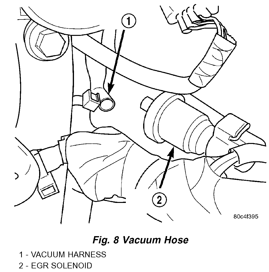

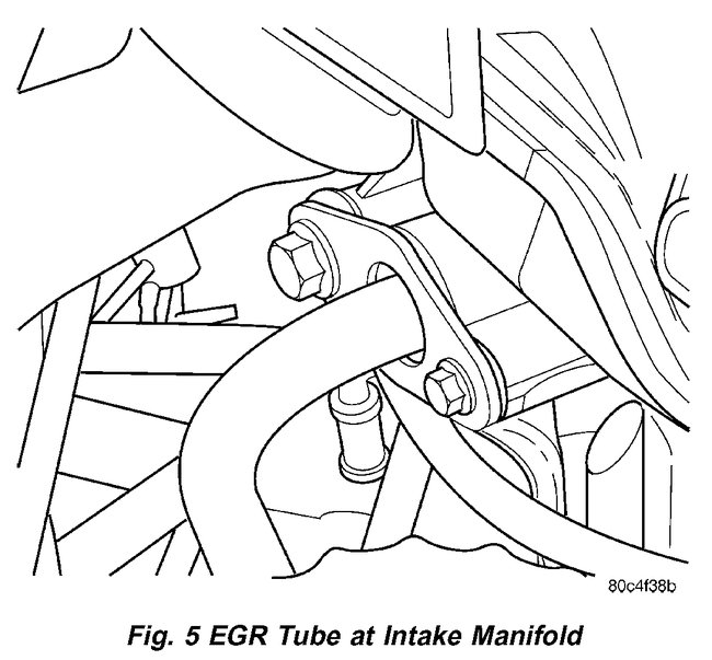

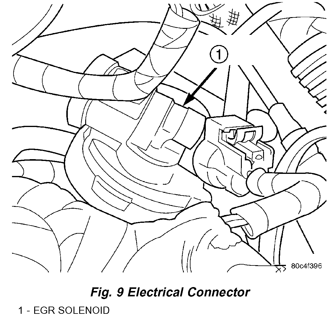

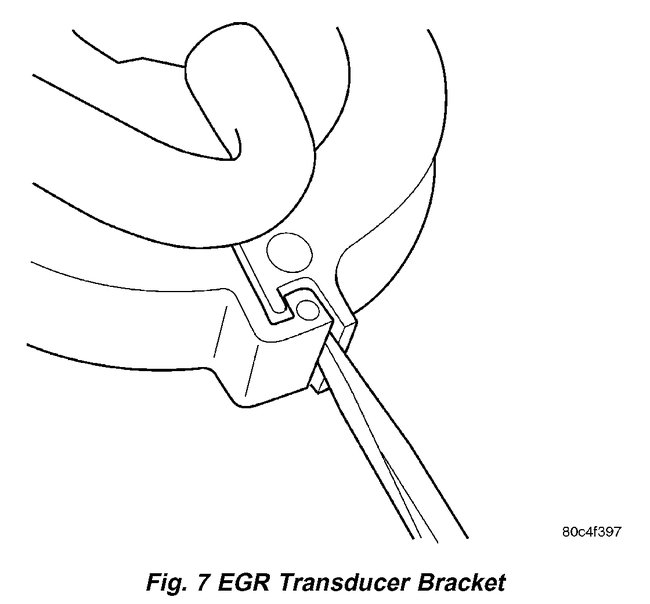

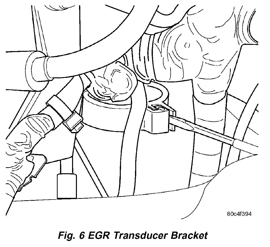

I am getting a code for a low flow through my EGR but only when my car reaches normal operating temperature. what could cause this? Can i clean my EGR with out removing it?
Mar 6, 2019 at 8:36 AM
  • CAR REPAIR CONTRIBUTOR
  • 110,190 POSTS
Welcome to 2CarPros.
A few things can cause this problem. If you provide the trouble code you got, I may be able to help you pinpoint the cause easier.
As far as the issue, it could be a vacuum leak to the EGR solenoid, a faulty EGR valve, Carbon Buildup in either the EGR or Intake or restriction in the EGR Tube or other component.
Here are the directions for EGR replacement and the pictures correlate with them. I'm adding this to help locate the part and so you can remove it for inspection.

EGR Tube At Intake Manifold
3. Loosen the bolts at the intake manifold
4. Remove EGR tube bolts at EGR Valve.
EGR Transducer Bracket
5. Unclip EGR transducer bracket, and remove from bracket.
Fig.8 Vacuum Hose
6. Disconnect the vacuum supply hose to EGR transducer solenoid.
Fig.9 Electrical Connector
7. Unlock the connector then disconnect the electrical connector from solenoid.

Thank you, I am getting a p0401 code and a p0403 code.
Mar 7, 2019 at 3:36 AM
  • 110,190 POSTS
Welcome back:
Before you replace the EGR, confirm there are no vacuum leaks to it as well as check the electrical connection to it for corrosion or damage to the wiring. If everything looks good, remove the EGR valve and inspect it to see if there is anything causing it to stick open. Carbon or even wear can cause it to stick. Also, make sure where it mounts to the engine, it is clean and no carbon build up.
Let me know what you find or if you need help.
