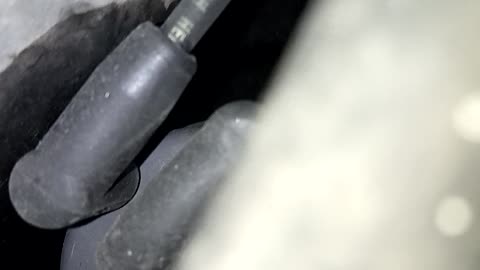

I'm looking for the EGR valve hose and electrical connector. my truck doesn't have the EGR and I want to replace but can't figure out where everything goes.

1996 shouldn't have EGR. Dodge removed them on the Magnum engines when they switched to the OBDII system. They returned a few years later on some engines though.
If you have a late 1995 sold as a 1996 the EGR will be on the label under the hood, and you will have a tube coming from the passenger side exhaust manifold up to the EGR valve mounted on the intake manifold. There will also be a transducer connected to a vacuum line on the manifold and inline with the EGR to the throttle body.

Thank you. mine is a v6 3.9l. I'll send a video I took. I'm pretty sure mine had an EGR valve but maybe not I know the bare minimum about vehicles. There are 3 holes behind the throttle body next to the distributor cap in the video you'll see the holes, but I can't find the electrical connector or the air hose that it connects to.

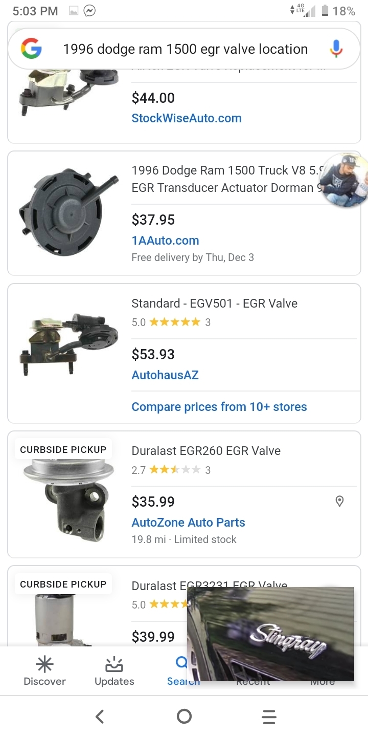

I need this 1.

That is what they used for the manifolds, they were the same parts they used on the earlier 3.9 and those had EGR. on the 1996 the system was eliminated. That is why those holes are not open and the outer ones are not threaded. There are a few other ways to tell, if the vehicle had EGR from the factory, it will be on the emissions sticker under the hood, and if it had EGR but someone removed it, the check engine light would be on as it would set a few codes. That plus not having the wiring connector or the manifold with the EGR tube or a plugged hole for it are others. If it was built without EGR you cannot add it as the ECM wouldn't be programmed to use it and it will set other codes because of that. Plus if someone has removed it and re-flashed the ECM to remove the codes and programming you would need to reverse all of that for it to work. As for the parts being available, they were used in other applications, just not yours.
