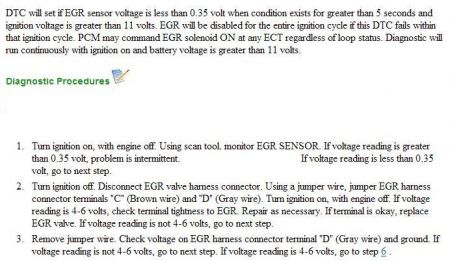

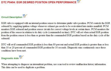

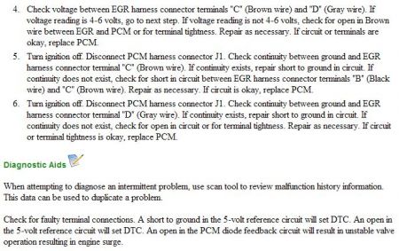

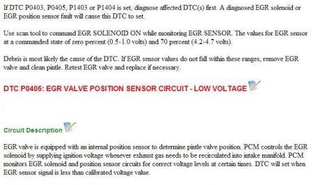

my code is p0406 p0404 and can not find info on it to repair and get engine light off. what is it and where to get parts?
Mar 1, 2009 at 11:51 AM
OBXAUTOMEDIC
  • 3,715 POSTS
Hello, Here are the code defs..... P0404 Exhaust Gas Recirculation Circuit Range/Performance P0405 Exhaust Gas Recirculation Sensor A Circuit Low P0406 Exhaust Gas Recirculation Sensor A Circuit High It is located on the passenger side just below and behind the alternator. It looks similar to the pic below...
