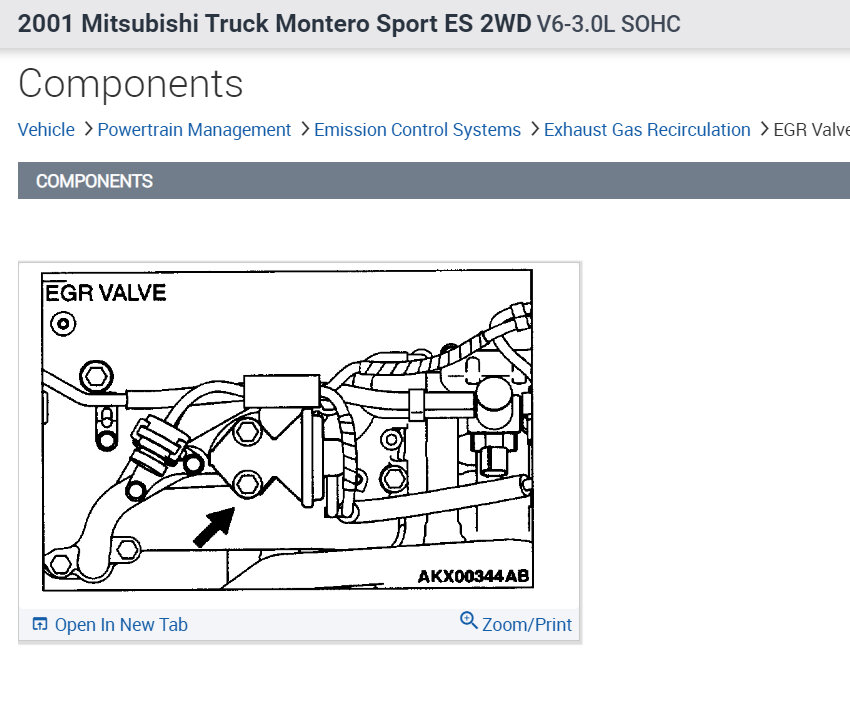

Where is the EGR Valve located?
2001 MITSUBISHI MONTERO
120,000 MILES • 3.0L • V6 • 4WD • AUTOMATIC
RICHSYO
Where is it located? Code check electrical connections? may it be open or closed?
Mar 31, 2023 at 2:01 AM
  • 55,421 POSTS
The EGR valve should be closed normally. Here is a video to help you run a test and the EGR valve location will be in the images below. It looks like it is mounted to the intake manifold.
https://youtu.be/DqUCbbKdWf4
