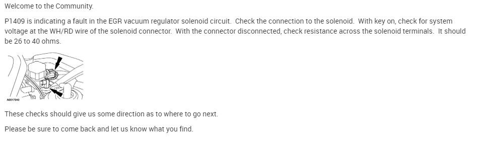

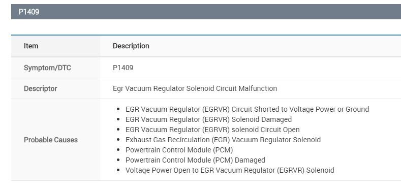

Hi, i got a code p1409 so i changed the EGR solenoid. drove car 150 miles and code still on.
Nov 20, 2019 at 2:30 AM
Experienced Mechanic
52,796 POSTS
Good afternoon,
The code indicates a circuit issue with the EGR solenoid circuit.
I posted some checks below for you to do and let me know what you find. This could be a wiring issue or PCM.
