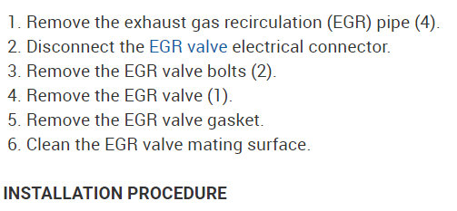

Replaced EGR valve and hose and it has a little white smoke coming from underneath it.
Dec 4, 2020 at 10:50 AM
DANNY L
  • 5,648 POSTS
Hello, I'm Danny.

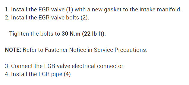

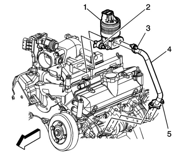

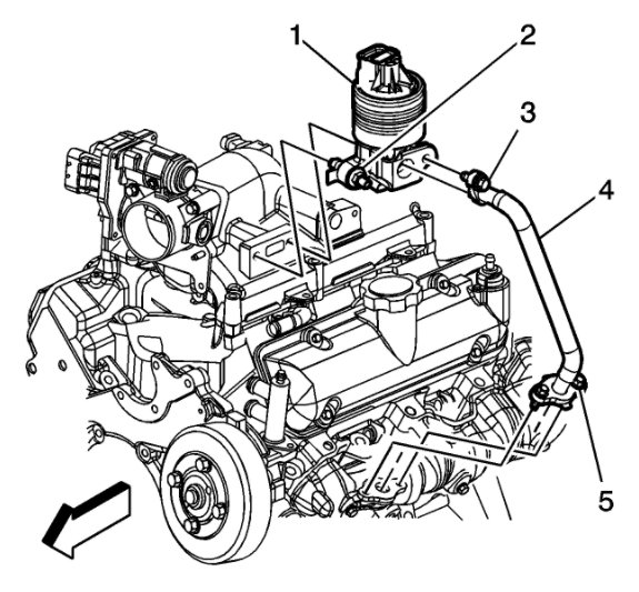

Did you use new gaskets and tighten the bolts to the proper torque on the EGR valve? I've attached picture replacement steps below. Hope this helps and thanks for using 2CarPros.
