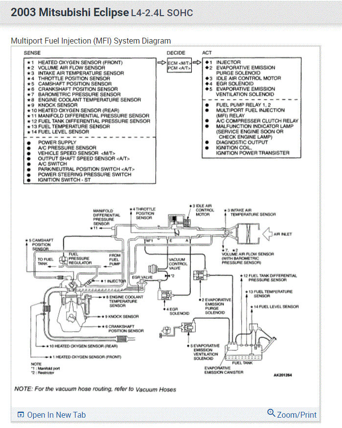

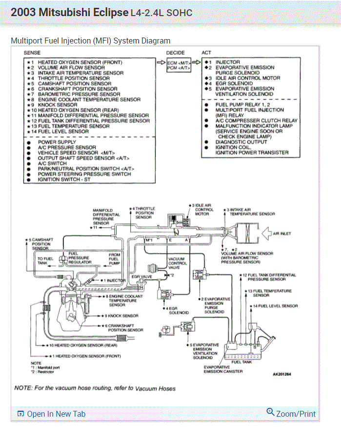

I need a diagram for my car listed above gs model EGR vacuum hose diagram.
Jun 7, 2021 at 3:10 AM
  • 110,244 POSTS

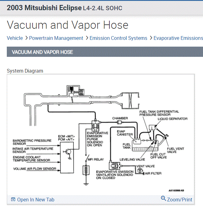

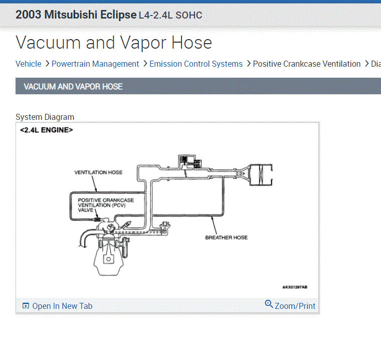

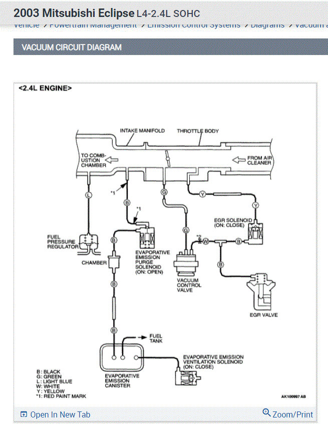

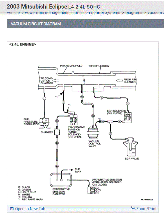

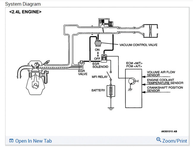

If you look below, pic is the vacuum diagram specific to the EGR. I added the other schematics for you so you have a reference.
Jun 7, 2021 at 2:28 PM

What I attached above is what's in my manual for a 2.4L. Do you have something different?
As far as replacement, what I always do is this. Simply locate one hose at a time and replace it with the same size hose. Take a look at the car and determine the diameter. Most are around 1/8", 7/32", and so on. You can purchase it by the foot at most parts stores, so before removing anything, try to determine how much is needed. Then, remove one at a time and replace it with new.
That is how most any shop would do it for you. I'm here to help if you run into trouble.
Let me know what you decide and if there is anything I can do to help.

Well, the thing I'm struggling with is a friend of mine went through and changed the valve cover gasket when he did that, he removed some hoses he thought he put them back correctly. But my car is not running the proper way anymore like it was before so I can't really go that route with what you're recommending I wish I was the case I'd be a whole lot easier but I'm pretty much flying. Blind at this point and I really have no idea and I can't find anything at all in regards to any kind of hose routine diagram or anything of that nature.

If there isn't a vacuum schematic on a label under the hood, let's try it this way. Tell me which hoses are in question and what each end is attached to. For example, one of the hoses is at the EGR valve and the other goes to the throttle body. Hopefully, I will be able to help you get them fixed. Be as specific as possible.
