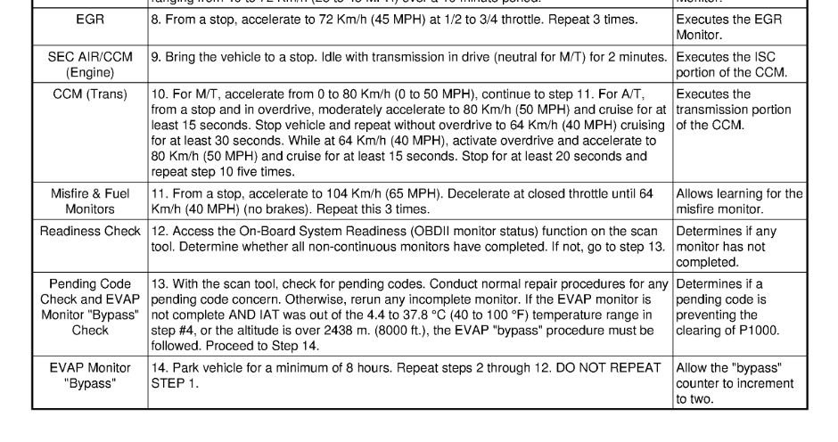

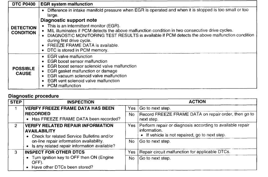

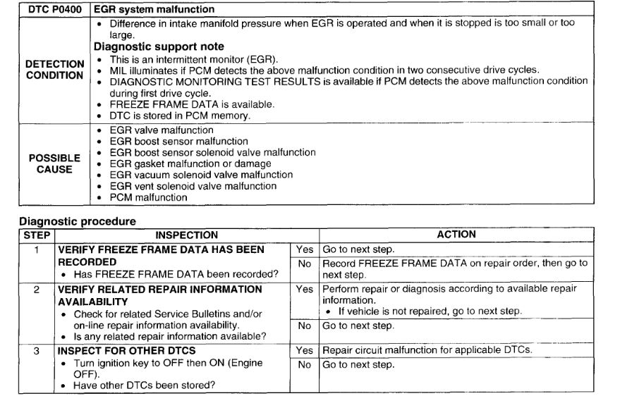

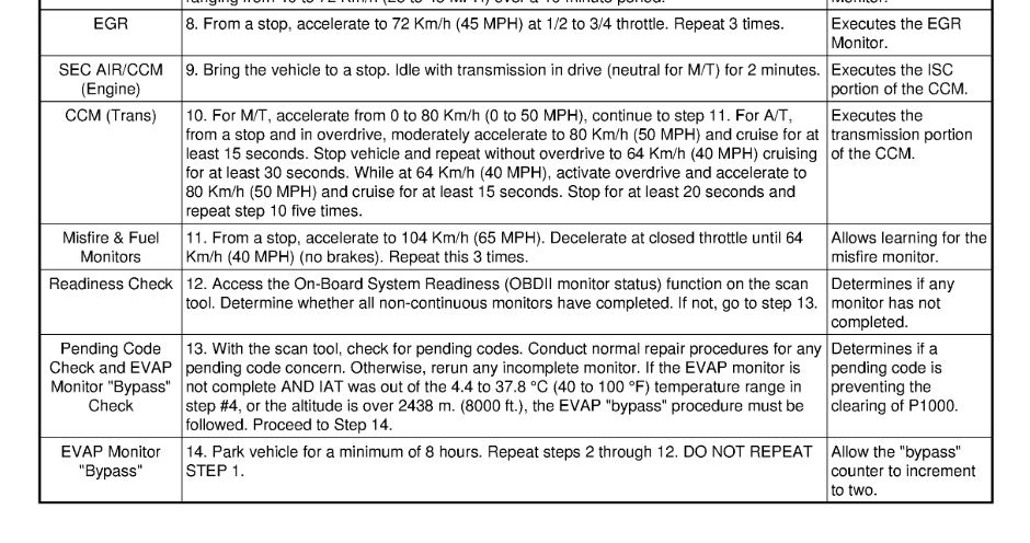

EGR replaced, EGR solenoid/motor also, check engine light remains,
Oct 3, 2018 at 6:32 AM
Experienced Mechanic
52,796 POSTS
Good afternoon.
Lets start with the code as there are many EGR codes?
Oct 3, 2018 at 6:58 AM
RICHARD BROOKS
MEMBER
3 POSTS
Code po400 fault in flow of EGR for predetermined period of time.
Oct 4, 2018 at 6:06 AM
RICHARD BROOKS
MEMBER
3 POSTS
Code PO400.
Oct 4, 2018 at 6:10 AM
52,796 POSTS
I attached the flow chart for the code. You will need a scan tool to perform this to determine the failure.
