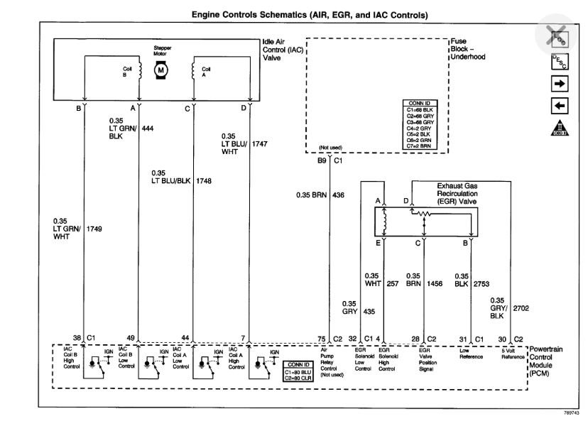

Pintle Position Sensor? manual says should read .6 to .9 volts but I am getting 4.96 volts. I cannot seem to find any information on what that reading means. I know a high read there means valve could be stuck open but I get that reading on the brand new one as well. (this test was KOEO red lead to wire c and black to ground)
The ground test also gave a reading that I cannot find any information about.
Ground test- (KOEO red lead to battery positive black lead to wire a) manual says I should read 10 volts to 12 volts here but I am getting 7.33 volts. I need to know what to look for next. I am at wits end.

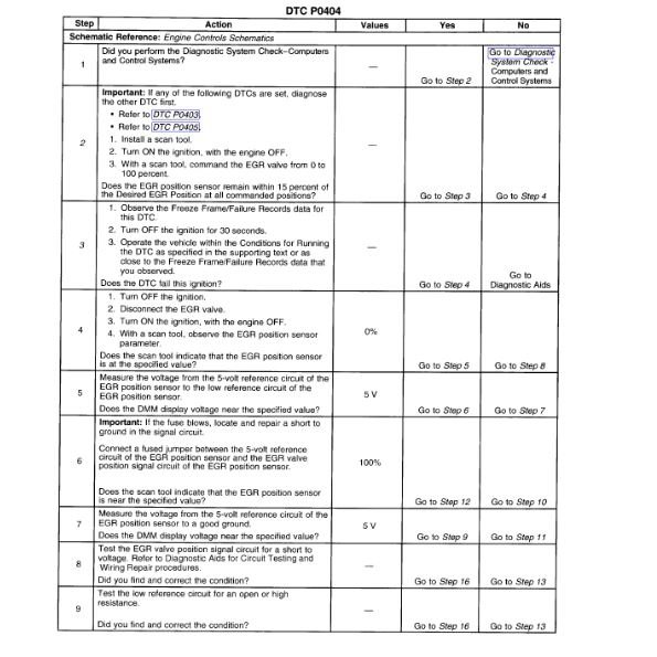

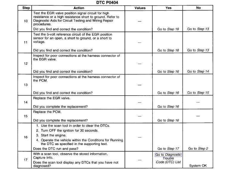

Did you remove the valve and run the engine? You should have loud exhaust and a large vacuum leak.
I attached a chart for you to view that is the diagnostice for the 404.
Jul 25, 2018 at 2:06 AM
RJW92458
yes, EGR off car car has huge vacuum leak and runs rough and stalls. Tube to exhaust clear also. Thanks for the charts and the quick response. I will go back out with these and look at more things. If you happen to have a wiring diagram for this it would help me out.
Jul 25, 2018 at 2:19 AM
Okay, sounds good.
Wire diagram attached.
