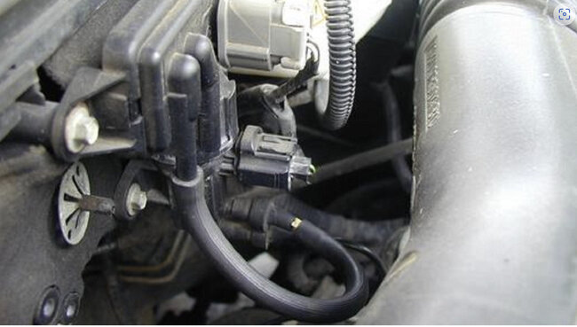

I’ve been trying to locate the EGR pressure sensor on my truck listed above SD. I already have the new part but can’t seem to find where it’s located to replace it.
May 3, 2023 at 5:54 AM
BRENDON S
  • 653 POSTS
Hello GHOSTCOOKIES,
It should be on the firewall. I have added a picture for you. Looks like it's behind an intake pipe possibly in the center.

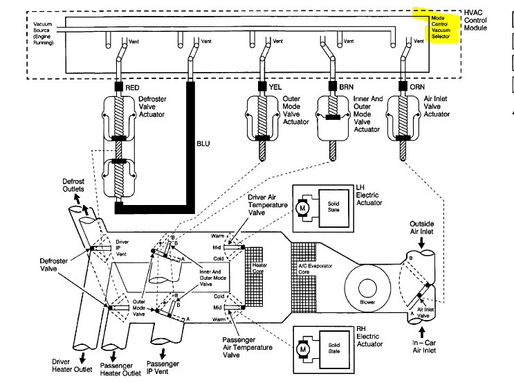

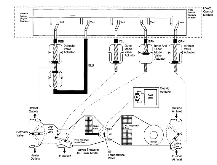

A/C stuck on defrost and floor. I'm looking for the heater vacuum control manifold. (Under the glove box?) Vacuum lines have been checked.
May 4, 2023 at 5:24 AM (Merged)
  • 110,248 POSTS
I believe you are referring to the vacuum control switch. That is the component that is adjusted to change the airflow direction mounted on the dash.
I attached two pics below. The first one is the vacuum schematic for a standard unit. The second schematic is for a dual climate control system. I'm not sure which you have, so I attached both. Also, here is a link you may find helpful:
https://www.2carpros.com/articles/air-vents-stay-in-the-defrost-position
