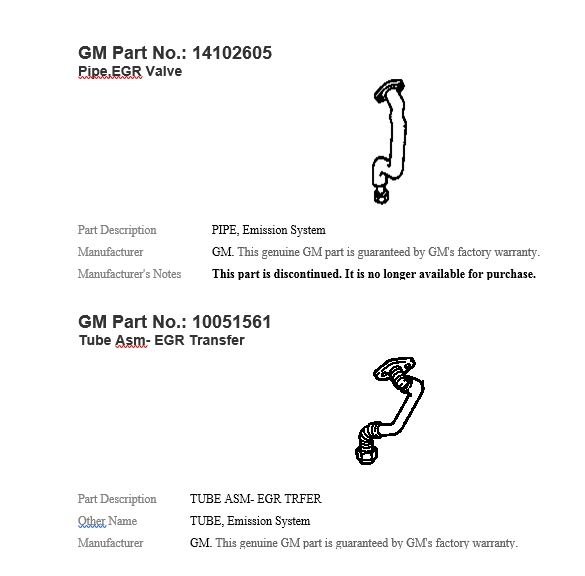

EGR pipe assembly discontinued. Part original part broke in half what do i do?
Part number is discontinued 14102605.
Bought wrong part 10051561 off eBay that did not fit my vehicle and pipe could not pull out further.
Do not know if anyone can fabricate me a new pipe because my old one is cracked and is apart.

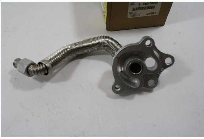

I found this!
https://www.ebay.com/p/NOS-GM-OEM-EGR-System-Tube-and-Valve-Assembly-10100090-F-1992-1993-V6-Chevy/654837495?iid=222678777974&_trkparms=aid%3D222007%26algo%3DSIC.MBE%26ao%3D2%26asc%3D50544%26meid%3Daba847eafaff4c1b91193f8e8f96481b%26pid%3D100011%26rk%3D3%26rkt%3D5%26sd%3D191633140698%26itm%3D222678777974&_trksid=p2047675.c100011.m1850

Part 10051561 does not fit my car.

Okay.
What about the one in the first link I posted?

That would not fit because it has a different adapter end that connects to the EGR control valve. Here is a picture.

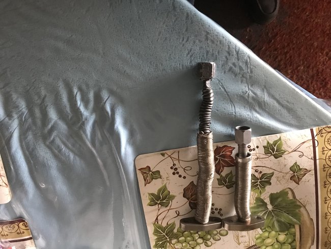

How about a picture of what you have?
The Medic
Apr 30, 2018 at 12:14 PM
COOLOLDS85
  • 173 POSTS
One on the right is wrong part I sent back. One on the left is the original I need that will fit with being the right length.

I apologize loaded the same pictures three times.

Looking at your pictures (way above).
The short one on the right.
Is it in the "relaxed accordion" state/ position.
Will it "stretch out" to be as long as the one on the left.
Thought maybe the correlations were stacked tight as with a bendable drinking straw.
The Medic
May 2, 2018 at 8:37 AM
COOLOLDS85
  • 173 POSTS
Yeah, I tried bending it but could not really extended it any further because I did not want to break it. I tried every position with the one that did not fit.
May 2, 2018 at 9:02 AM
CJ MEDEVAC
  • 11,004 POSTS
Answer above, "correlations" was supposed to be "corrugations".
Do the corrugations look like they are close together and they would stretch out to look like the original?
If they are close together and look like the would stretch on out.
My approach might be to drop two sacrificial bolts through the flange and then grab the bolts threads only, in a vise.
I would take a big crescent wrench and snug it up on the tube just below (and against) the nut on the other end of the tube.
If you could then pull it by the crescent wrench.
Maybe a slow pull, by cutting a block of wood to fit from the top of the vise and under the wrench might give you some "prying" leverage. If needed stack more goodies on to of the block of wood to continue the stretching process.
Just a thought, throwing some straws, I cannt see the actual problem from here!
