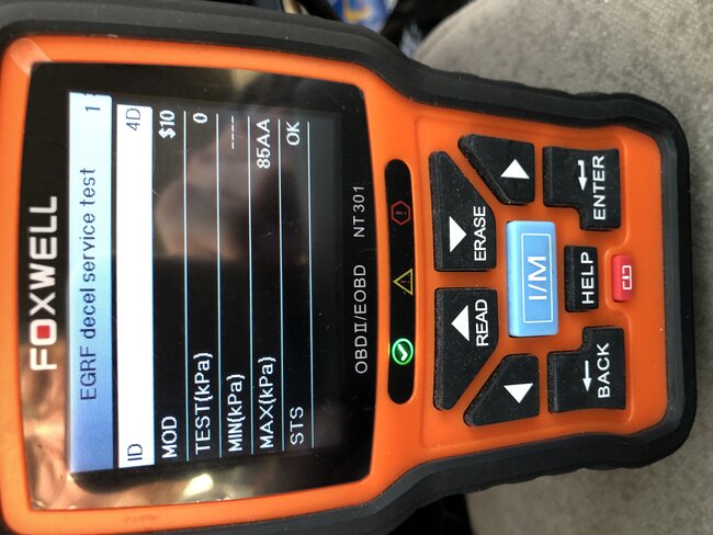

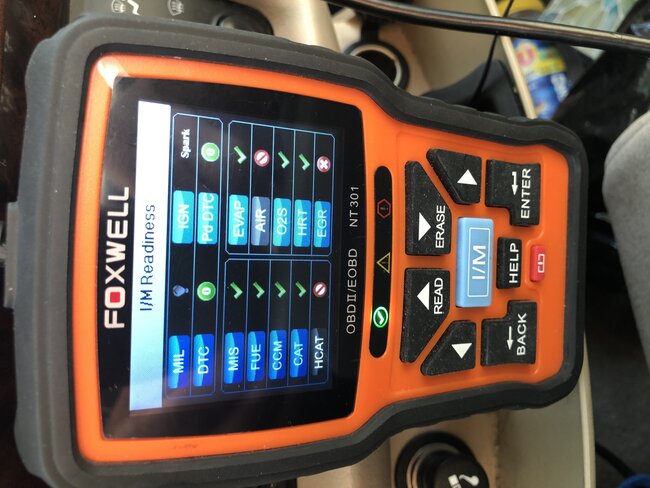

A new EGR valve was installed (Battery was disconnected and connected) about a month ago. This car is driving about 100 miles. The OBD II shows green check, all items are okay, but the EGR shown with red X check on it (EGR Incomplete). Please let me know what about this, and how to fix it. Thank you very much with the best regards.

Is the check engine light on? Any codes present would give us clues as to how to combat the problem. The EGR readiness monitor will not be complete until it meets every criteria for your particular system. Please see below the details regarding your particular system, and take note that this system requires 12 ignition cycles before the PCM makes the decision to indicate a problem is present.

If there are no codes and no check engine light present, the PCM has not detected a problem with the EGR system. Are you checking this before or after driving? I would leave the scan tool plugged in while driving and see if it changes eventually. You may have to stop the car and start it again. But as stated above, the computer will go through the necessary checks every time, and it will only do these checks during a drive cycle, not while idling.
Also, what kind of scan tool are you using?

when I driving,I have lease. The Foxwell OBD II / EOBD NT301 plugged in. please let me know the procedures of drive cycle. Thank you very much.

If there are no codes present or drivability issues, I wouldn't say that there is a problem. The PCM will do the necessary checks every time the car is driven and set a DTC when a problem is detected. Keep in mind the PCM will count 12 drive cycles before deciding to set a DTC following a computer code clear or repair.

All items are inspected. The drive cycle is completed,OBDII monitoring completed, and Smog check Passed this morning. Thank you very much for your support.
