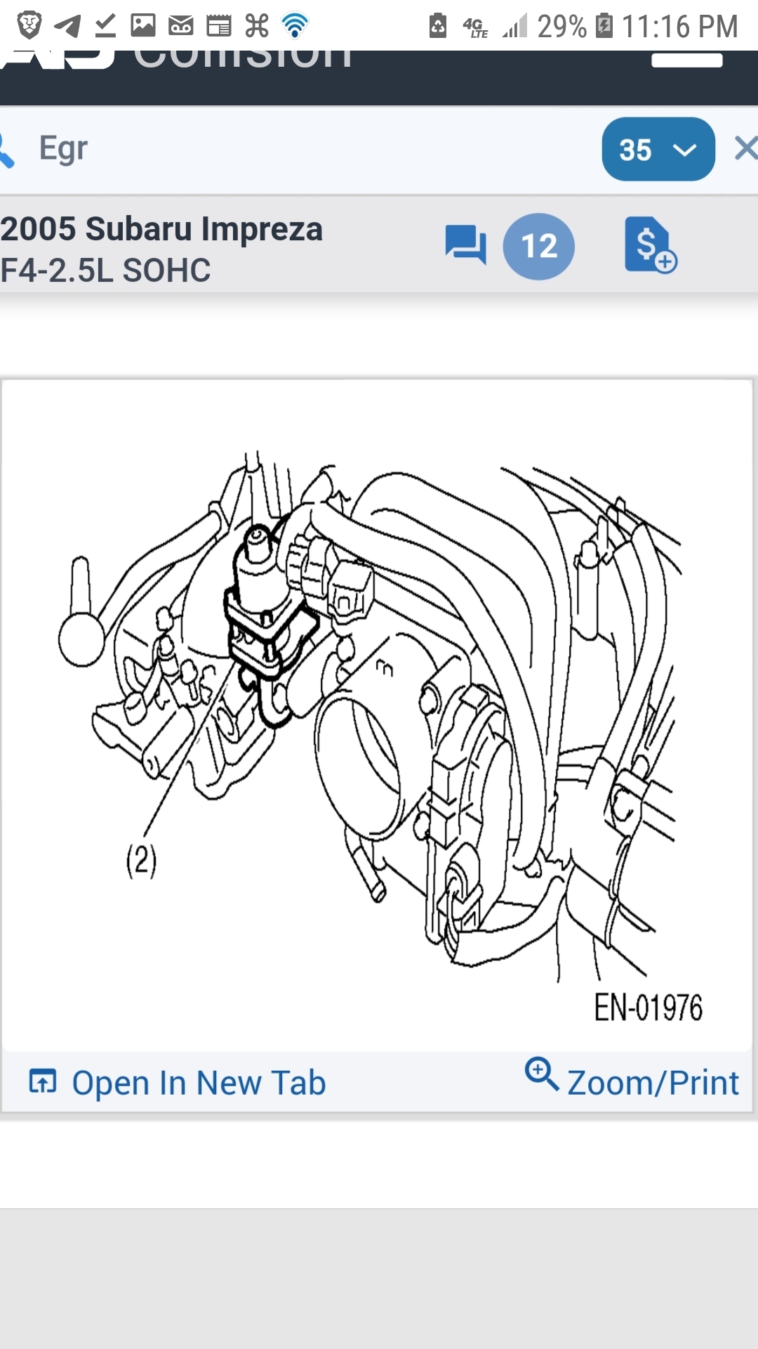

HARRY P
  • 2,292 POSTS

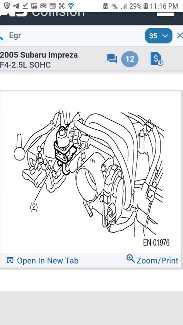

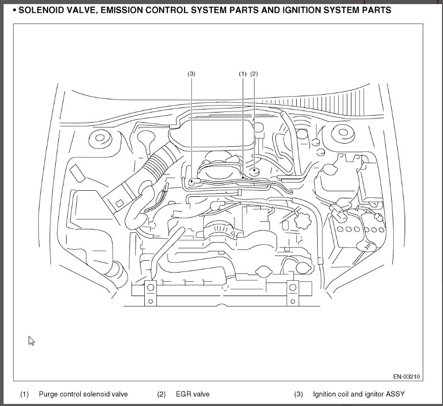

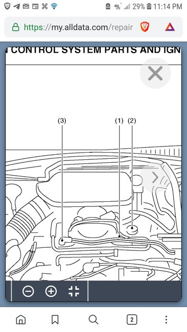

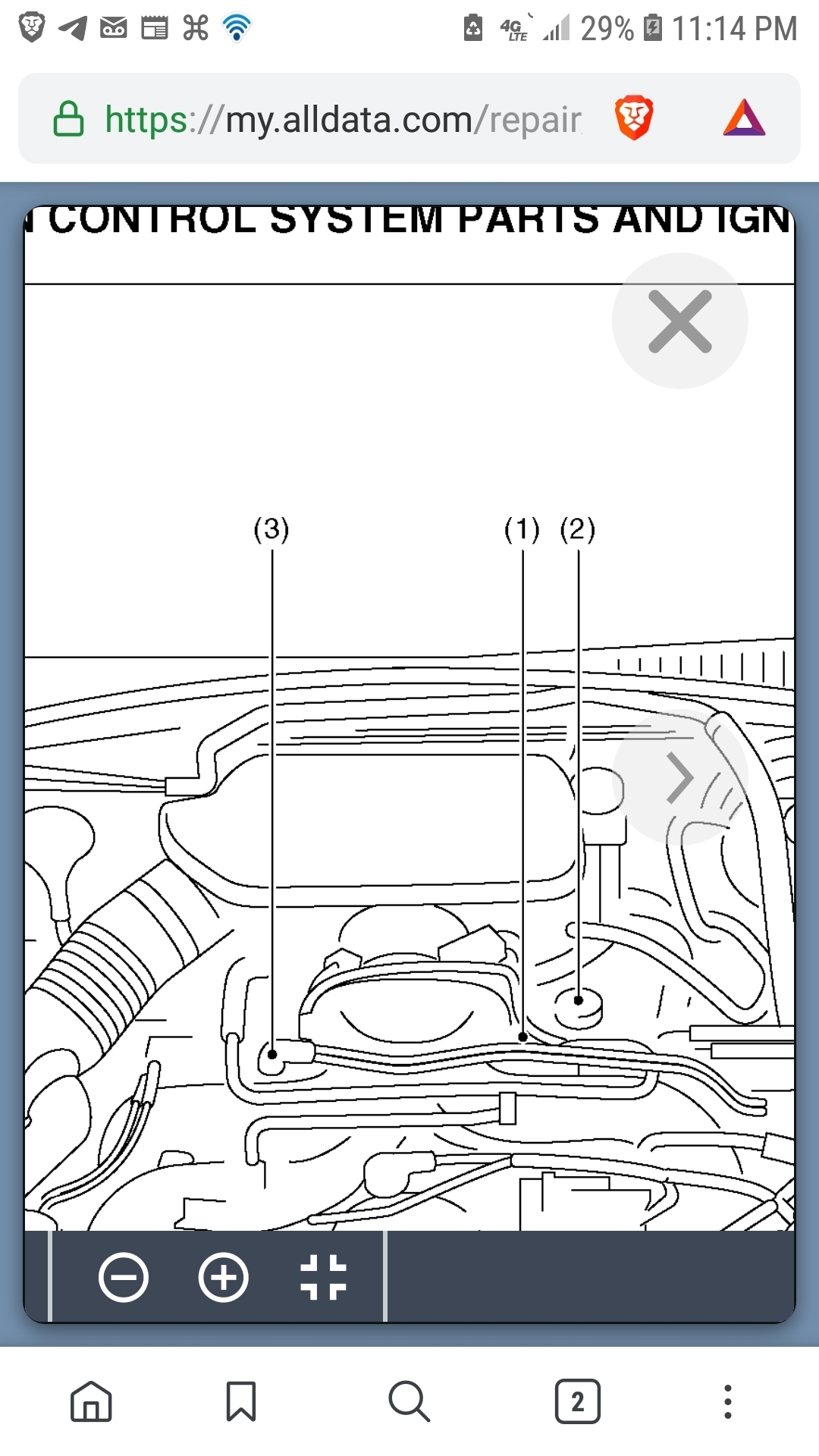

Hello and welcome to 2CarPros. I'm trying to look up your 2004 Impreza, but Alldata is giving me screwy information on 2004. 2005 pulls up fine and gives me proper diagrams. So I'm posting them hoping that it's the same.
In the images below, look for #2. That's your EGR.
I would like to know if you've scanned it yet. Being a 2004, any OBD2 scanner can read codes from it. More expensive scanners can give you a live data mode which can be nice. Take that thing off. Clear it out manually as much as possible. Then soak it in carburetor cleaner. Once it dries a bit, close it up, put it back together, and give it a try.

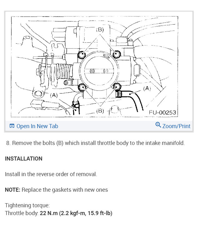

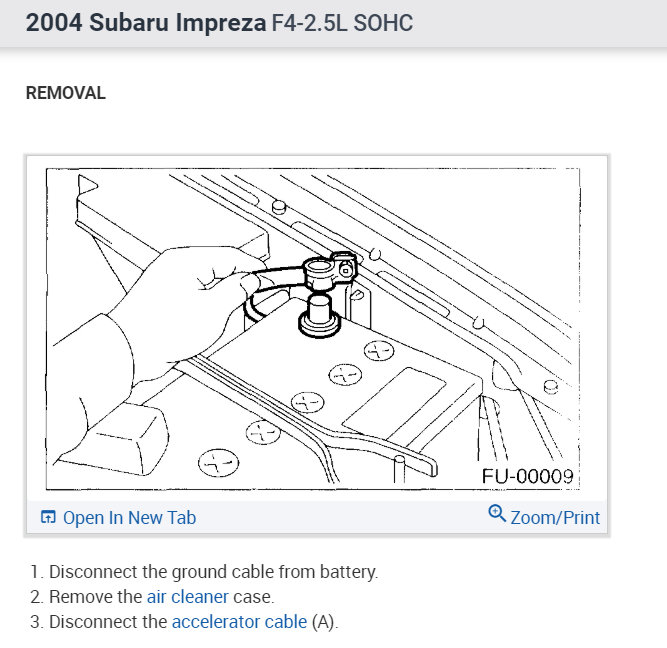

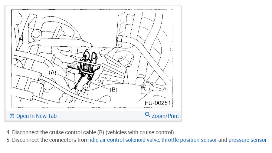

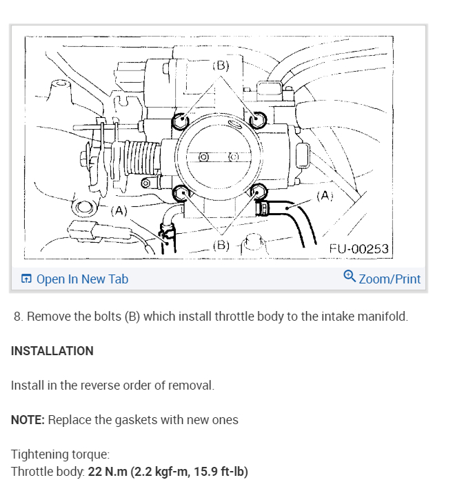

  • 55,616 POSTS
This sounds like the throttle bore needs to be serviced. here is a guide to help you fix the problem:
Sep 29, 2019 at 5:55 AM

Hi Ken,
Hoping that this horrible Frontier DSL stays up long enough to respond here. I did clean the throttle body some time ago. I am still looking for the EGR (a good photo) I had my wife take some pictures of my Impreza engine to send back to you folks if only this internet would stay up long enough to get them to you. I still haven't find the EGR even though I looks like and where I should be looking for it. Thank you all here. appreciate it.

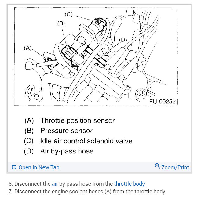

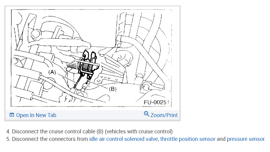

  • 55,616 POSTS

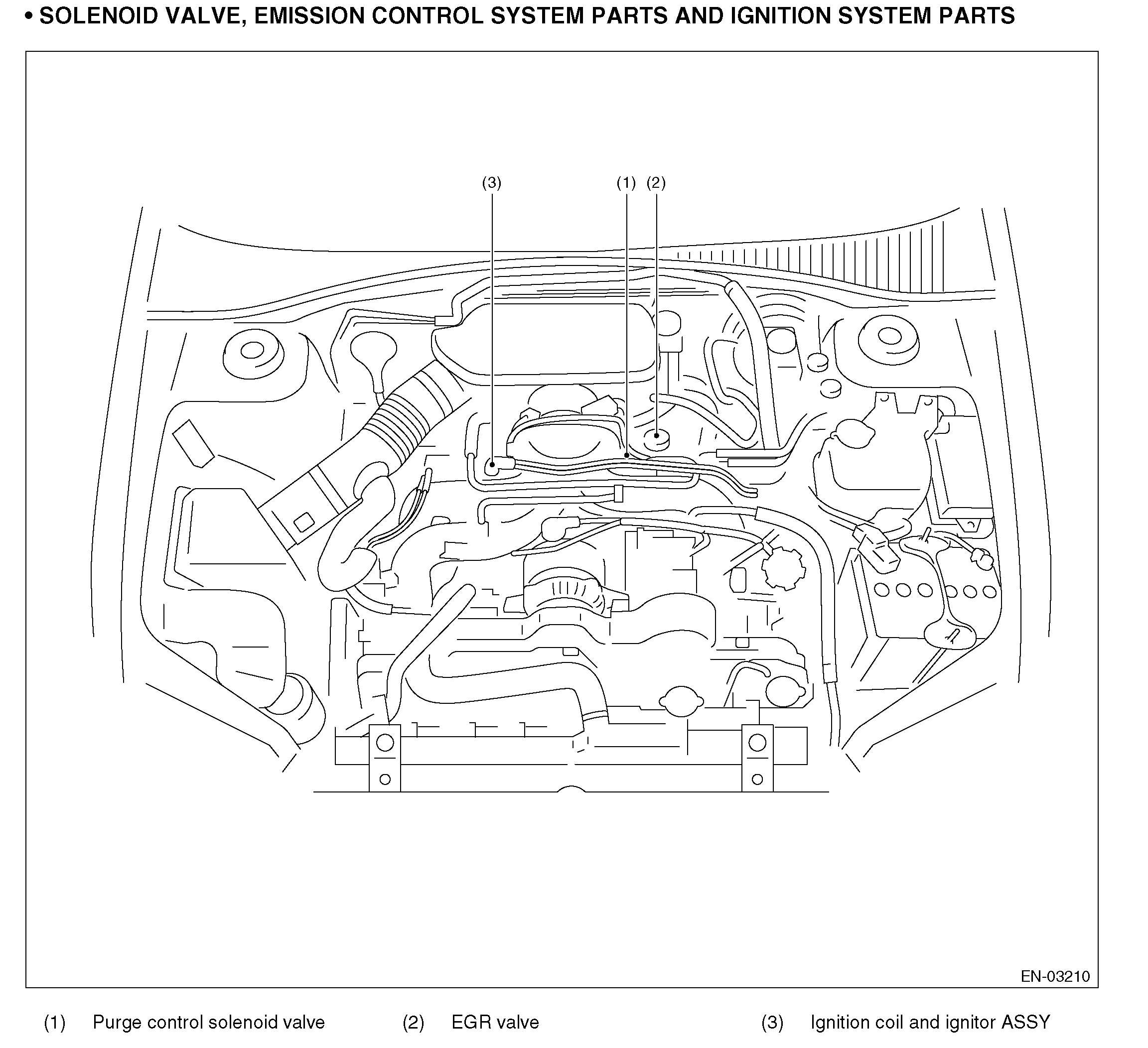

Here is what I found for you. Check out the diagrams (below). Let us know what happens and please upload pictures or videos of the problem.
Oct 3, 2019 at 5:37 AM

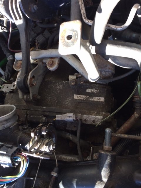

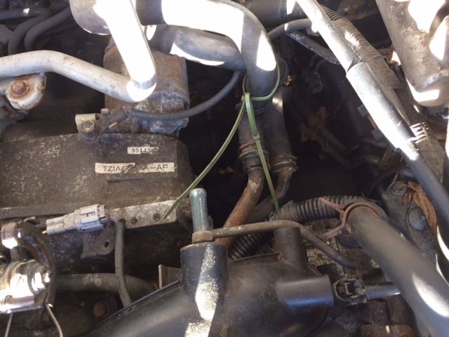

Trying to send zip file with pictures that my wife took from her smart phone. Getting Filetype not allowed. Please help/advise.
Oct 3, 2019 at 11:12 PM
  • 55,616 POSTS
No Zip file, upload them individually.
Oct 4, 2019 at 5:28 AM

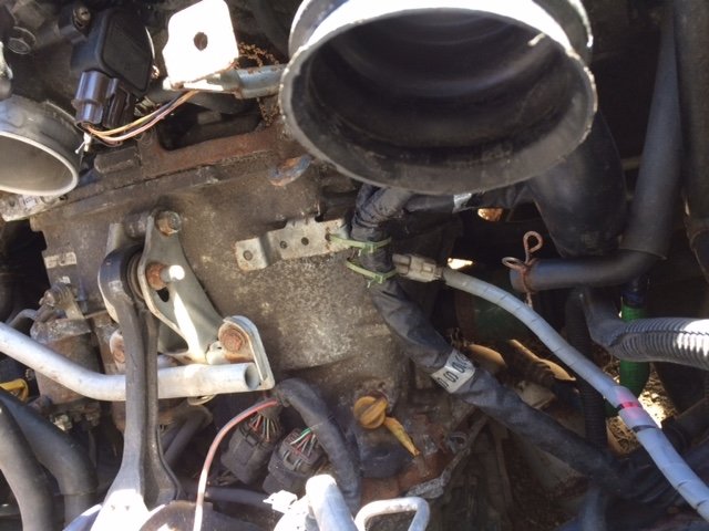

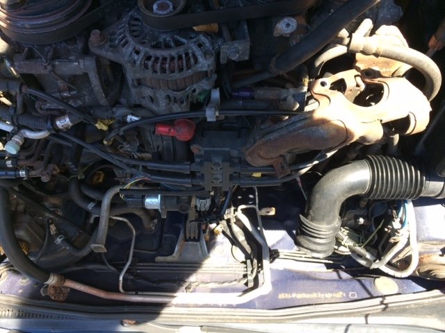

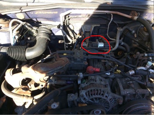

IRASCIBLE51
  • 13 POSTS
I think that I've gotten this (at least for now or until next time). Hope so and hope they are some value as far as what you can see here. I haven't been able to find anything looking familiar.
Thanks,
Bob
Oct 4, 2019 at 11:32 PM
Just to jump in, it looks like it should be to the driverside of the coil. I circled what appears to be the EGR. Its a little far away so I can't confirm but you should be able to follow a line from the exhaust up to the engine. The valve will be attached to that line before it goes into the engine.
Oct 8, 2019 at 8:09 AM

Dear Kase Ken and all here,
I believe this is the idle air control valve. From what I have seen this EGR should be behind # 4 cylinder (behind the engine to the firewall). But I haven't seen anything that looks like what's in the pictures of the EGR from the catalog. AllData can show me no pictures either. I've seen what it looks like on a bench at a shop but can't find that in the car (unless the intake manifold has to be lifted). I've looked for pipes from the top of the engine to the bottom or side of the engine (but I've seen other than two pipes which I think are probably cooling/heater coolant water pipes). This should be very obvious but isn't unless I'm looking is a totally wrong place. Please help...appreciate it.
Bob
Oct 8, 2019 at 11:40 PM
IRASCIBLE51
  • 13 POSTS
This diagram that you have here is from a 2004? I have seen a device that looks similar with a very and obvious round top so I'd safely say.."not on this vehicle" here.
Oct 8, 2019 at 11:46 PM

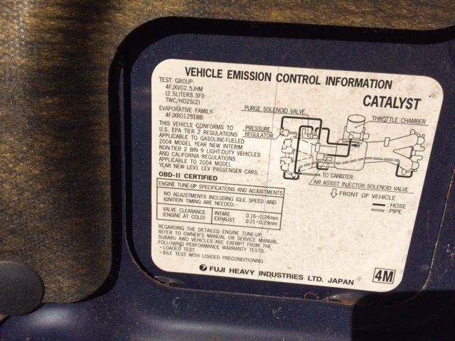

IRASCIBLE51
  • 13 POSTS
There apparently isn't a EGR for this year.
Oct 19, 2019 at 3:41 AM
  • 55,616 POSTS
Sometimes there can be a mid year change which can omit the EGR valve. Use 2CarPros anytime, we are here to help. Please tell a friend.
