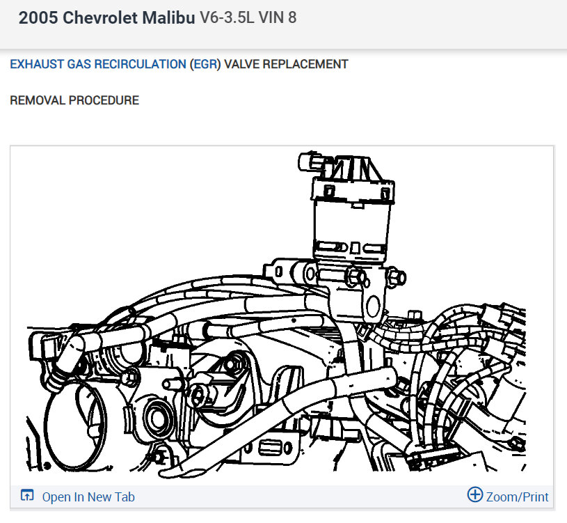

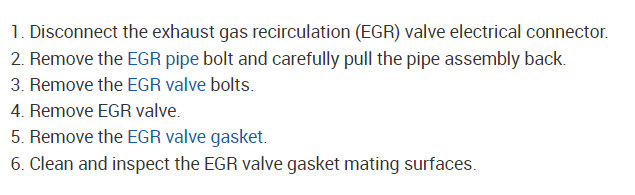

This does not damage the engine, this is easy to find out what is going on, remove the egr valve and start the engine, you should have exhaust coming out of one port and suction from the engine intake manifold on the other. If not, this will be the problem, and the ports will need to be cleaned, which is a super common problem with this many miles. You may need to keep the engines idle up by putting your foot on the gas pedal slightly. Check out the images (below). Please let us know what happens.
