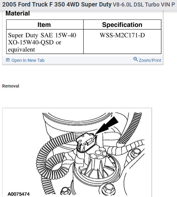

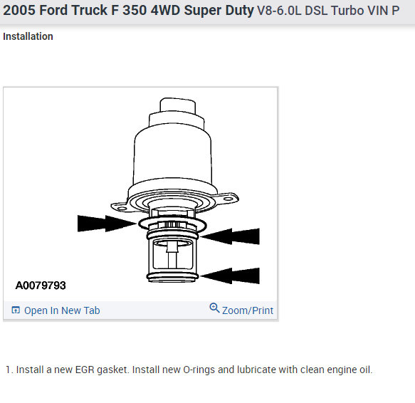

Won't start can the EGR valve stop it from starting?

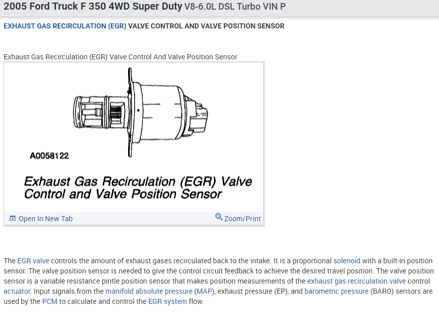

Typically EGR won't keep the vehicle from starting. It can run poorly when you start it if the EGR valve is defective.
Is there any trouble code? If so do you know what they are?
https://youtu.be/vMwTzURWXmk
There could be several reasons for a vehicle to not start.
Could be for lack of fuel or ignition related issue.
Does it crank over?
Here is a video of how to test EGR valve:
https://youtu.be/DqUCbbKdWf4
Here is a helpful article:
https://www.2carpros.com/articles/engine-stalls

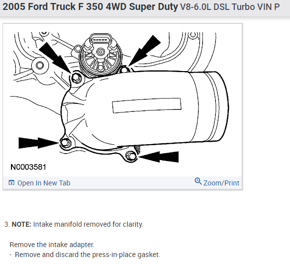

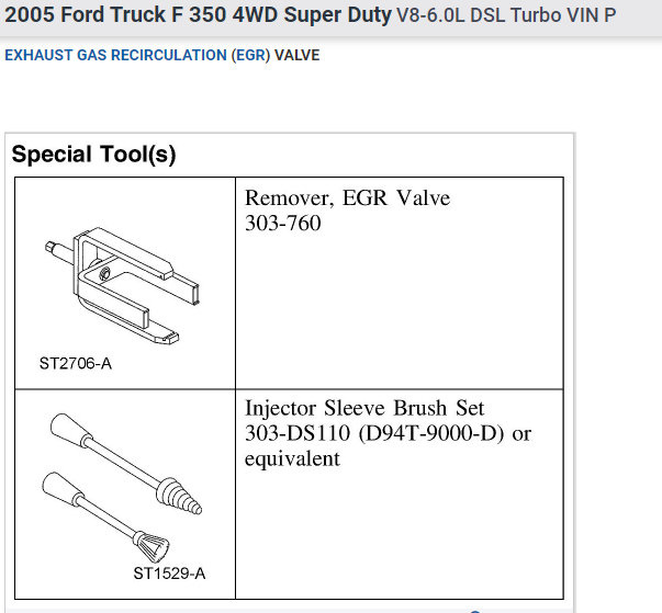

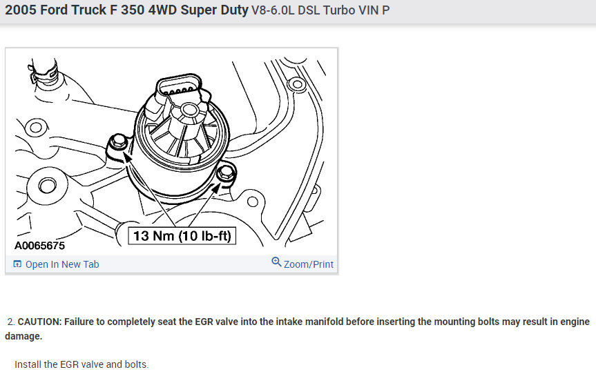

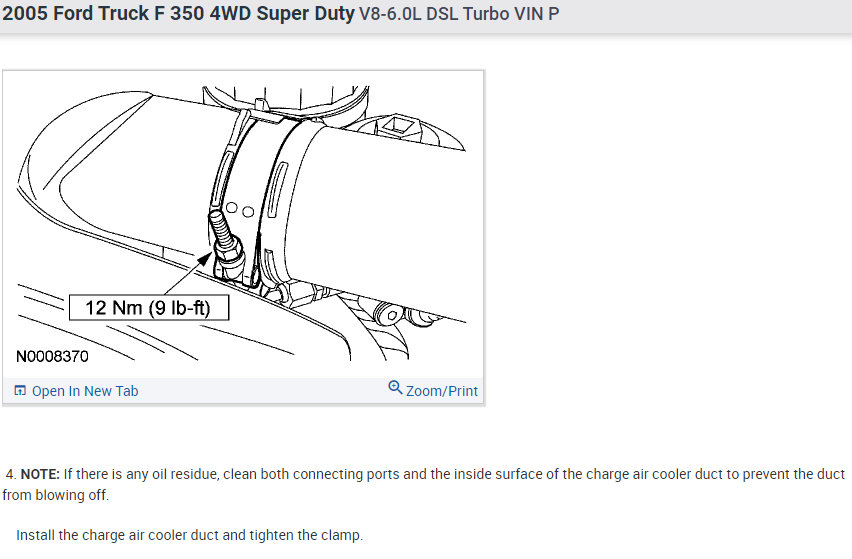

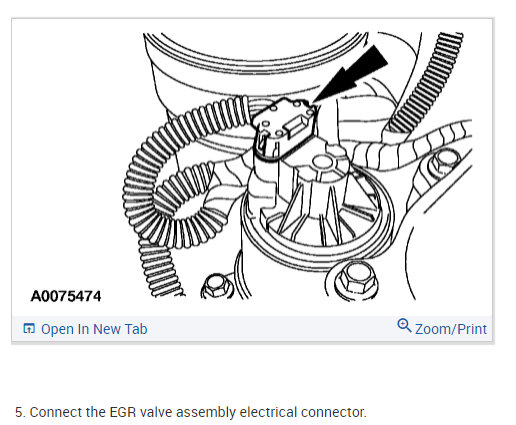

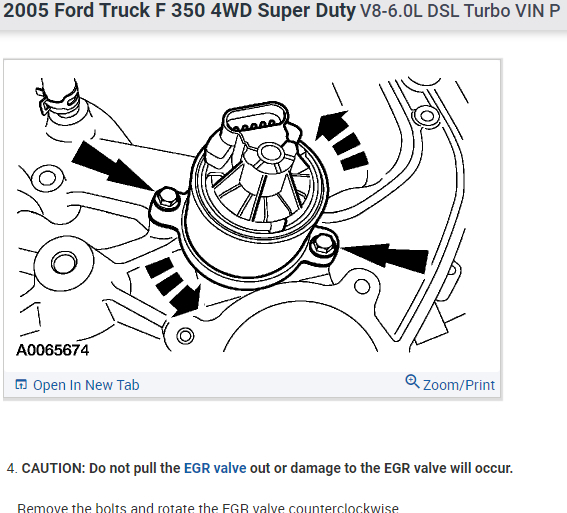

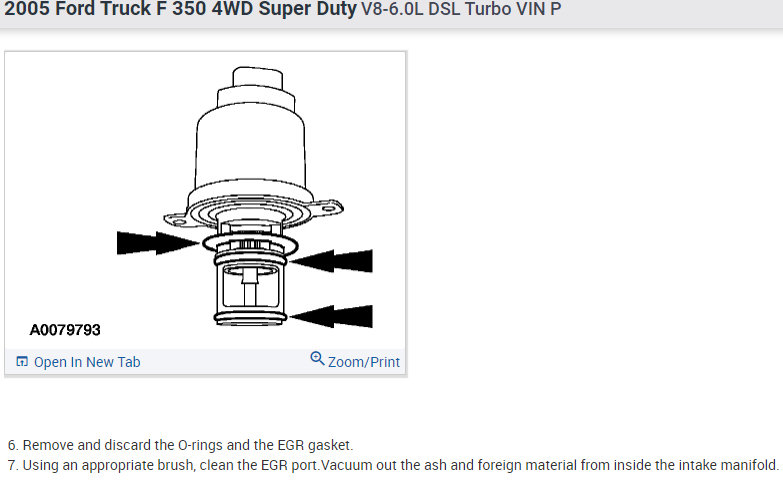

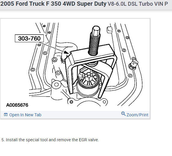

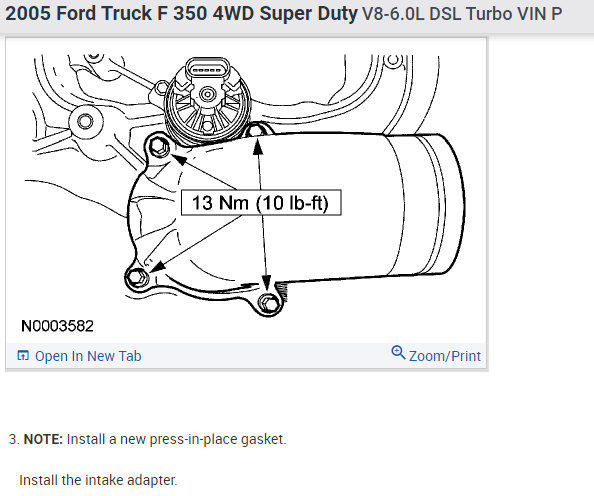

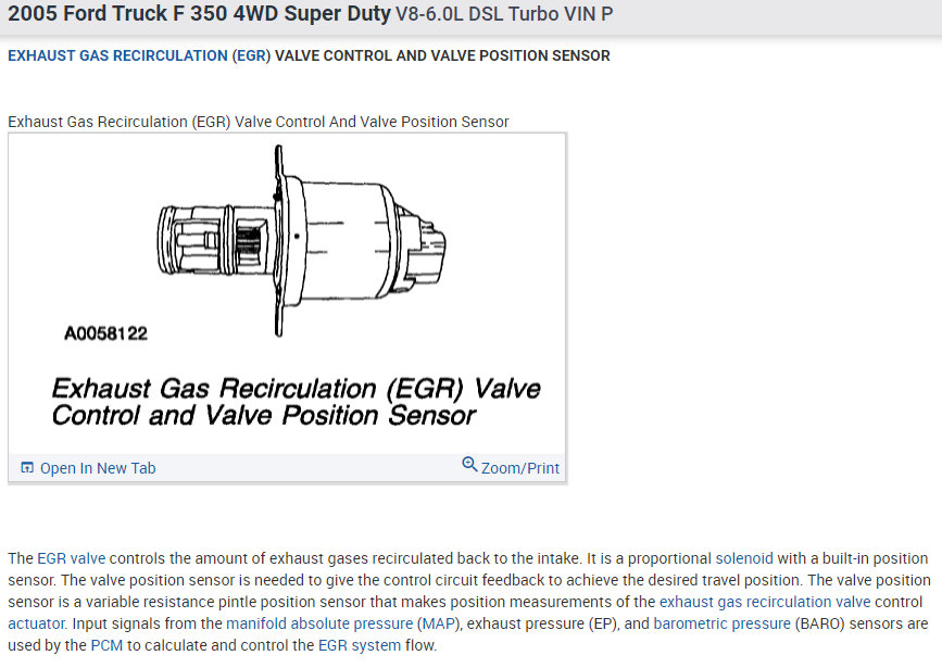

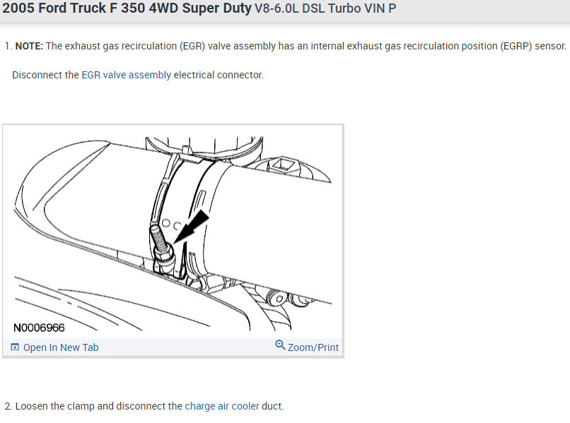

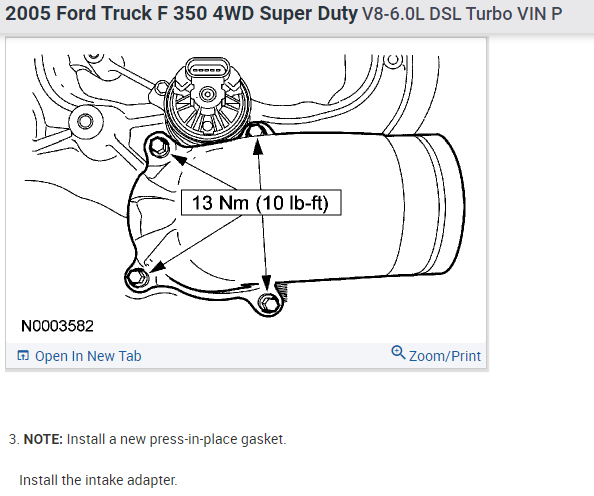

I have attached the EGR replacement procedure.
