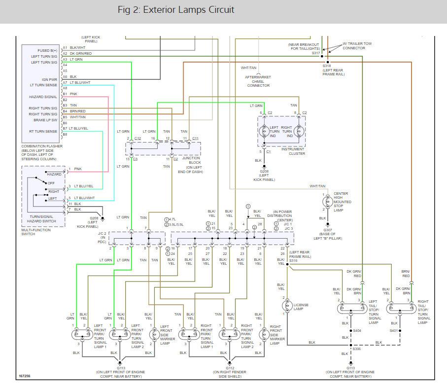

I bought a used 56049114AC combination flasher and I would like to see a schematic of it to know hoe to separate the rapid-flash-needed detection from the turn signal output and add a simple voltage divider resistor circuit to get rid of rapid flash detection. You have a wonderful Exterior Lamps Circuit diagram which shows all the in/outputs. Do you have a schematic for the 56049114AC Combination Flasher?

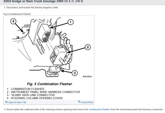

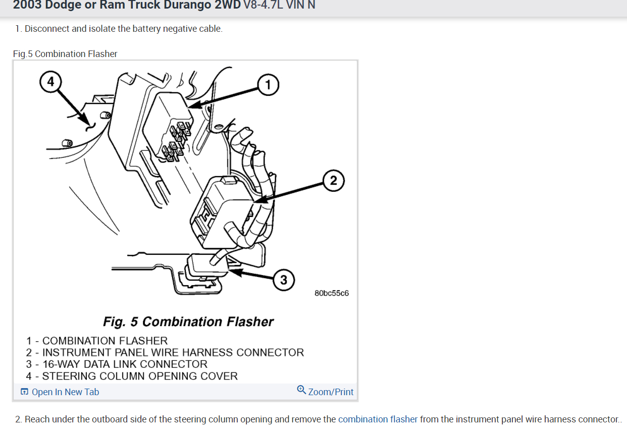

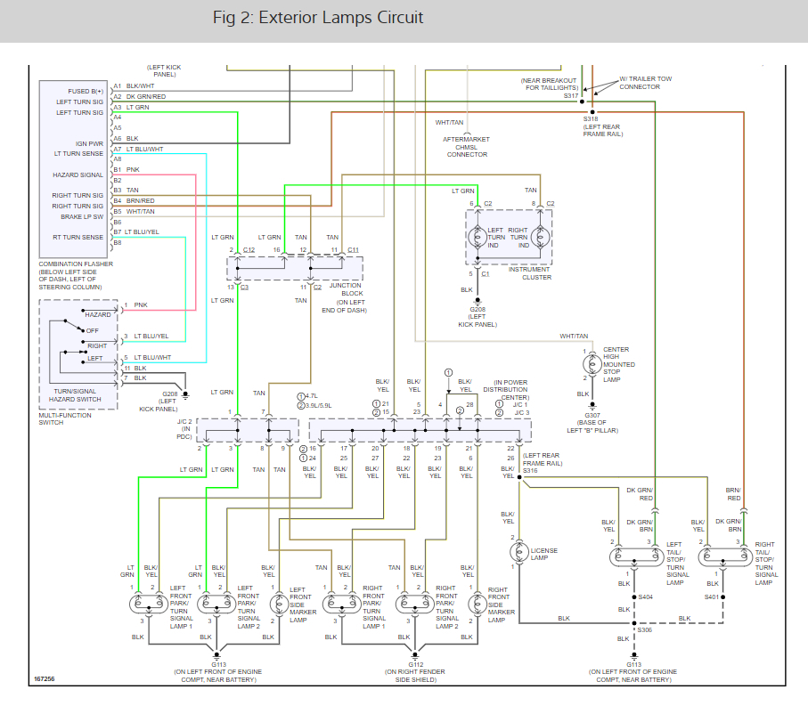

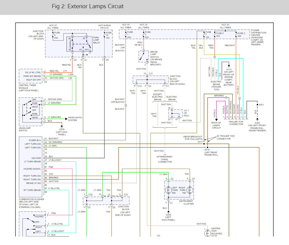

here is the turn signal flasher location with the wiring diagrams so you can see how the system works along with a guide to help check the wiring.
Check out the diagrams (Below). Let us know what happens and please upload pictures or videos of the problem.

Hi Joe,
thanks for the wiring diagrams I had a pinched wire to the flasher all fixed!@
