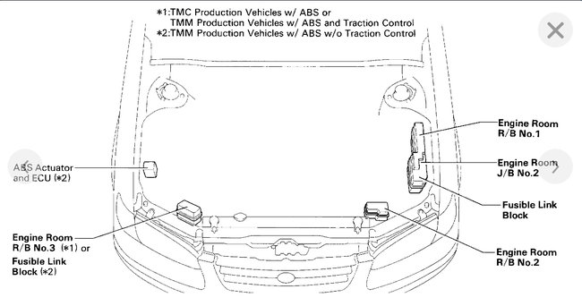

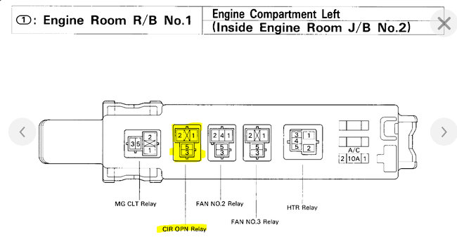

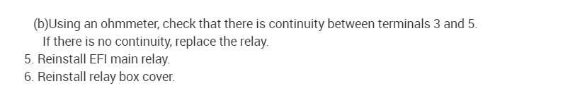

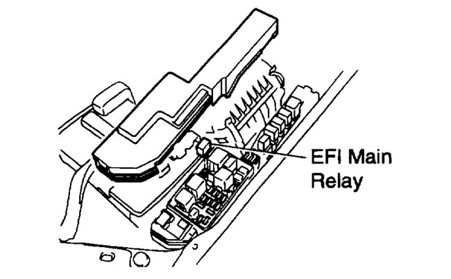

I have replaced the fuel pump and filter and it is still cutting off at idle and at speed. I have purchased two EFI relay switches from the dealership. The diagram on the underside of the cover of the fuse box, driver side fender wall, seems to be incorrect? I am no mechanic but the location on the diagram seems to be random. I do not have an owners manual. I pulled the relay from the diagram location and it has a different part number, and plugged the new one in and it didn't solve the problem. What i need is the exact location on the fuse board of these two relay switches for the EFI. I am shooting in the dark at this point. Thank you and my name is Charlie.

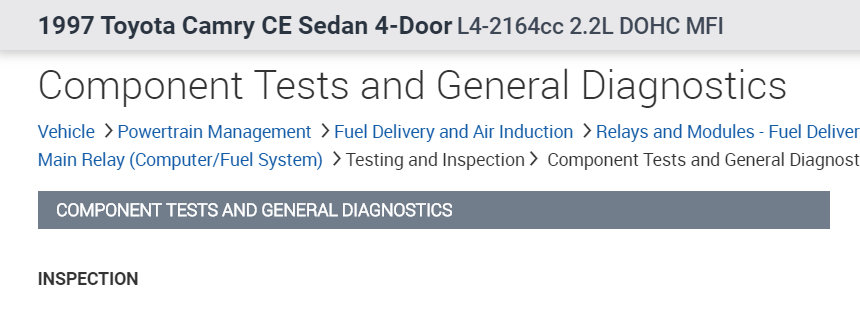

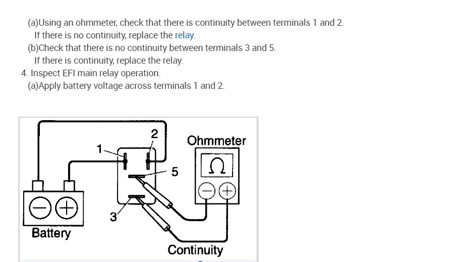

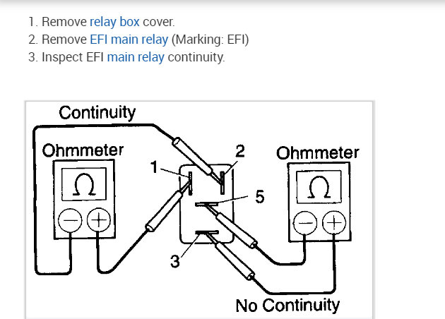

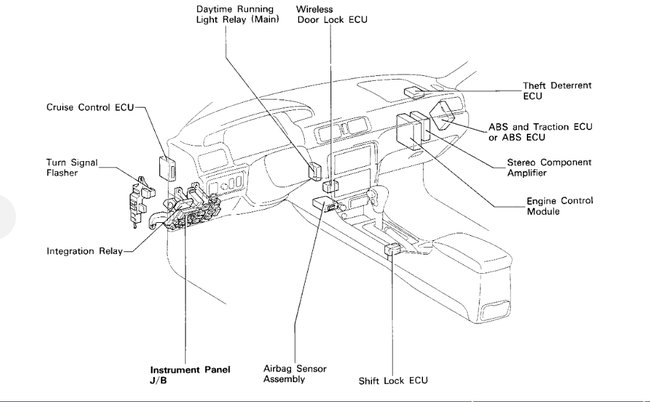

I have included the information that you requested in the diagrams down below. I have also included a guide on how to test the relay from the vehicle manufacturer as well for you. You will need to use a Digital Multi-meter[DMM] to do this, so here is a link below to a guide explaining how to use one, if needed, below:
Please go through these guides and get back to us with how everything turns out.
