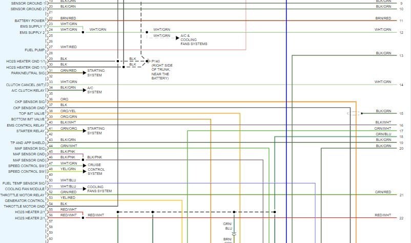

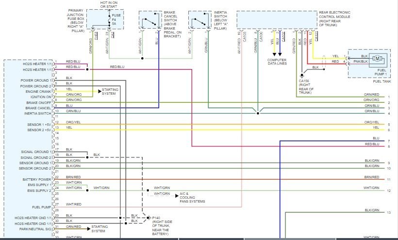

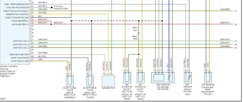

Good evening, can you please send me an image of the ECU wiring diagram? Thanks for a speedy response.
Dec 3, 2018 at 9:57 AM
  • 110,248 POSTS
I attached one of four pages of schematics. The page includes the ECU and each pin's designation. I had to break it into three separate pictures for it to be readable. I overlapped the pictures so you can follow it and see where I left off.
Let me know if this helps or if it is even what you needed.
