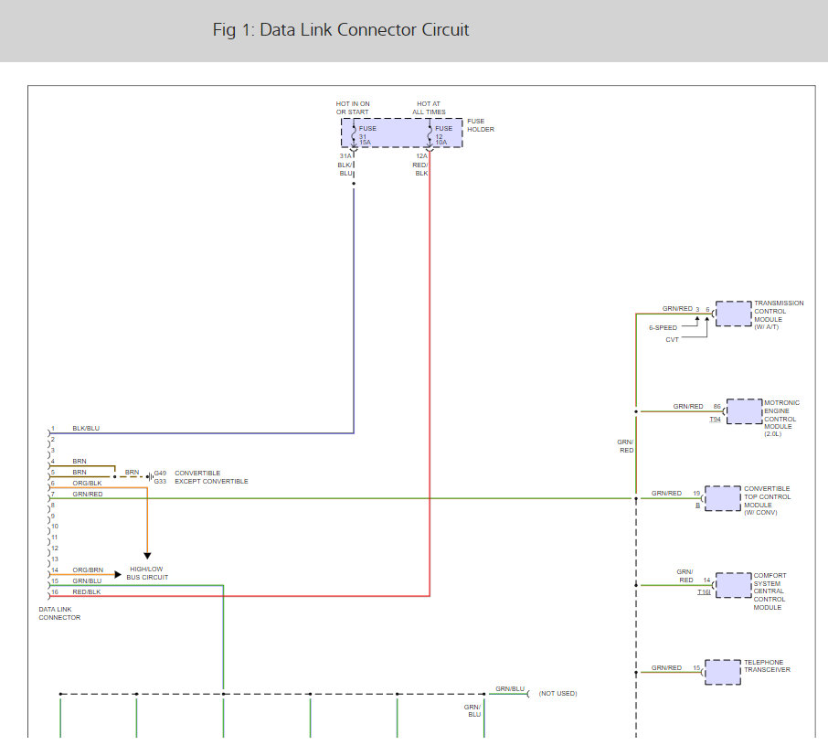

Good day, I am unable to connect the ECU via OBD II device. What can be the problem?

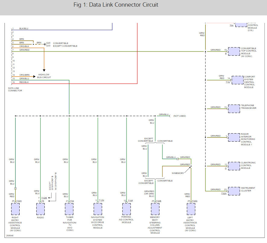

It sounds like you have a fuse #31 or #12 out, but also check the scanner on a different car to make sure it is working.
Check out the diagrams (below). Please let us know what you find.
