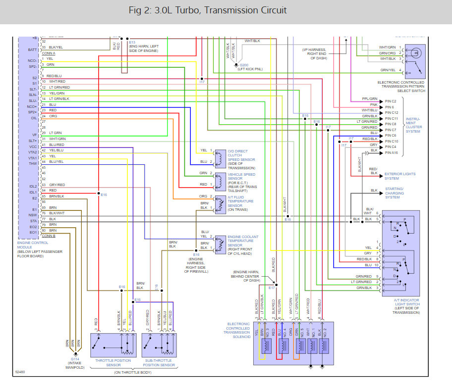

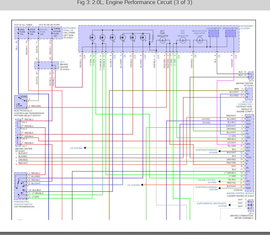

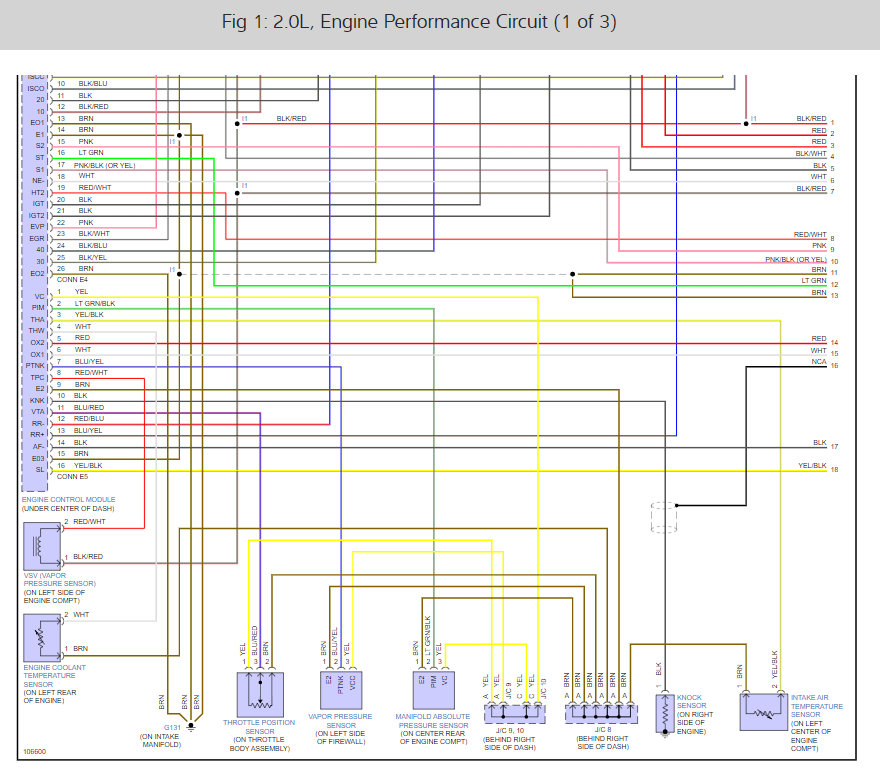

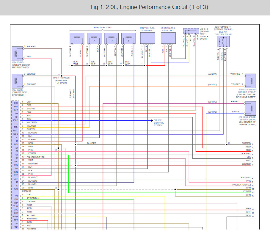

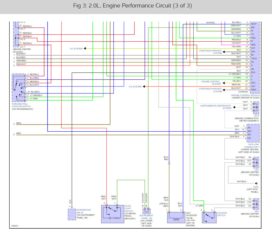

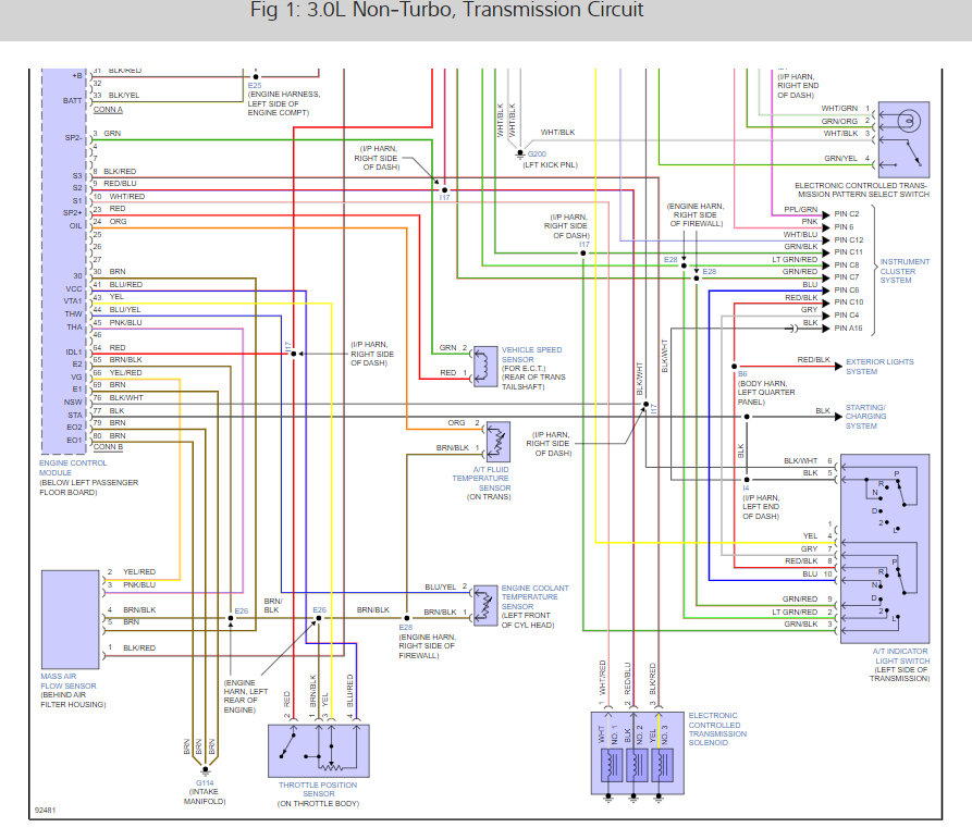

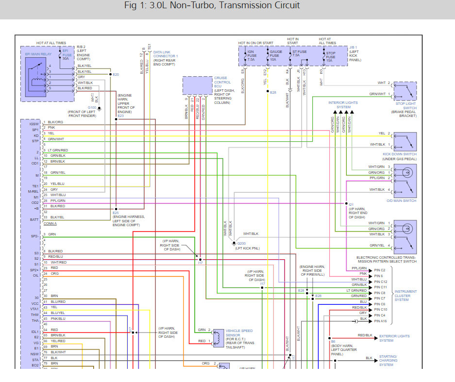

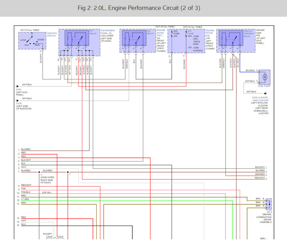

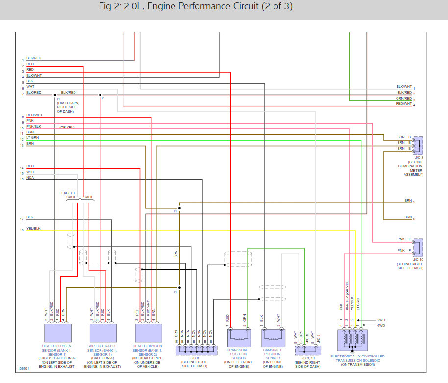

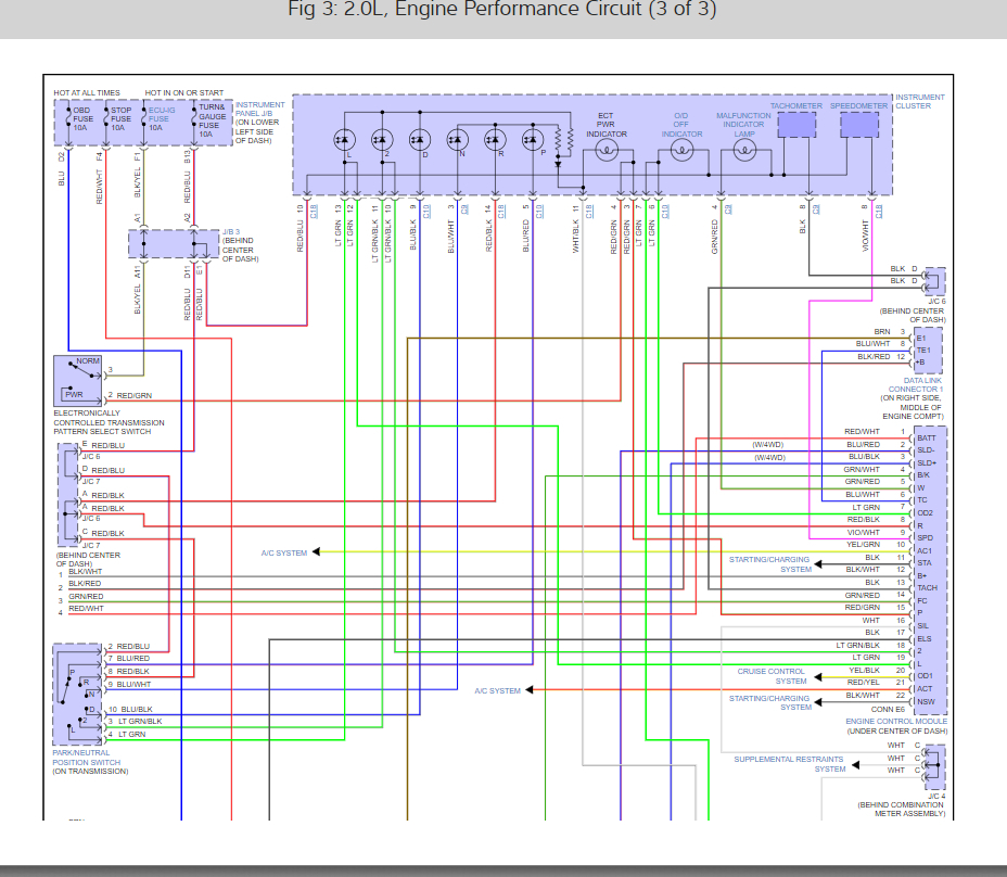

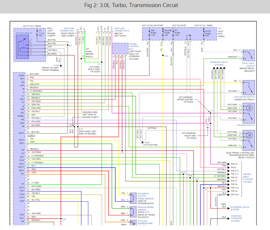

I need a wiring diagram to swap ECU 3S-FE into 1G-FE. Please help with all the information you have on that topic.
Sep 27, 2022 at 6:55 PM
  • 55,433 POSTS

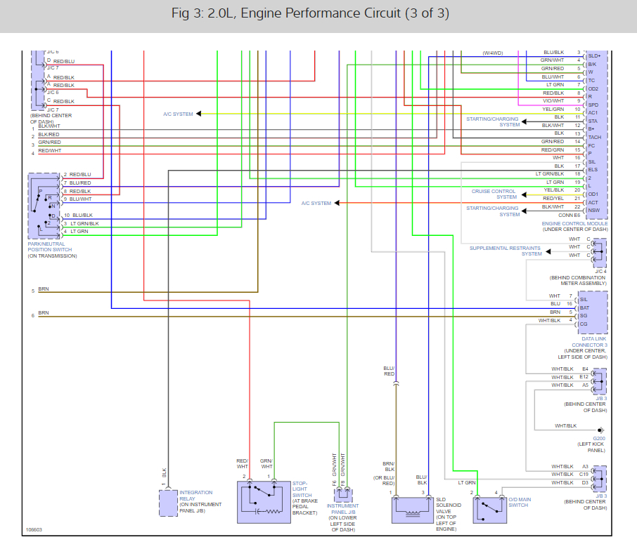

Yep, here are the engine and PCM wiring diagrams you have requested in the images below. Also, I have included a guide on how to check the wiring connections.
Check out the images (below). Please let us know if you need anything else to get the problem fixed.
Sep 28, 2022 at 10:40 AM
SENGA
  • 33 POSTS
The images can't help. I need to Perform a standalone swap from 3S-FE ECU in ECU into 1G-FE A/T. Meaning that i have 3S-FE Noah engine and I want to connect it to 1G-FE A/T ECU. i need how to perform a swap.
Sep 28, 2022 at 5:30 PM
  • 55,433 POSTS
Which car did this combination come in? I can look it up that way.
Sep 29, 2022 at 6:33 AM
SENGA
  • 33 POSTS

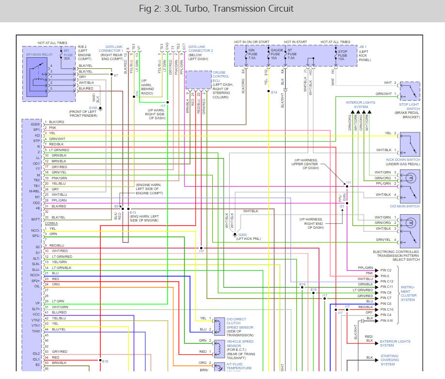

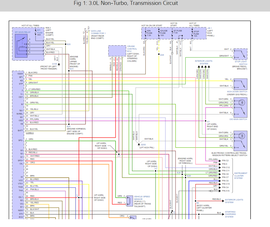

The problem is that i have an engine of 3s-fe ECU but the transmission is 1g-fe a/t. Ecu. I have 2 ECU. One for engine 3s-fe and on for transmission 1g-fe a/t. I need only transmission wiring diagram for 1g-fe a/t ECU.
Oct 4, 2022 at 11:45 PM
  • 55,433 POSTS
Toyota Supra - 1979–2008 here is the transmission wiring diagrams for a 1995, I hope they work for you.
