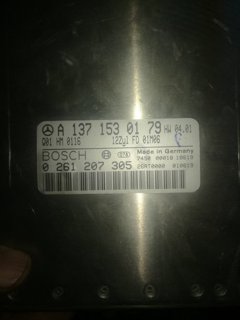

My car listed above (W220). Can I replace the defected ECU of my car A1371530179 with a newer version ECU no A1371530879? thanks

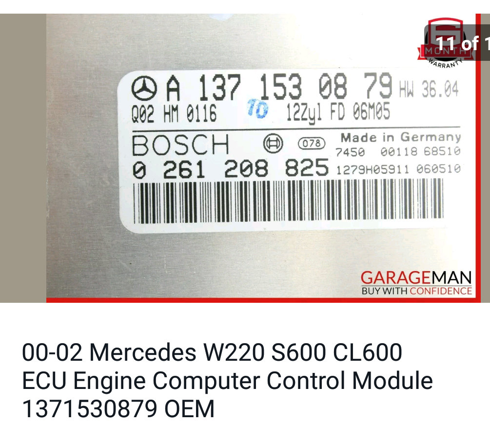

Got them from the stickers on the ECU it self , see pictures.
First picture is from my car and the rest is from eBay.

Okay, that is the wrong unit for your car.
I attached the correct unit for you.

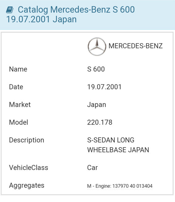

Hello Roy,
My car is 2001 Mercedes Benz S600 V12 5.8L, are you sure of this unit?
Attached is the information of my car.
Please reply me as soon as possible.
Thanks,
RAMZI
Sep 10, 2020 at 2:02 AM
RAMZITH1
  • 75 POSTS
The vin is:
WDB2201781A238906
Sep 10, 2020 at 2:06 AM
I just checked as this is not a USA VIN number.
The ECM you chose has the same numbers as the one you removed, so it should work once it is programmed to your car.
