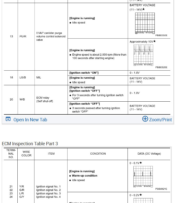

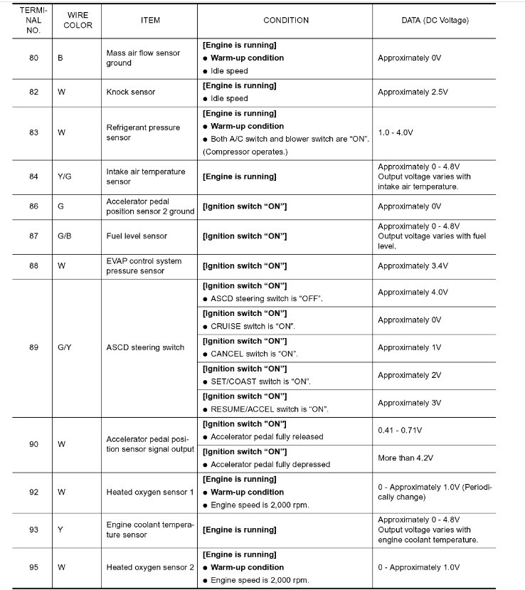

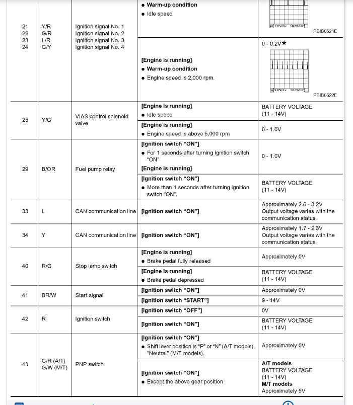

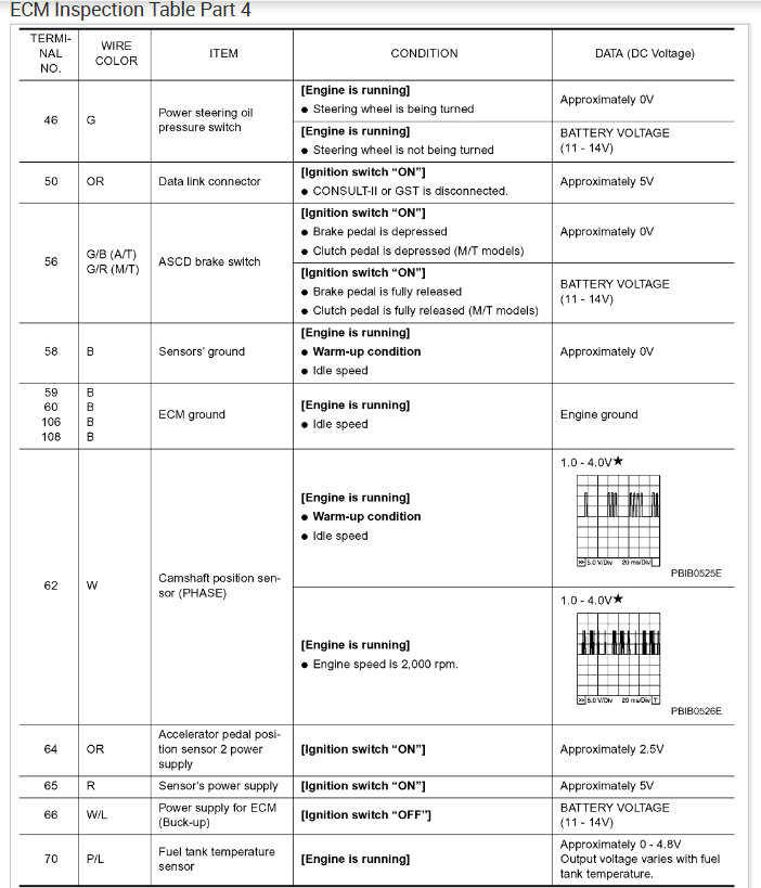

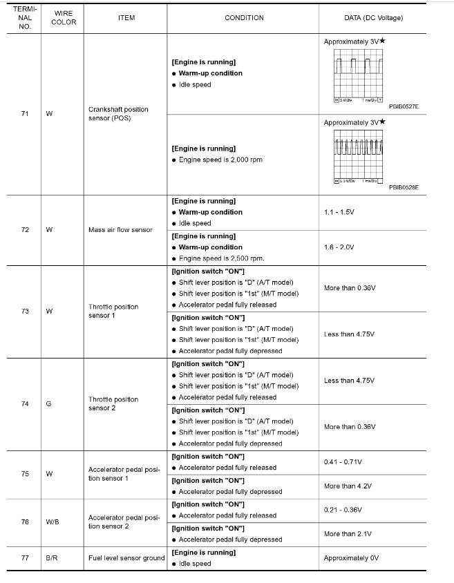

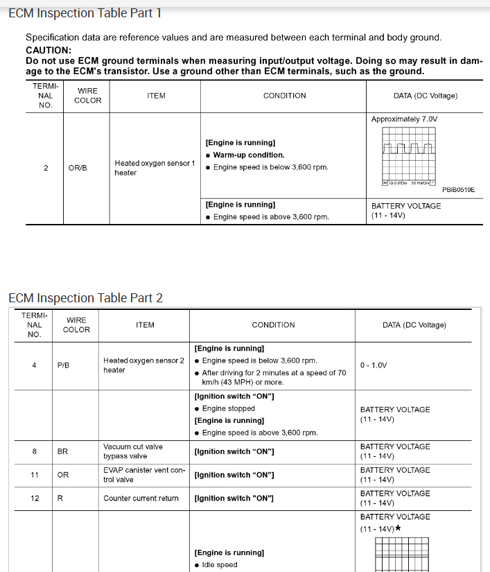

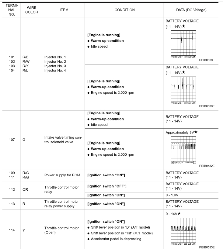

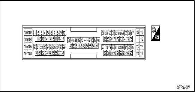

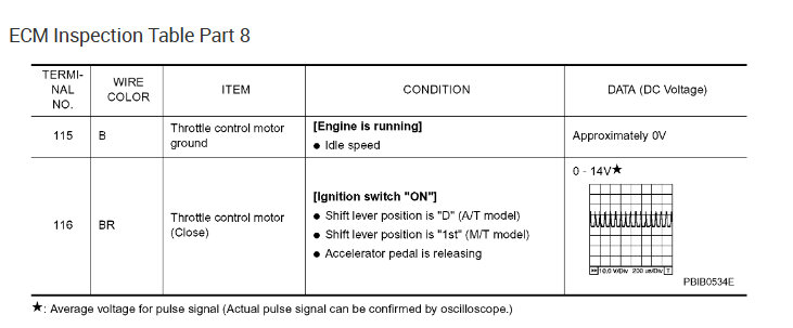

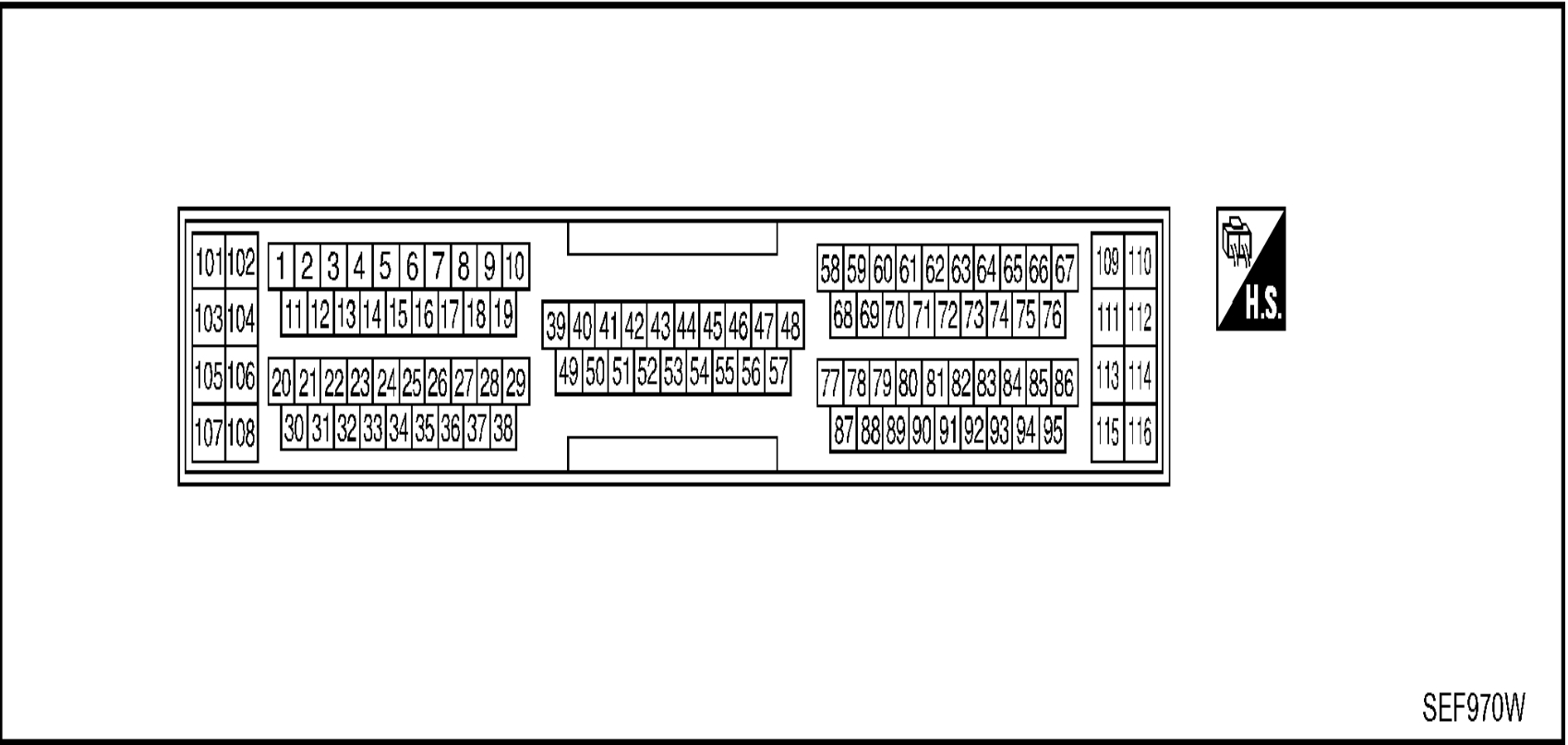

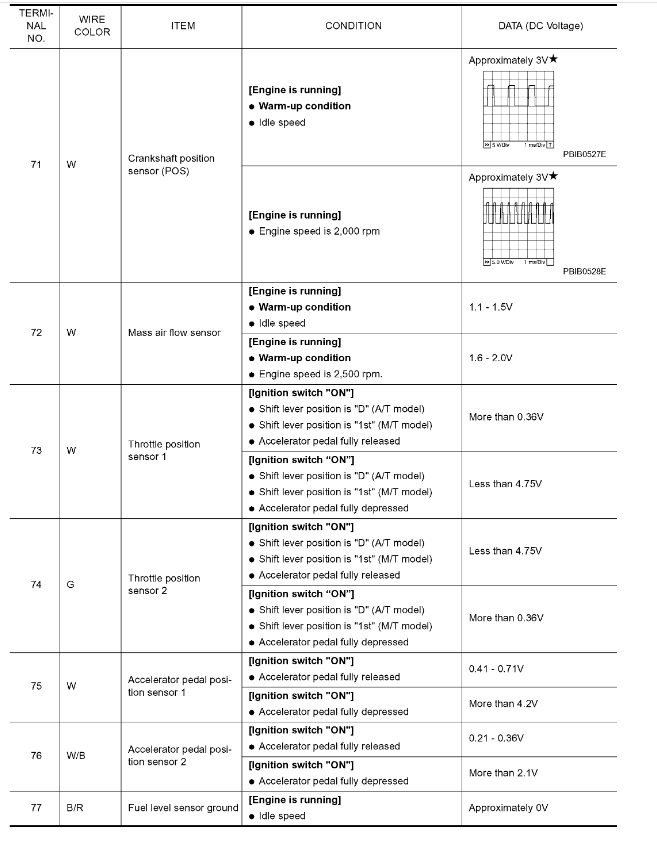

Cylinder number 2 injector is not firing, and I would like to get the diagram so I can check those wire coming out of the ECM and see if it has a signal for the injector.
Nov 6, 2024 at 1:30 PM
  • 55,709 POSTS
Sure, here is a guide to help you test the fuel injector signal and the ECM pin out diagrams as requested.
https://www.2carpros.com/articles/how-to-test-a-fuel-injector
