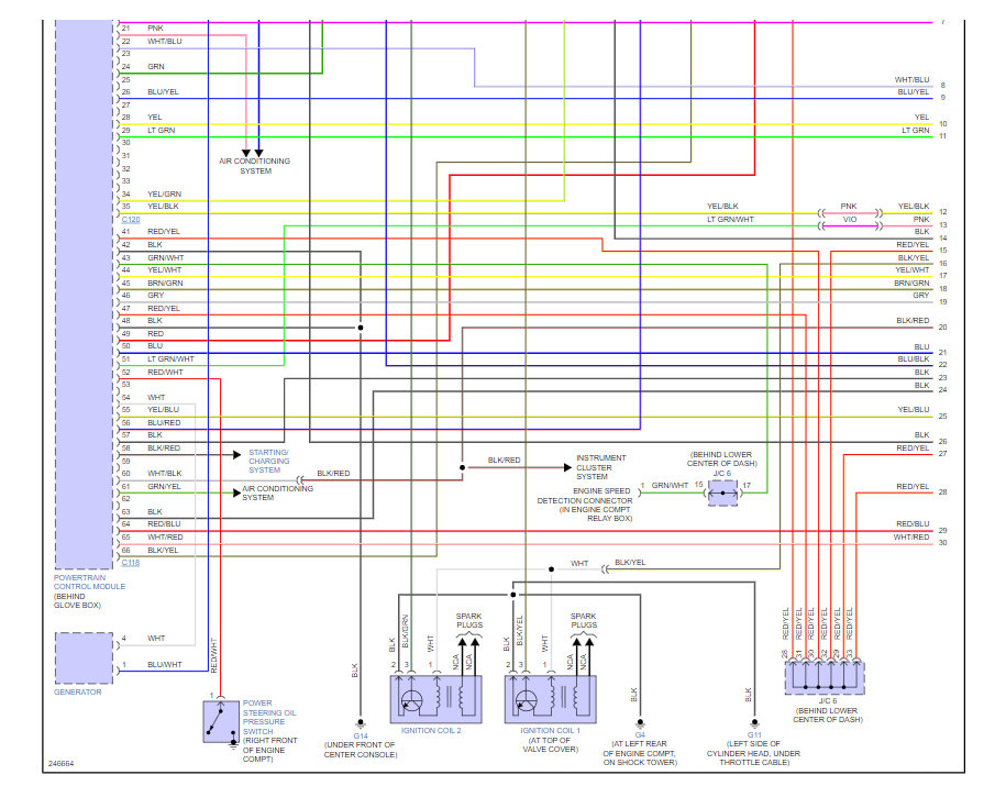

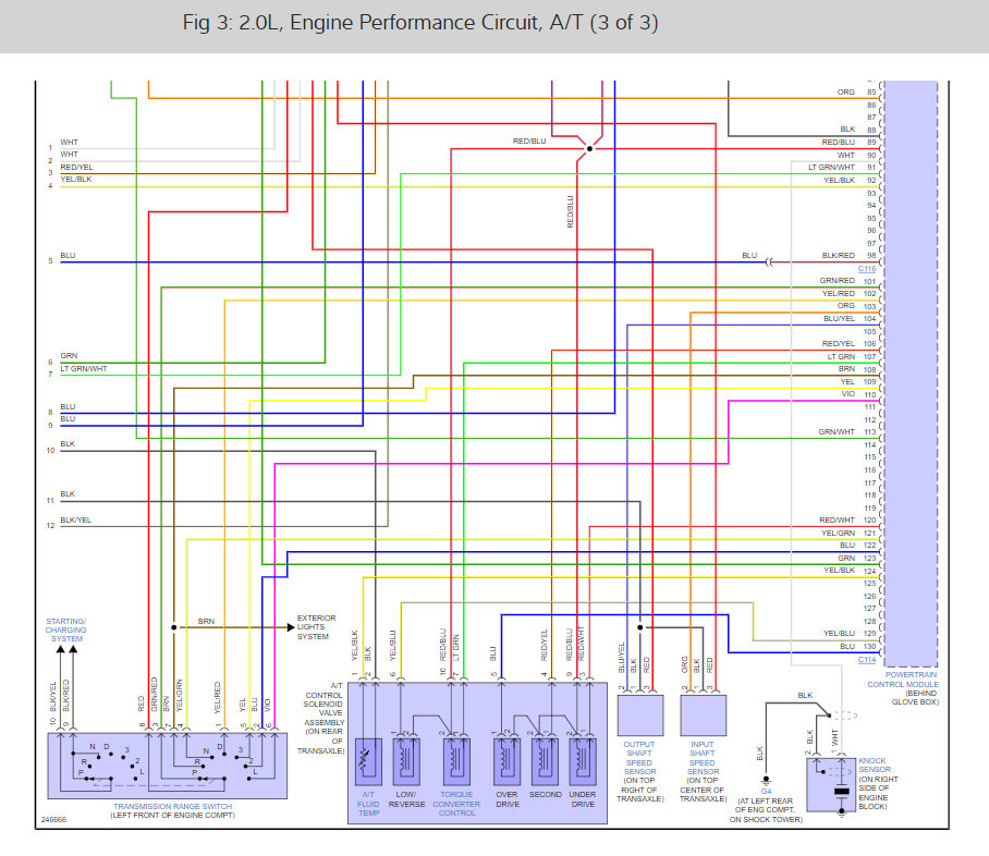

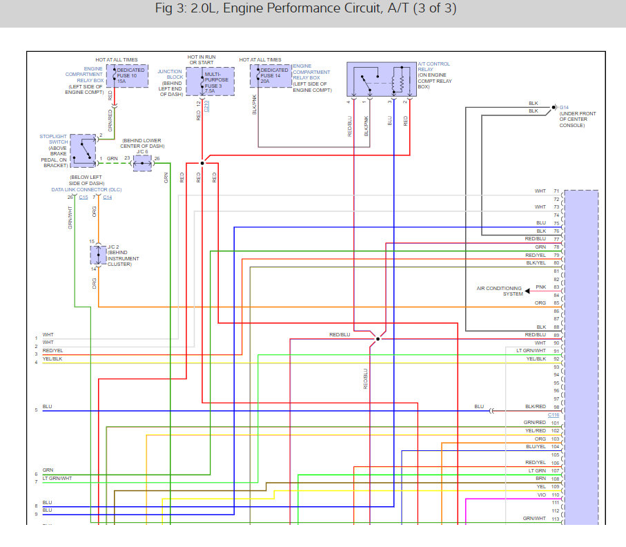

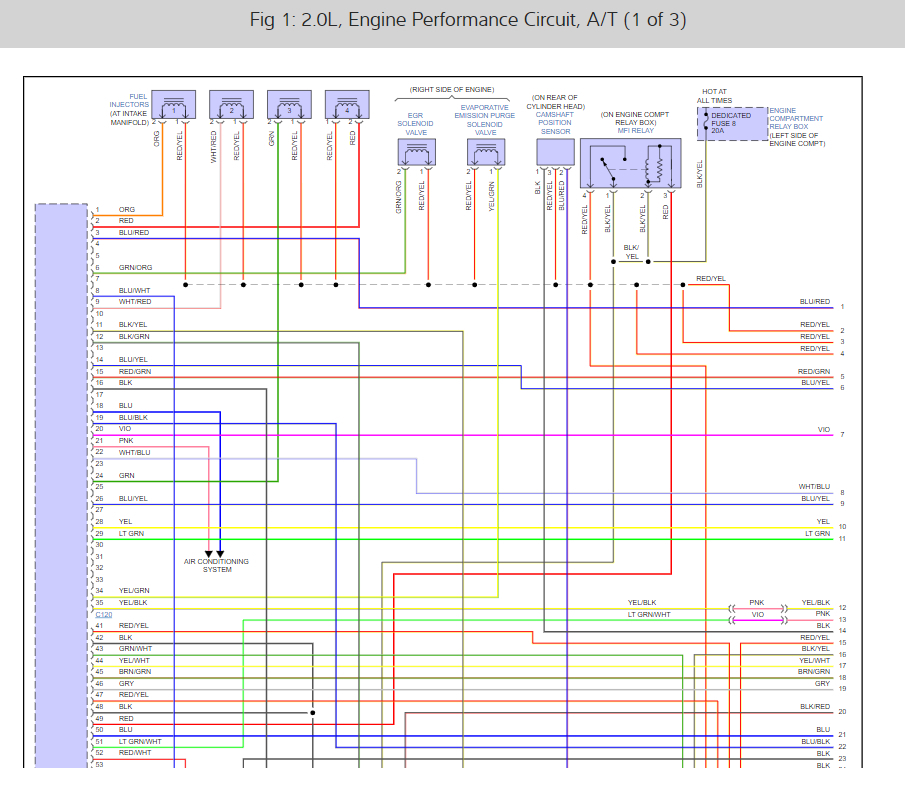

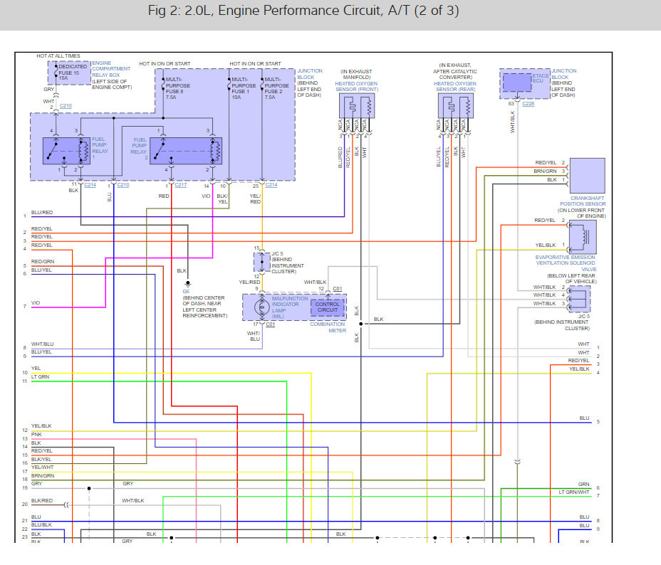

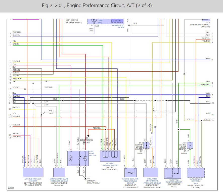

I'm looking for a pinout diagram for my ECU. It has four plugs and not three. I'm only finding pictures for ECU with three plugs.

Here are the engine wiring diagrams for the 2.0 liter with an auto transmission with a guide to help you test the wiring.
Images (Click to enlarge)
