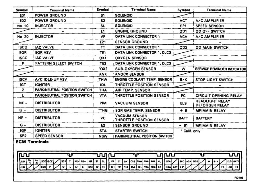

157,000 MILES • 2.2L • 4 CYL • 2WD • AUTOMATIC
KMPSULLIVAN
We have a problem with it cutting off immediately after we crank it. Read we can send a jumper wire from E7 to pin 3 and bypass the wiring that is old and broken. the picture of ECU is attached.

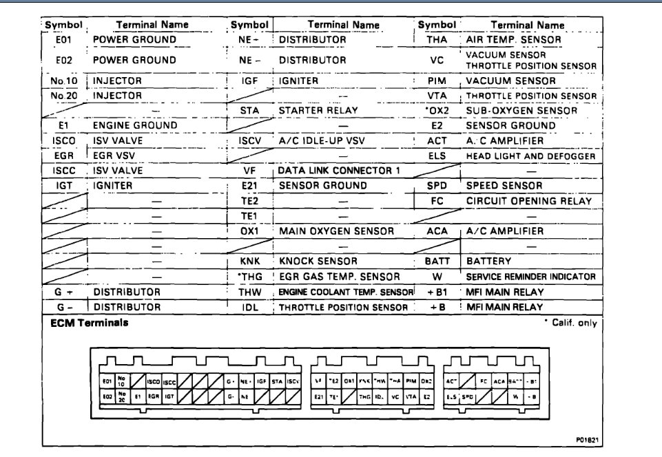

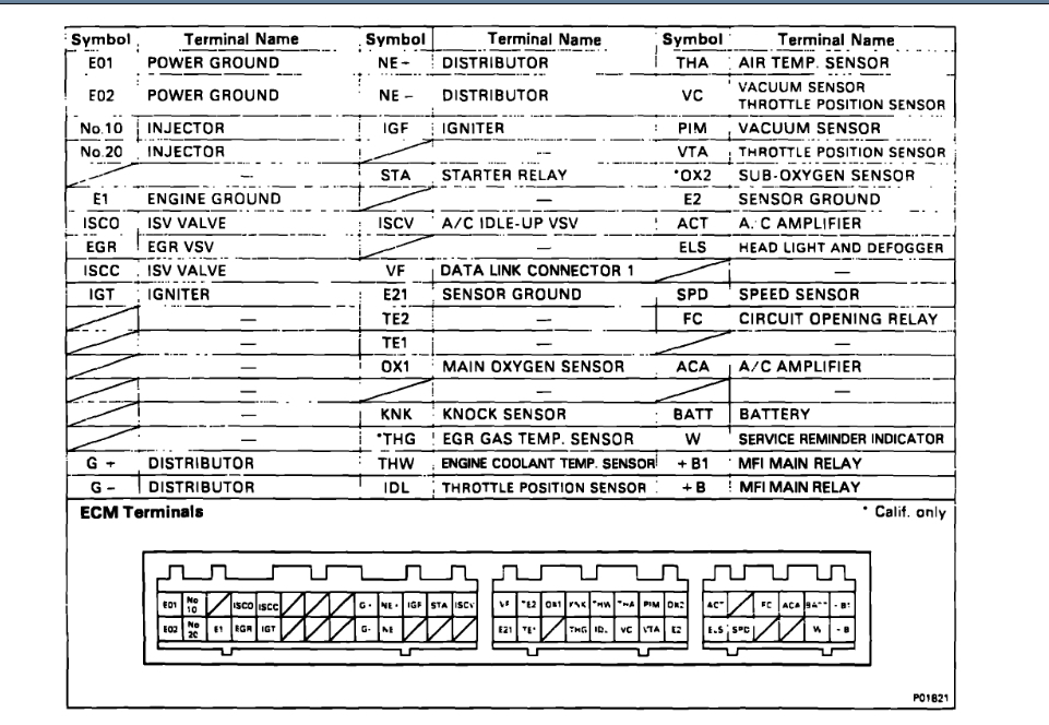

I have included the information that you requested in the diagrams down below. There are two diagrams, the first is if your vehicle has an electronically controlled transmission and the latter is for if you have a non electronically controlled transmission. I hope this helps.
Thanks,
Alex
