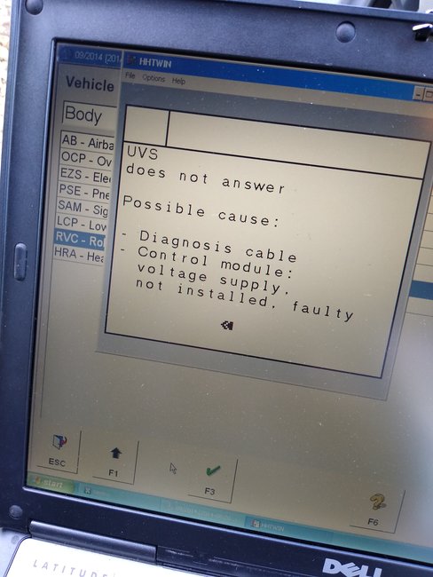

hi, battery went flat new one fitted now roof will not open. i have had this fault several times, normally use Autel scanner clears loads of faults roof and boot open okay. This time scan with obd same Autel tool runs trough to 100% then says no communication.
tried with star through big round plug similar problem.
any help please. Mike

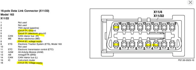

If you take a look at the pics below, it shows the DLC and where and what to check for. Do this and let me know the results.
Let me know what you find.
See pic below.

Hi, I have 2 pairs of 12v on the obd plug.
Jun 7, 2021 at 6:23 AM
HOWEM85
  • 7 POSTS
Only 4 wires in there 4-5 neg 7-16 +.

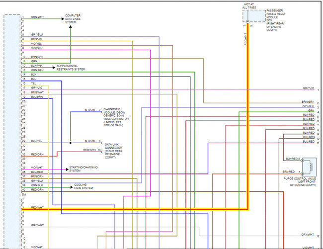

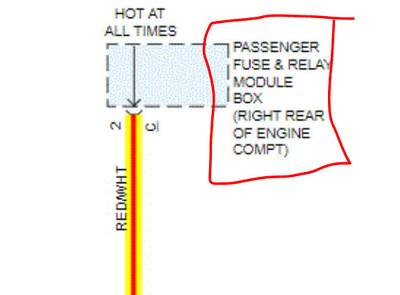

The connections sound good. It did provide 12v, correct?

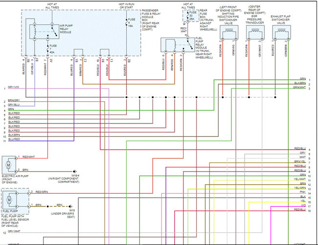

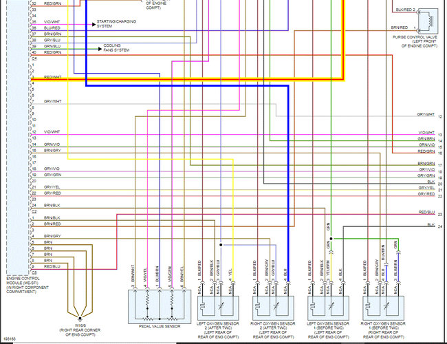

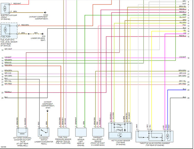

I attached the entire powertrain management schematic below so you have it as a reference. Today, I need you to focus on the first and second pic below. I highlighted a wire which powers the ECM. I need you to check to see if there is 12v at the ECM.

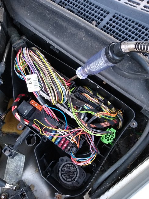

The ECM is under the hood on the right side near the firewall. I had the chance to speak with a friend today that owns a Mercedes repair shop. I remembered your vehicle and discusses it with him.
What he told me was to do what I suggested first. If you look at the schematic above, it shows the power supply to the ECM. He then added that it isn't uncommon for the fuses to get water to them and corrode causing low or no voltage to the ECM.
I checked all through my manual and was unable to locate the fuse location. He felt it would be in the vehicle on the left end of the instrument panel, so check that as well. Wiggle the fuses when testing for power. Basically, position the test light so you can see it. Watch to see if it flickers.

If I'm on the correct red, white cable it has no power unclear what fuse it's powered from. Having a look for diagram today on star dia. Thanks
Jun 9, 2021 at 4:42 PM
  • 110,248 POSTS
That is where I'm running into trouble as well. If you look at the pic below, that is the wire that supplies power. It shows the power module/fuse box but doesn't identify a fuse or source.
