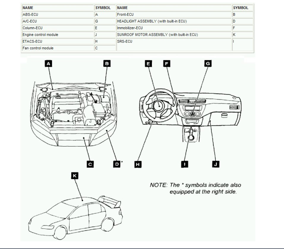

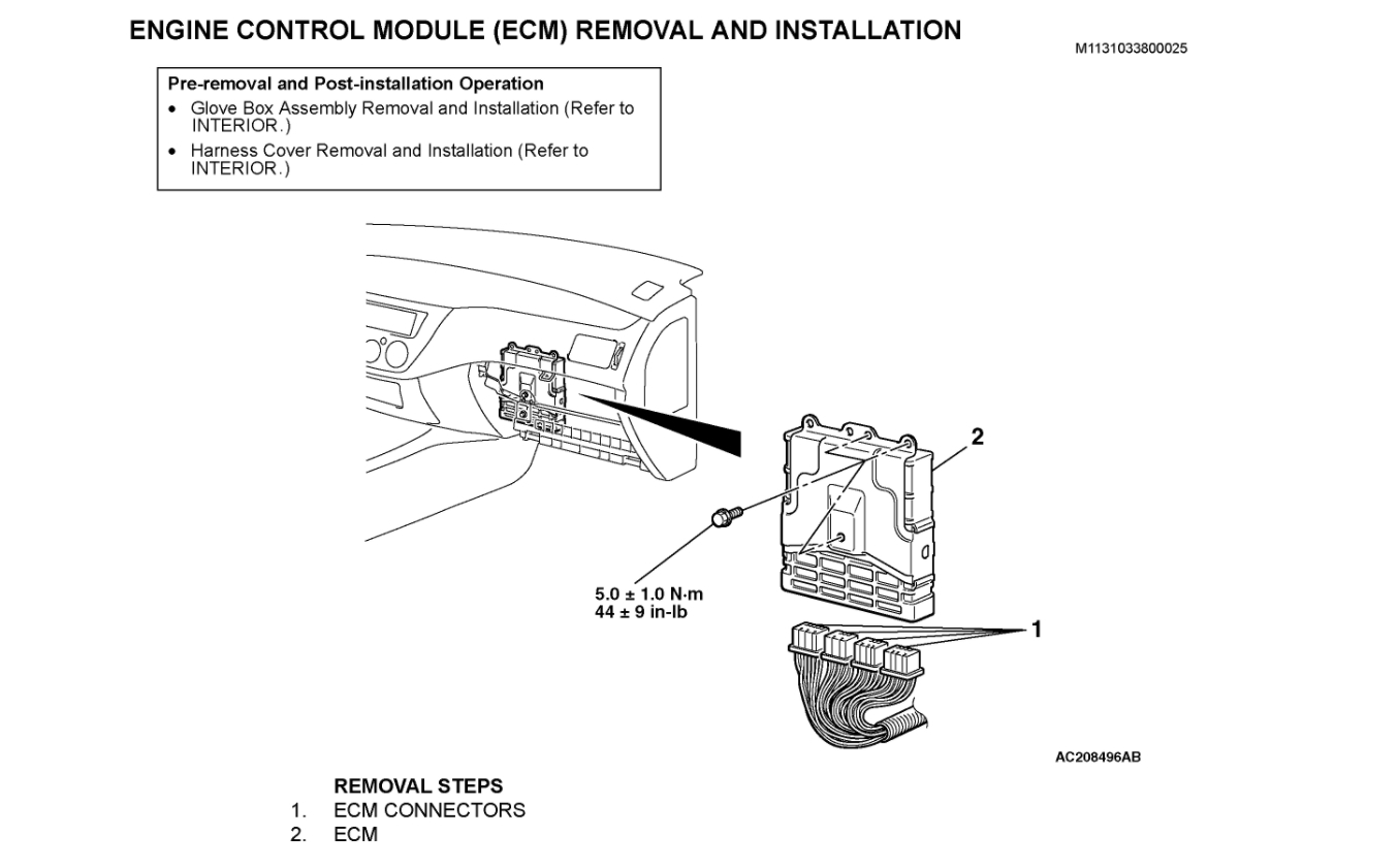

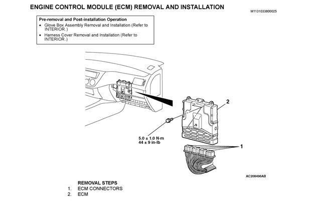

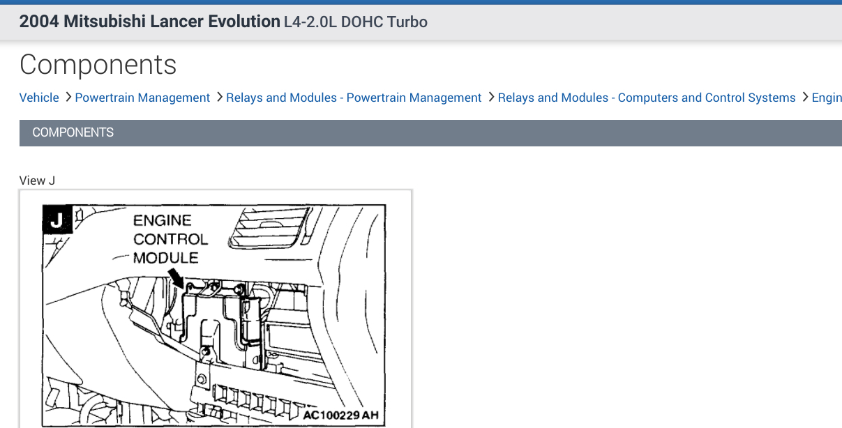

I need information and a guide on how to remove the ECU from car listed above oz rally.

In the diagrams down below I have included the information that you requested, the location and instructions for the removal and installation of the Engine Control Module[ECM] for your vehicle. Please remember to disconnect the battery's negative cable from the negative battery terminal when doing any electrical work on your vehicle, especially the ECM. Please get back to us with how everything turns out.
