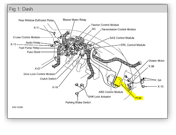

Hi ya, just wondering where the ECU is located on the car listed above. i have a me221 ECU and trying to program it but need to check connections as it is not loading on my laptop. thanks

The Power-train Control Module (PCM) for your vehicle is located behind the right hand side of your vehicle's dashboard. I have included a diagram for you in the diagrams down below.
