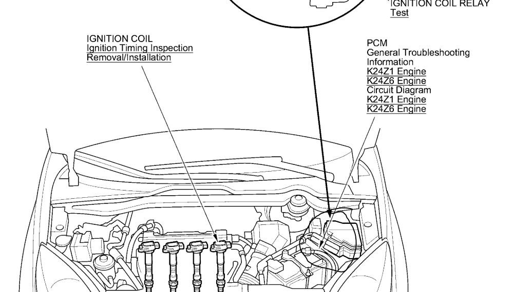

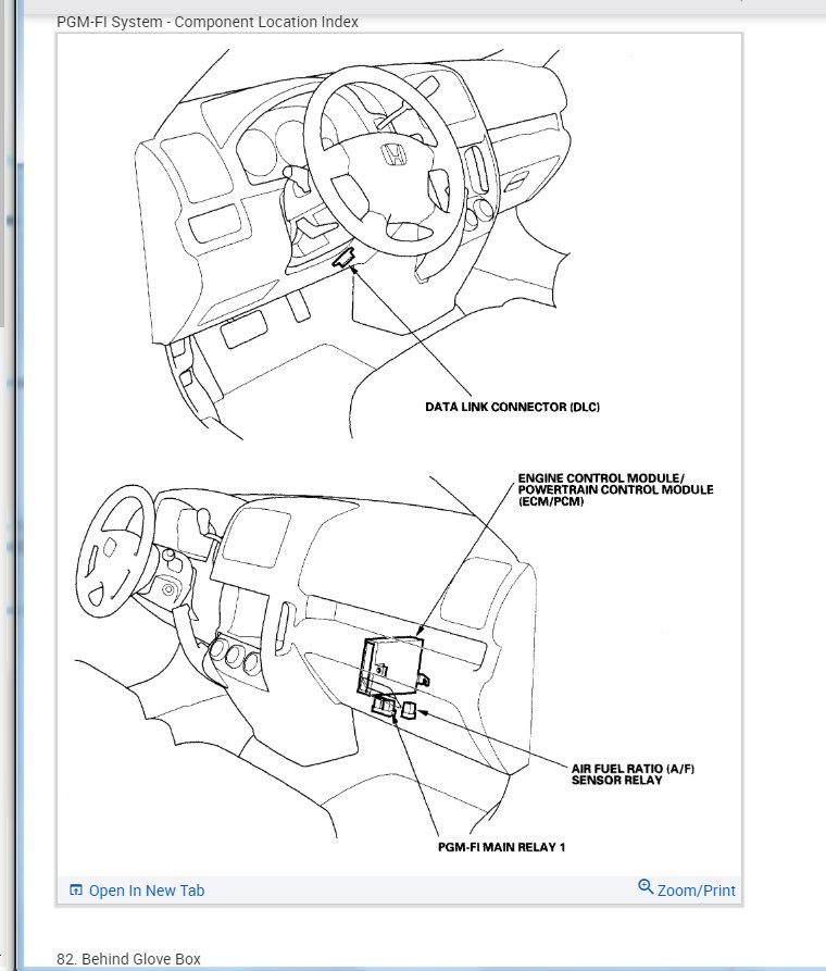

Can anyone please tell me where my Engine Computer Control Module is located on my vehicle? Thanks!
Sep 17, 2019 at 8:31 AM
Good evening,
It is located right next to the battery by the fuse box.
I attached a picture for you to view.

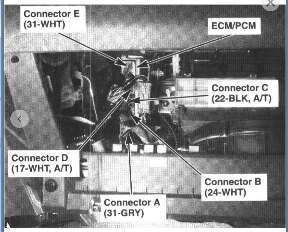

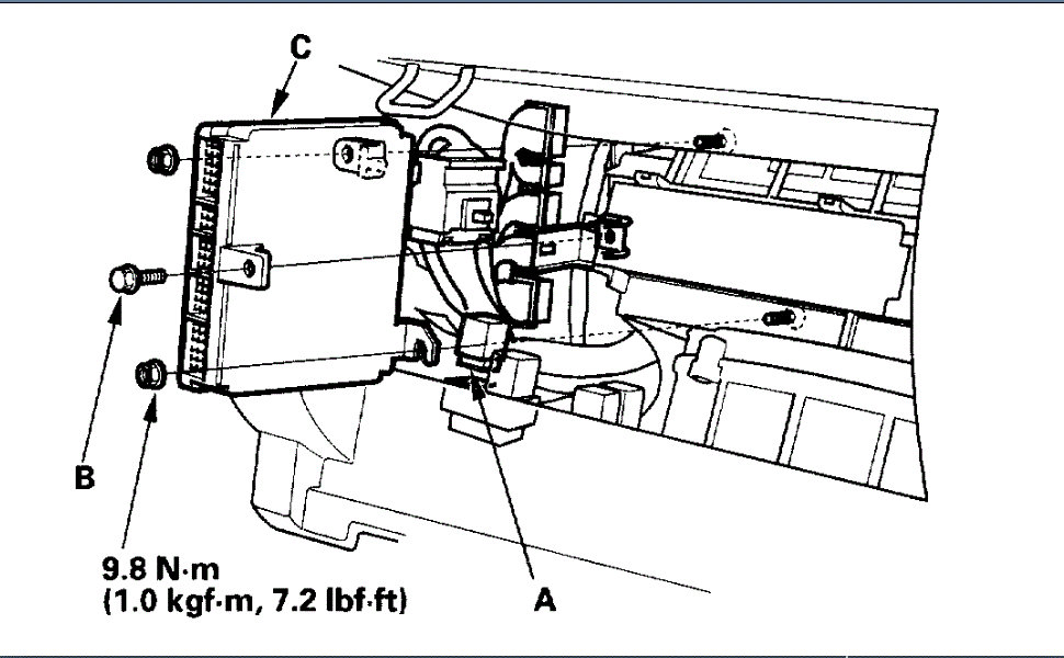

I need to remove the ECU for repair and need to know where it is located.
Dec 30, 2020 at 3:11 AM (Merged)
I attached the info requested. Let us know if you need more info. Thanks

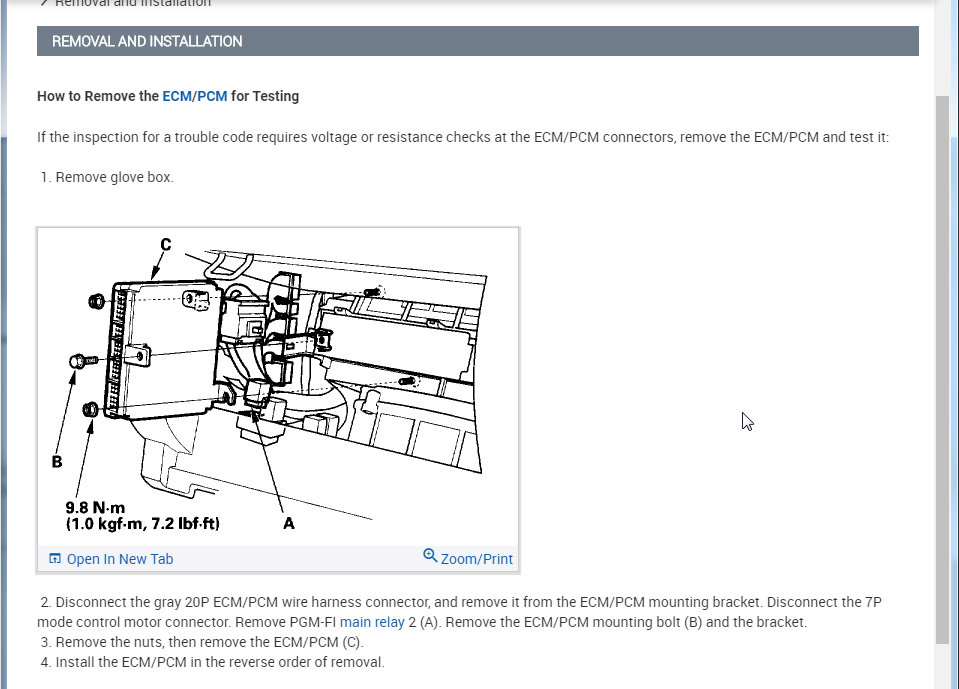

Good afternoon,
It is behind the glove box. I attached the procedure and a picture for you.
Why are you replacing it?
How to Remove the ECM/PCM for Testing
If the inspection for a trouble code requires voltage or resistance checks at the ECM/PCM connectors, remove the ECM/PCM and test it:
1. Remove glove box.
2. Disconnect the gray 20P ECM/PCM wire harness connector, and remove it from the ECM/PCM mounting bracket. Disconnect the 7P mode control motor connector. Remove PGM-FI main relay 2 (A). Remove the ECM/PCM mounting bolt (B) and the bracket.
3. Remove the nuts, then remove the ECM/PCM (C).
4. Install the ECM/PCM in the reverse order of removal.

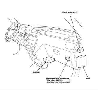

PROBLEMAS
how I can replace and where is located the ecm(engine control module)?

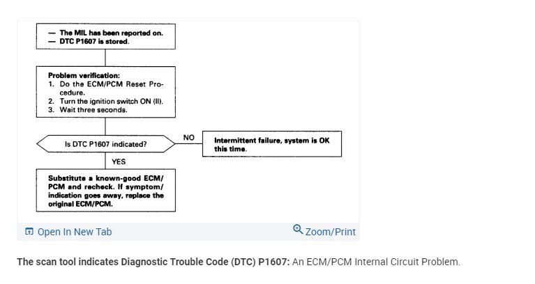

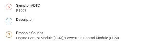

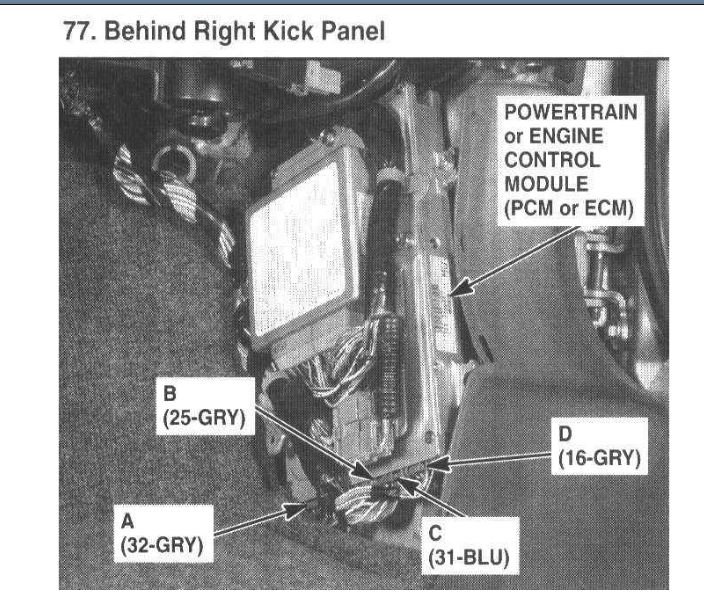

Check engine light came on, now car runs poorly especially in cold temperatures. It's not misfiring, it's just real weak. Putting it in D3 it almost won't move, so I have to put it in D1 to drive until the engine warms up enough and then I can shift to D3. My local mechanic said their diagnostic computer shows code 1607 which is for the ECU/PCM.
My question is, if the part is as easy to replace as I've seen online, does it have to be reprogrammed after it's installed? Or is it just a simple plug and play so long as the replacement part is an identical match? If it's easy to replace myself, I'd like to avoid paying the mechanic hundreds to do it if I can. Appreciate your insight!
Dec 30, 2020 at 3:12 AM (Merged)
Good evening,
Yes, it is a code for the ECM. You need to replace it.
It is located at the right kick panel. You will need a new one and yes, it has to be programmed to your car.
STEVEN PATTON
Okay. exactly what I needed to know. Thanks for your insight!
