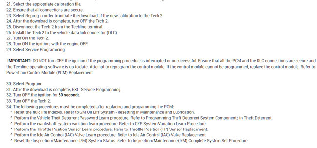

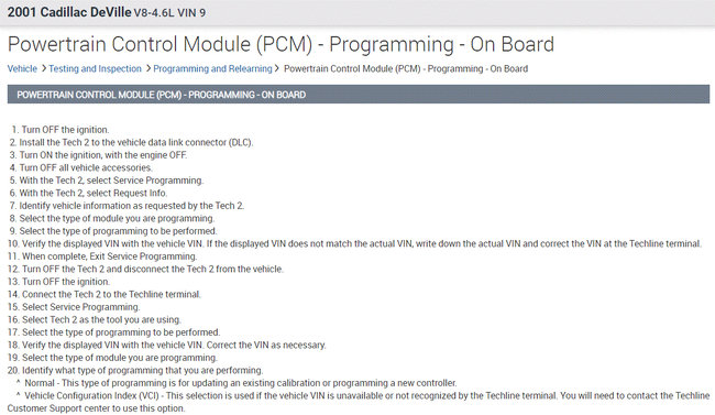

Trying to reset computer. ECU fuse.
Sep 29, 2021 at 2:13 PM
  • 110,194 POSTS
Are you referring to the powertrain control module (PCM)? If you need to reset or reprogram it, a scan tool with the relearn capabilities is needed.
If you look at the pics below, they provide the directions. If there is something different needed, let me know.
