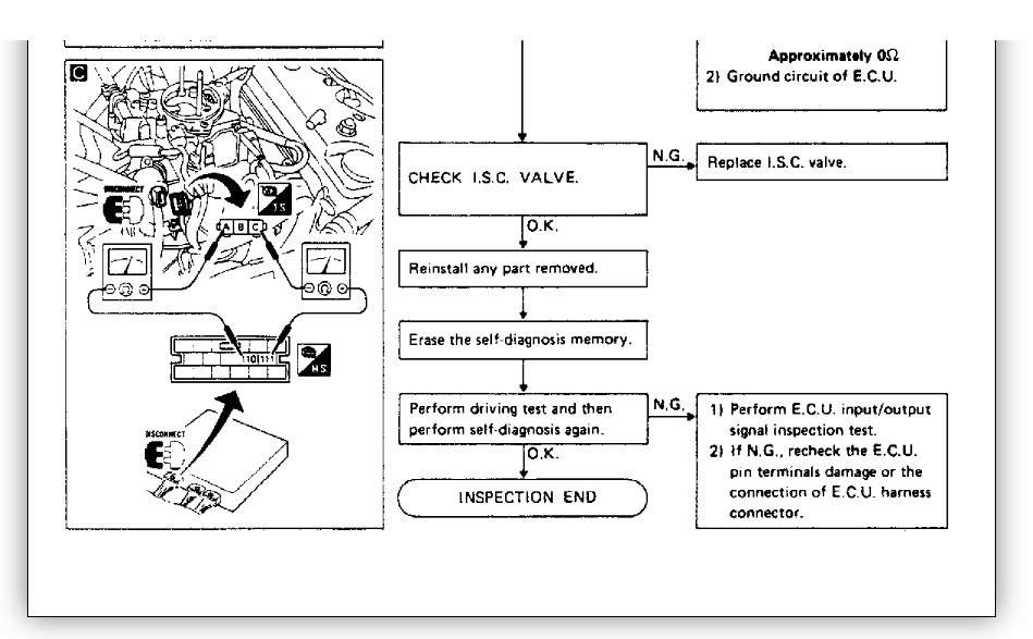

Forgot to get back to you. I changed the filters, even the small crank filter in the snorkel (never was one when I bought the car) a few months ago. Sounds weird, but it seems to run slightly worse. It still idles rough and stalls when coming to a stop a lot. It is very gradually getting worse.
Not sure what to look for.

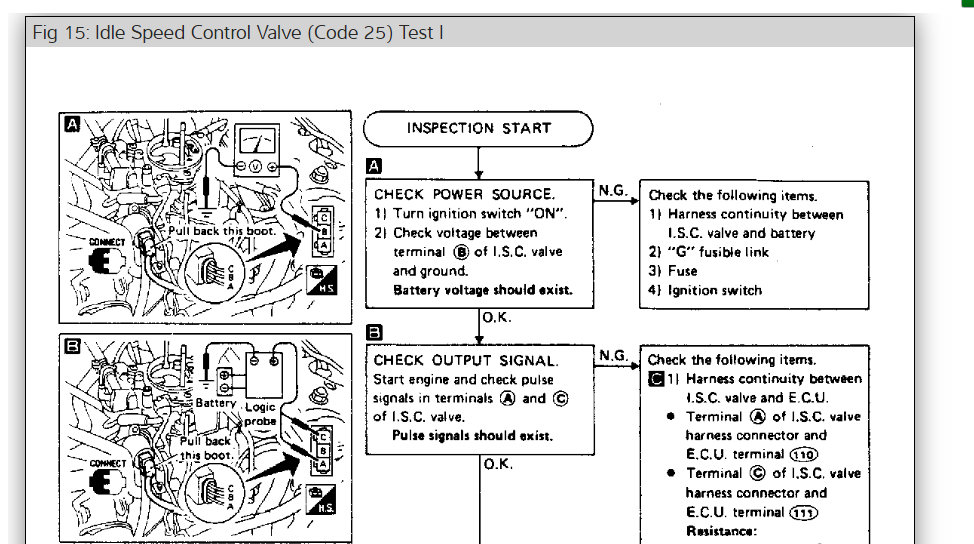

Sep 9, 2019 at 7:58 AM

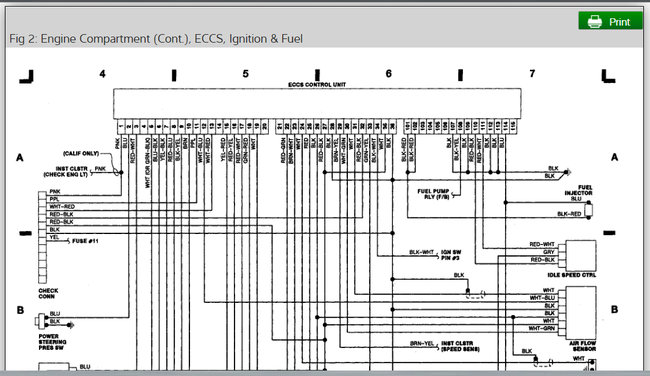

SCGRANTURISMO
  • 4,897 POSTS
Hello again,
This could a problem with your vehicle's Idle Speed Control valve. In the diagrams down below I have included a factory diagnostic flowchart for the inspection of the Idle Speed Control valve on your vehicle. You will need to use a Digital MultiMeter to do these tests, so here is a link on how to use one, if needed.
Please go through this troubleshooting flowchart and get back to us with what you are able to find out.
Thanks,
Alex
2CarPros

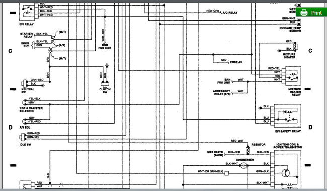

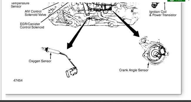

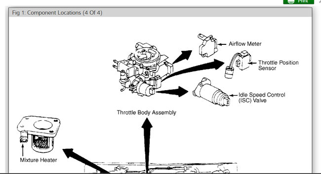

RUBYANDTHEPEACH
  • 22 POSTS
Sorry to get back so late. I have to get a more reliable meter. The cheap one i have isn't any good.
A couple things though. As the car gets warmer, the idle improves some, but it's still rough. It also has a rich smell cold or warm. Not a gassy smell, it's more high emissions.
As your driving, sometimes it loses power, like a slight surge, then clears up. This is random.

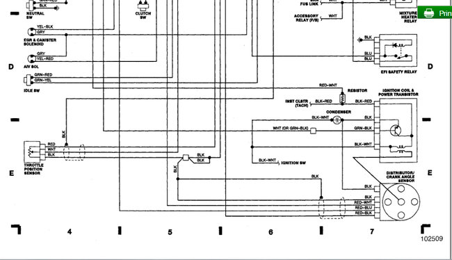

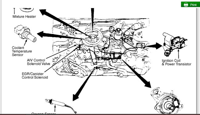

About 2 months ago, I was wiggling the main harness(next to the TPS which branches out into all the sensors) to see if there was a loose connection somewhere. The idle would fluctuate up, then go down to normal right away.
Did that a couple times. I traced what I thought (not 100% sure), was a 2 wire harness leading to the back of the throttle body (facing motor-left side behind the T.B.). It screws into the T.B. and has a white plastic housing. When I wiggle the harness now, it doesn't do it anymore. Is this a coolant temperature sensor?
Thanks once again,
Chris
Sep 30, 2019 at 8:57 AM
SCGRANTURISMO
  • 4,897 POSTS
Hello again,
In the diagrams down below I have included a diagram of the sensors of your vehicle in the diagrams down below. ou should be able to determine what the component is from this.
Thanks,
Alex
2CarPros
