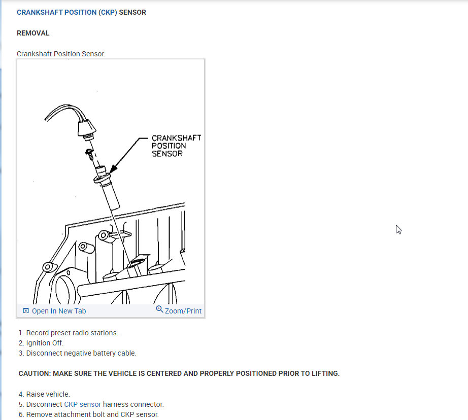

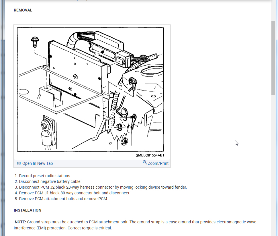

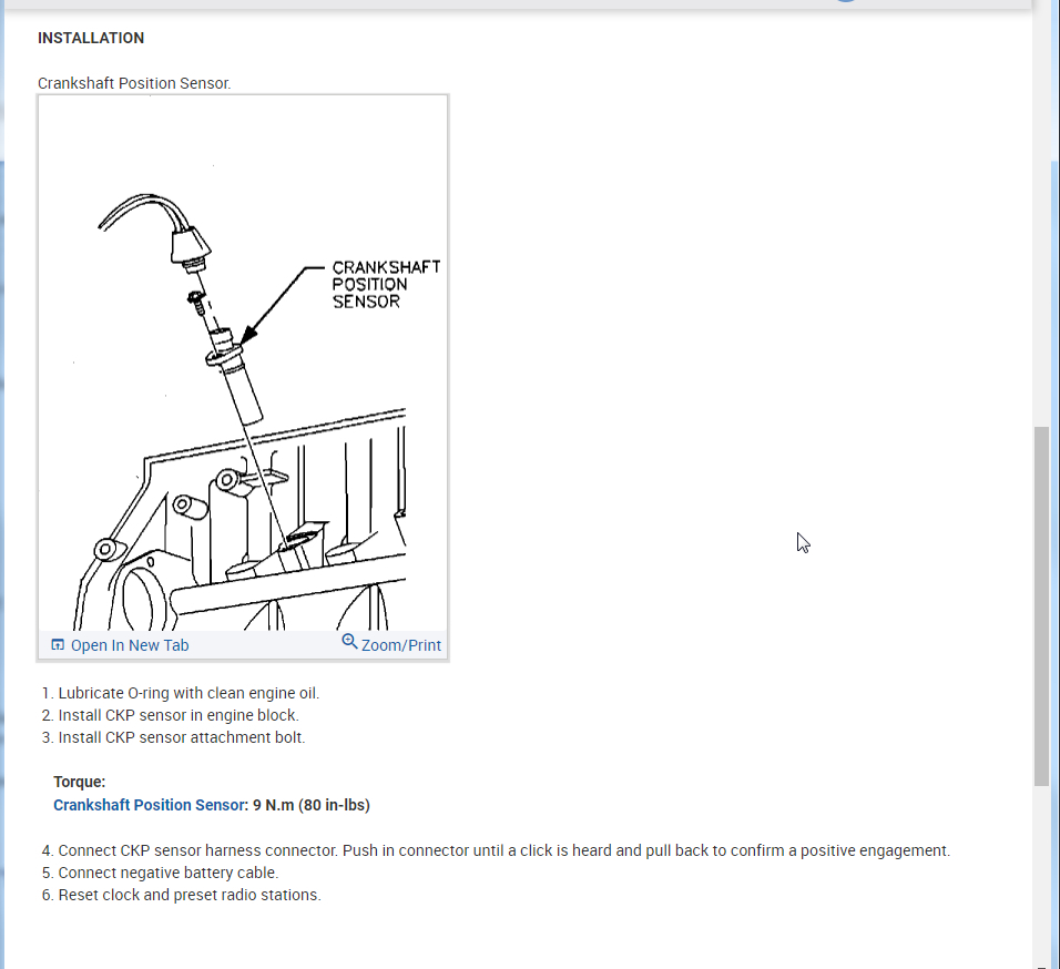

Car no start. Not getting spark or injector pulse. Need ECU pinout please. Thank you.

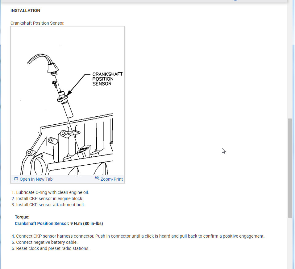

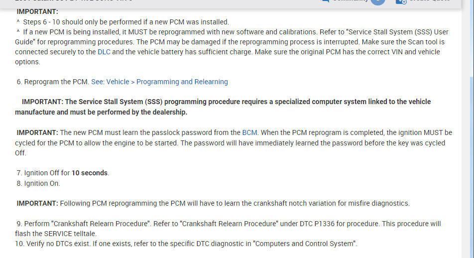

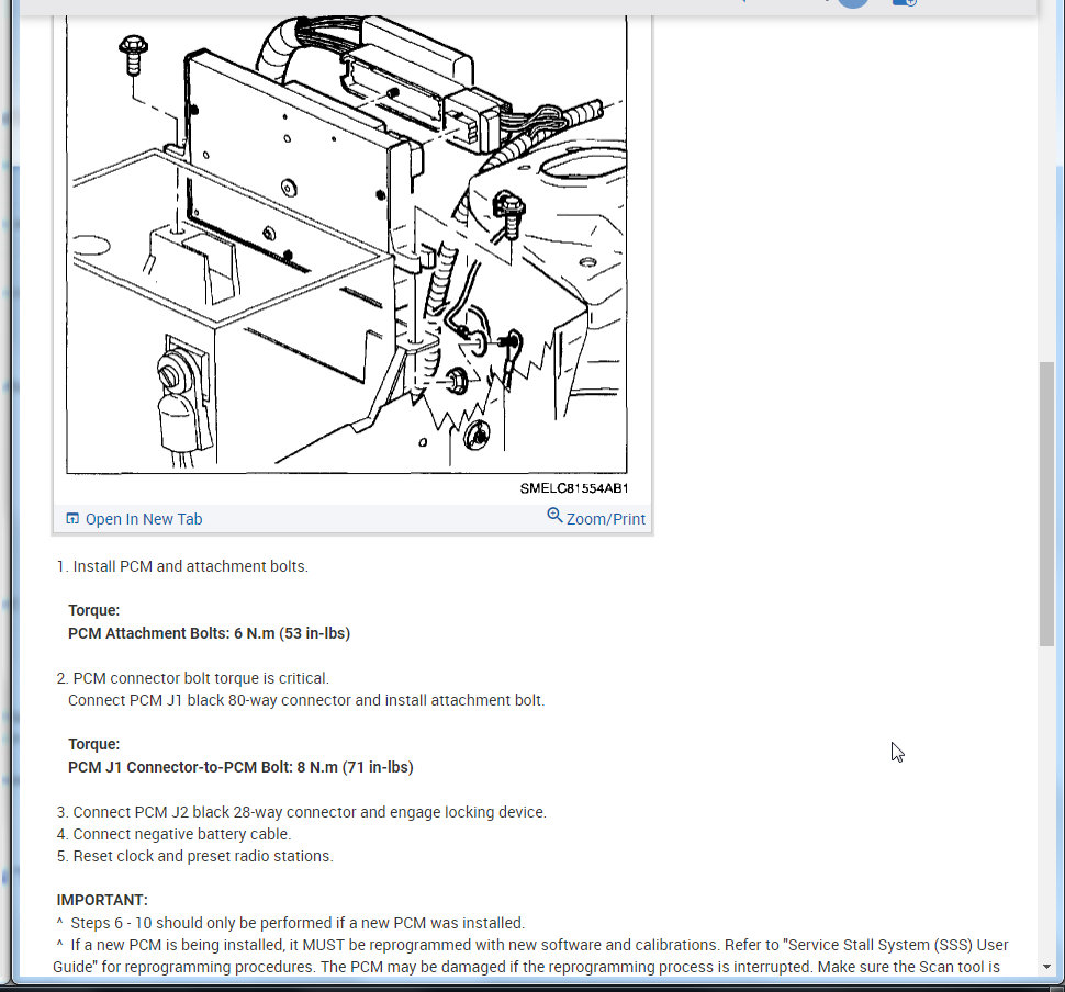

Hey guys, thanks but got it fixed. Whoever owned by car before tried to fix ignition problem.by swapping PCMs. Caused injector pulse problem Swapped back to OEM PCM, injector pulse solved. Did some diagnostics on ICM and discovered open between +/- CKP wires. Will replace bad CKP. Thank you, miss you guys. Alex.

Sorry we did not get to you earlier but thanks for updating us. I am attaching the info below in case you need it but sounds like you don't.
Also, in case others need this here is a guide that helps with this issue:
https://youtu.be/dCjmRL3p4Cs
Below you will find this detail. Thanks again and please come back.
