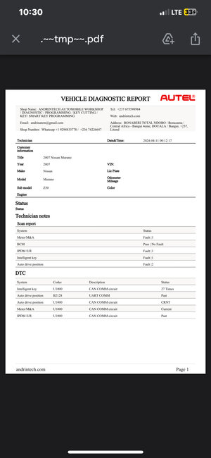

I bought a new ECU and a BCM, so I tried to program my key, on the network can bus, ECU and TCM does not show on the network, which makes it impossible to program a key.

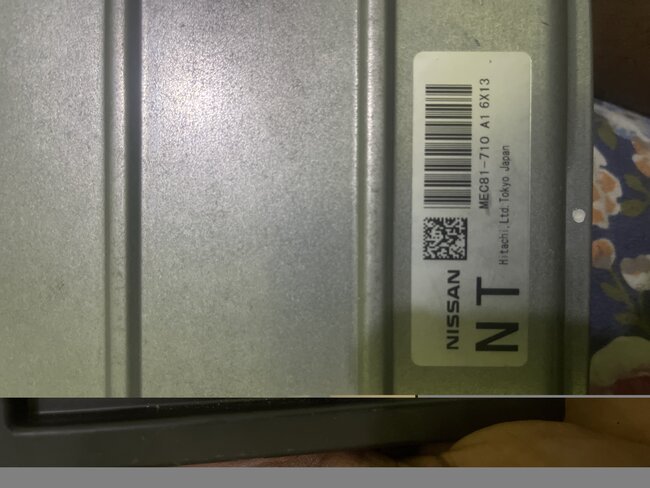

I have attached screenshots of the modules it was able to see. Below are the images as well for my used ECU and TCM, just bought both. Please can you also help me check to know if those parts are compatible for this VIN JN8AZ08W07W657380. BCM Q 284B1CC21A Calsonic Kamari.

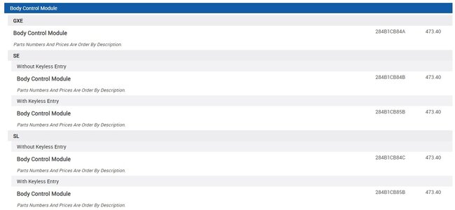

What was the reason to replace both parts? Failure or? If they are not showing up, then it is likely that they need to be programmed to operate in your vehicle. They are not plug and play items unless they are brand new and never initialized, even bench testing them on typical equipment can make them into bricks unless you use the OE tool and web site to program them. The way it is supposed to work is that you test the vehicle, discover the ECM is bad. You buy a new ECM from the dealer and install it. That ECM talks to the original BCM and loads a configuration from it. Then you program in the keys. Or the BCM is bad, you replace it with a new one and initialization takes place from the original ECM. Replace both at the same time and now you need to use the Consault to program both. Then you can initialize the keys.
Looking at the part numbers the ECM should be either 23710CB820 without dynamic stability or 23710CC23C if it has stability control.
The BCM depends on the trim level and option package but the number you posted doesn't show on the attached list.

My Murano has the keyless entry, I think you are right when you said the code number, I sent for the BCM I bought does not show up the list. Then I think my BCM must be the trouble.

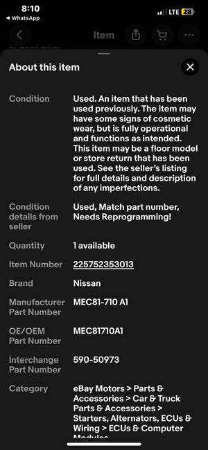

Please take a look at the seller's condition on eBay for same part ECU I bought. Does this mean reprogramming is only for keys or does it mean the OEM?
I have an Autel maxisys 908p

Looks like it needs the OEM reflash. At least that is what I would expect with any used ECU as they need to have the correct VIN and more to operate. The Part number is the same for a few different models, it is the software that gets installed that makes it work with your car.
That Autel should have came with a J2543 box. However, you still need the Nissan specific programming software. The Autel may allow you to use it but check the list at Nissan about the hardware needed as some makes are very specific about the tools used.
