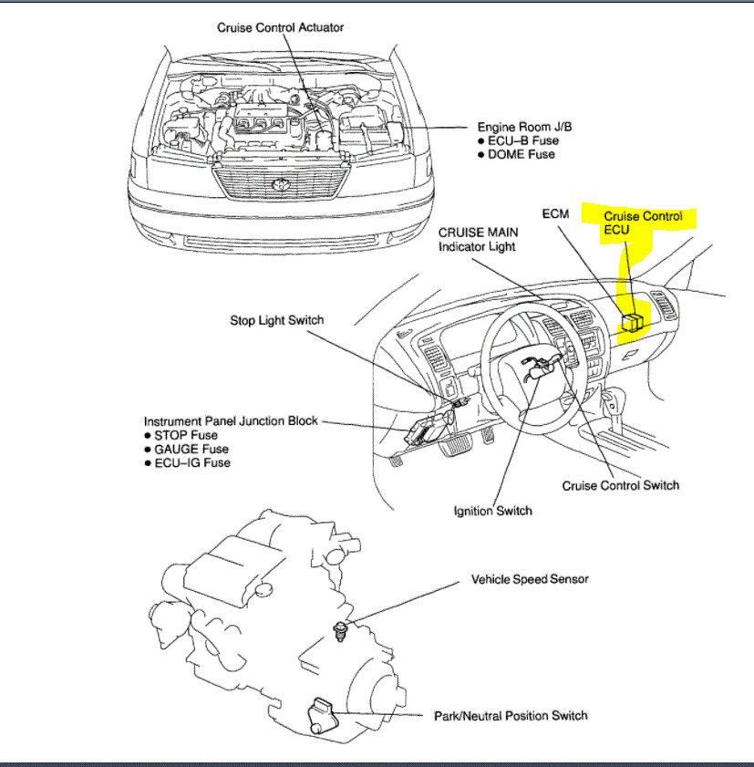

Why would the ECU have motor oil in it?
1999 TOYOTA AVALON
200,000 MILES • 3.0L • 6 CYL • 2WD • AUTOMATIC
KNK121009
ECU is leaking a lot of motor oil! Obviously, the ECU shouldn't have motor oil in it. where could it be coming from?

Are you referring to the ECU under the dash? See pic 1 below. If that is the case, there shouldn't be oil anywhere near that area. Are you certain it is oil?
Under the dash is the heater core which contains coolant, and the A/C evaporator which produces water from condensation. Could that be what you are seeing?
Let me know. Also, let me know if I have the correct part you are referring to.
See pic below.
