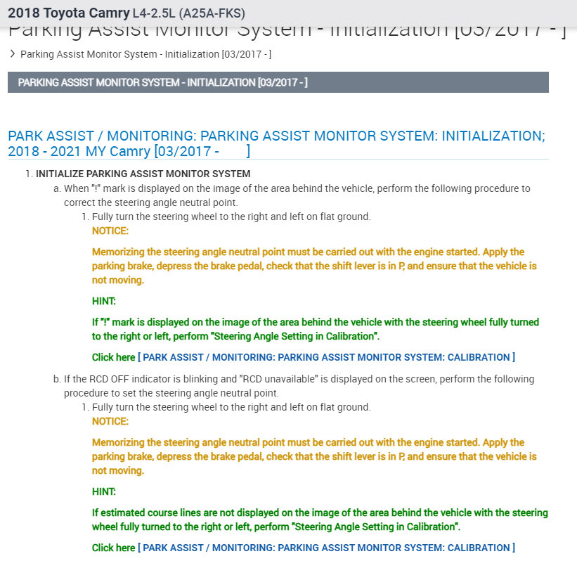

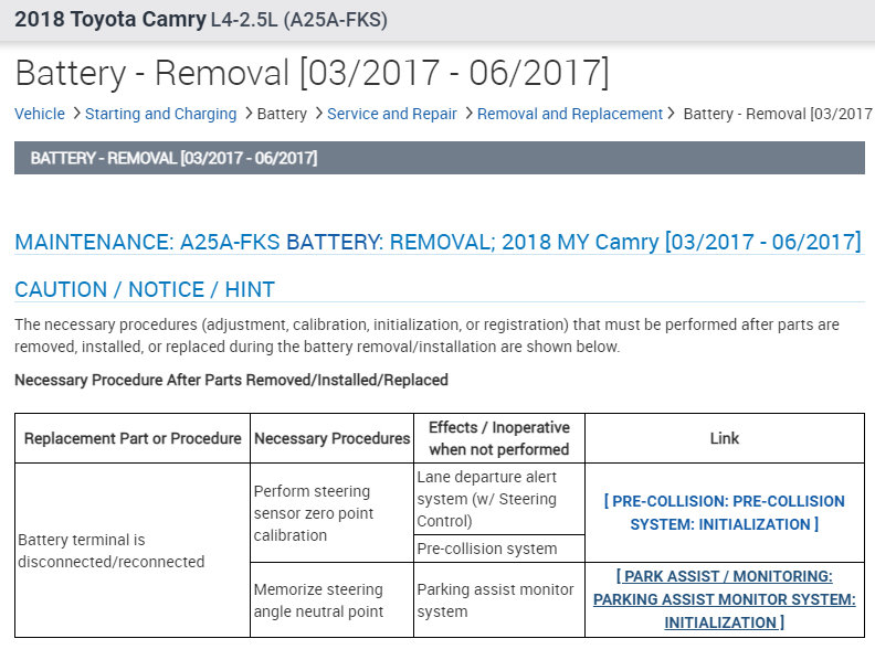

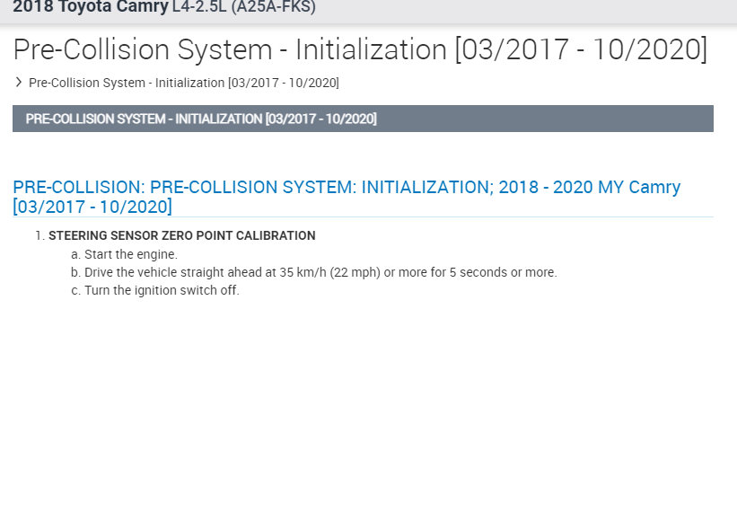

After the battery is replaced, there are two procedures need to be performed.
1.Perform steering sensor zero-point calibration
2.Memorize steering angle neutral point
I have attached the both of those procedures below.

According to Toyota those are the two relearns needs to be done after a battery change.
As for the codes, if any issues still exist it will get triggered again and you will be able to read them.

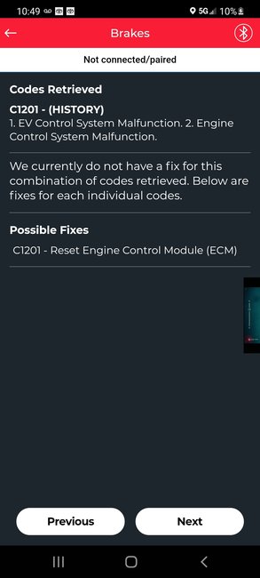

KOUBEAR
  • 43 POSTS

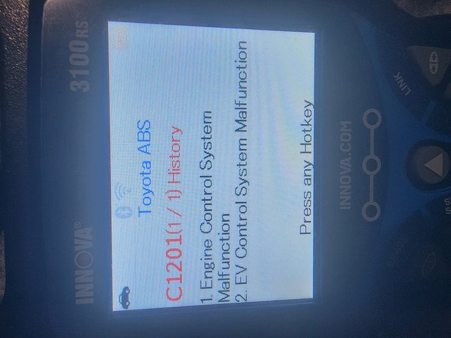

Ran my obd scanner and this is what I founded:
Oct 29, 2021 at 2:05 PM

SQM
  • 6,383 POSTS
So those are historical codes. Are you currently having any specific issues?
Inactive code can be stored in the computer but that will not impact the drivability.

KOUBEAR
  • 43 POSTS
I have no codes when I run my obd2 test, but I know it just doesn't feel the same I know there is an issue.

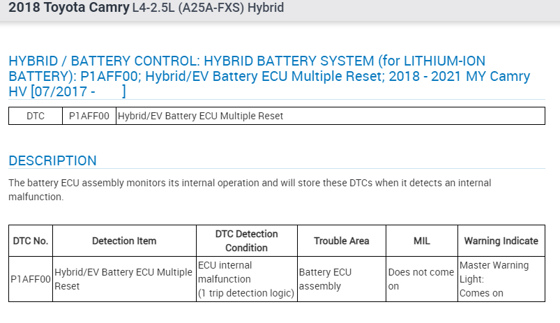

SQM
  • 6,383 POSTS

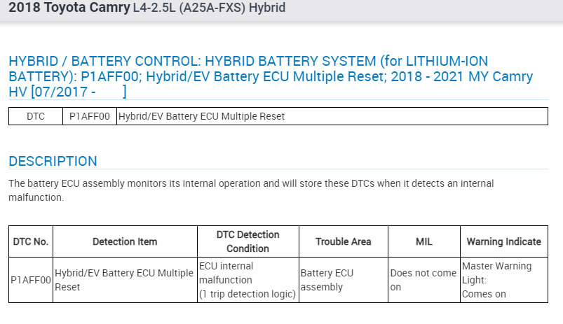

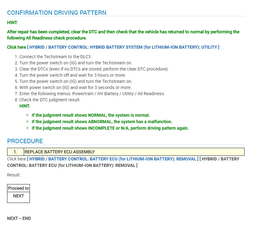

I have attached the reset procedure for the hybrid ECU below. Let me know if you are able to run through those steps.
Nov 2, 2021 at 5:58 PM
KOUBEAR
  • 43 POSTS
Hey, my car is not a hybrid? Will the same process still work? FYI my car is in the auto shop to fix my rear bumper damage.
Nov 5, 2021 at 4:44 PM
SQM
  • 6,383 POSTS
Well, the code showed to be for the Hybrid Camry. And that procedure is for the ECU of the Hybrid system.
