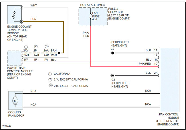

When taking the clip off temperature sensor it shattered to pieces I have no idea what wire goes where. I can't find a diagram anywhere on the internet. can you please help?
Apr 9, 2021 at 3:30 PM
  • 110,251 POSTS

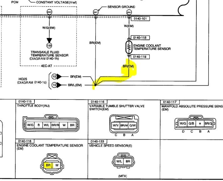

Both wires go to the powertrain control module (PCM). If you look at the pic below, it shows the sensor and wiring.
See pic below
Apr 9, 2021 at 3:43 PM
STEVE W.
  • 15,421 POSTS

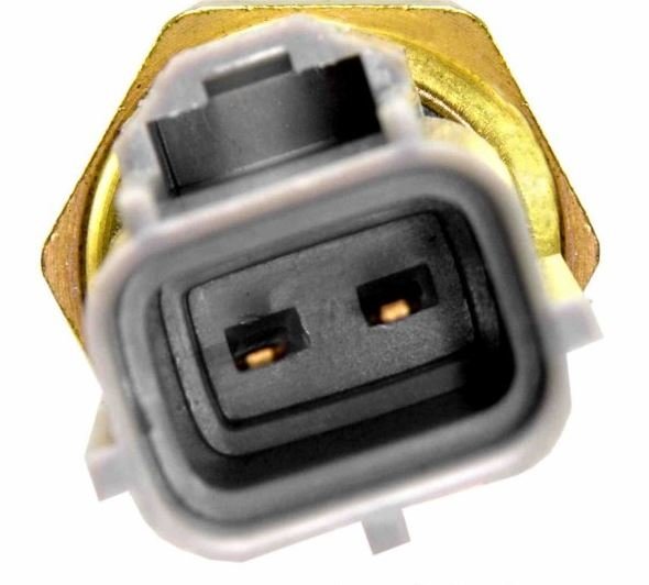

To add to the above, the brown wire is the ground to the sensor while the white wire is the signal to the PCM it measures the resistance in the circuit to determine coolant temperature. On the part that the connector plugs into the clip side up, the brown wire goes to the left pin white on the right pin.
